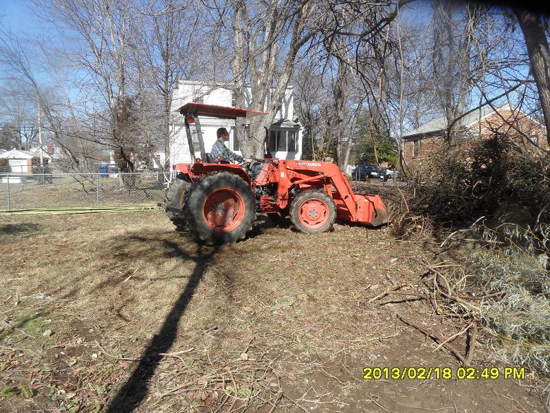

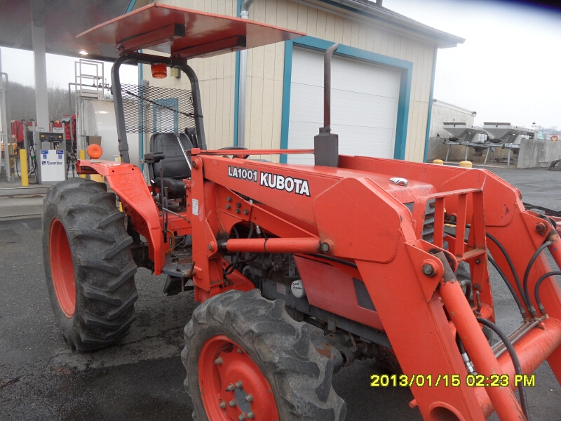

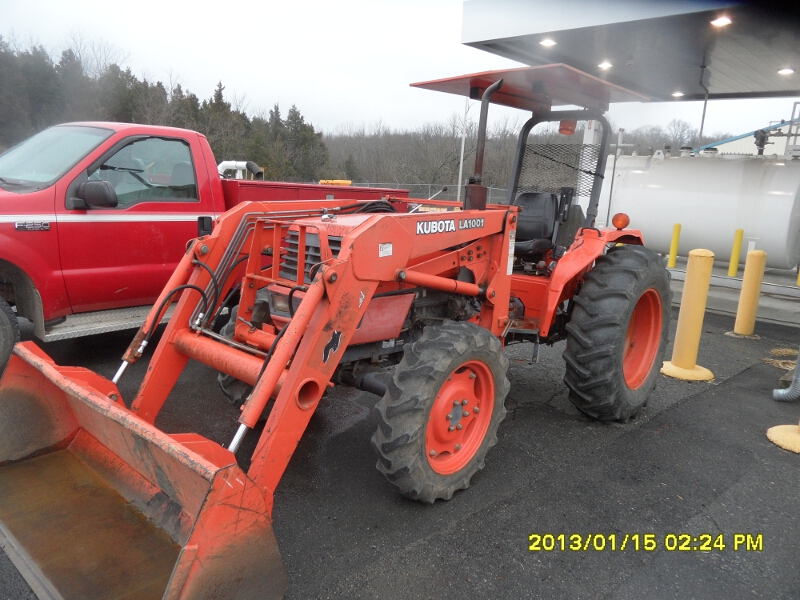

Since no one else has brought it up-
Look a public auctions.
First a little background -
Most "public entities" have funding cycles and must budget for equipment maintenance, new equipment etc. And they sell the equipment they replace.
Occasionally what they are selling is totally run into the ground, but often it is not.
In 2013 I bought an M4700 w/1400 hrs for $11.5K
Last year about the same thing came up again
Public Surplus: Auction #2152321
this time w 633 hours and sold for $12.7K.
These are good, well maintained but used 50 hp tractors.
If you have maintained cars for years the repairs I've had to do would seem simple - mostly replace a few hydraulic hoses and get a FEL cylinder rebuilt.
These bargains pop up all the time. In the DC area I've tracked about 50 since 2015.
It's worth looking into.
