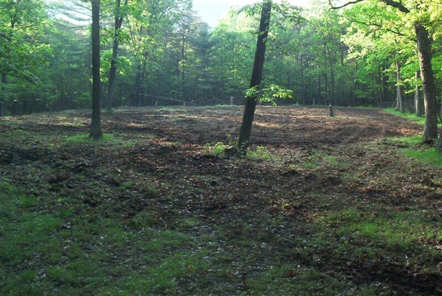

Definitely add weight, I have a 5' KK type model with the serrated edges and by it self, does nothing to the ground, and barely does anything after the soil has been plowed. I added a good size rock to the back chained her down, and it was night and day difference. Almost made me feel like I knew what I was doing. /forums/images/graemlins/smile.gif Still I had to make several passes, but it worked. Attached is a pic I disc'd this past weekend, and no plow was used before. Granted this a food plot for deer and not designed for ag purposes.

   / Used vs. New disc harrow? Smooth or Serated disc? #23
