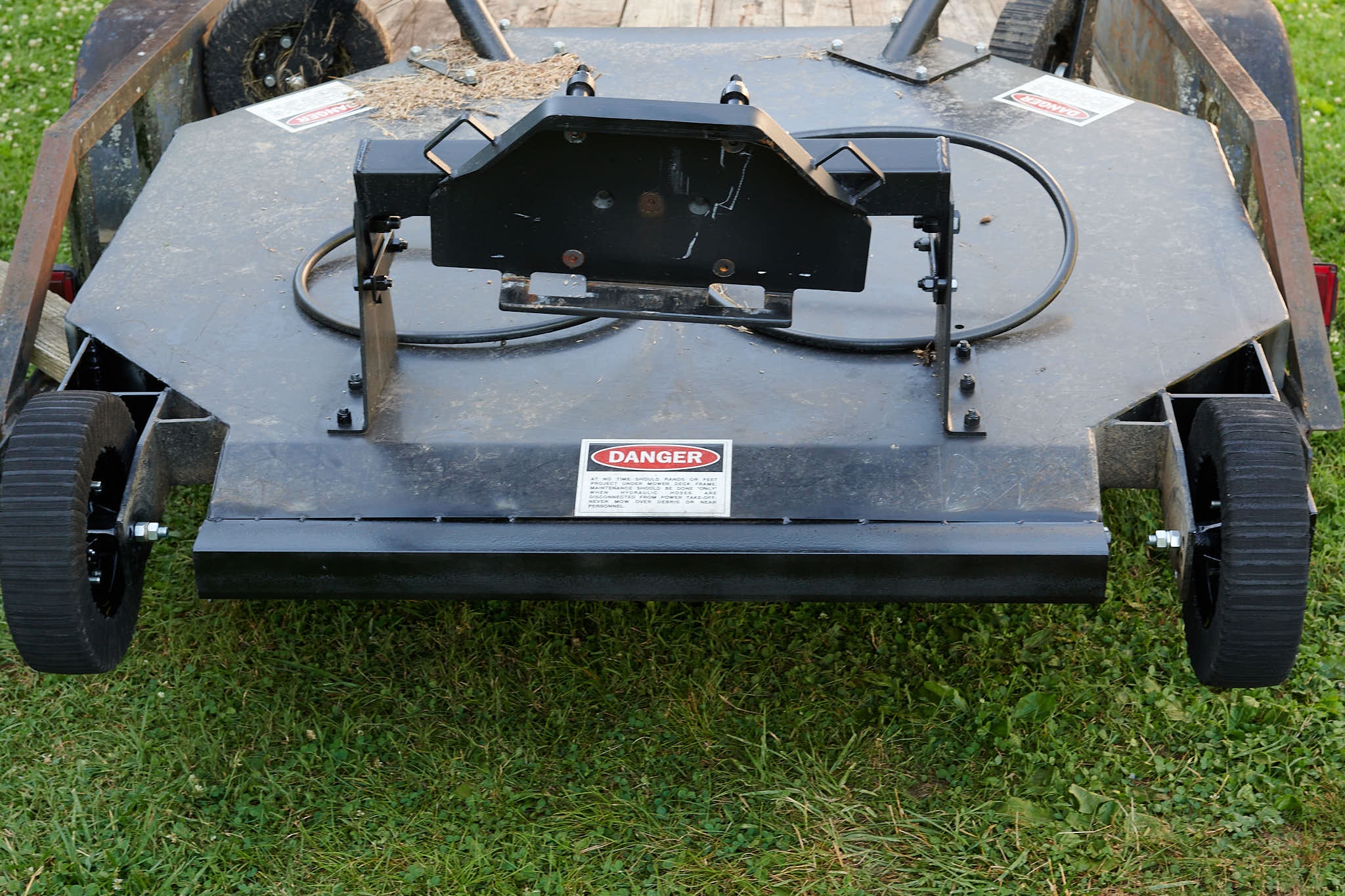

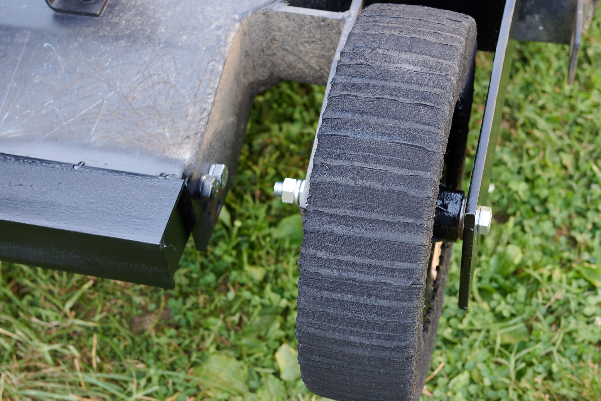

Current status is I installed the 15" laminated wheels after using a wire wheel brush to knock off the paint on the 1 1/4" yoke.
Next, fabricated new wheel mounts at the rear wide enough to mount 15" laminated wheels. Thought I could use 3/4 axle. Wrong. Not enough metal in the OEM 5/8 to bore out comfortably so I bought hubs with a 5/8 bore.
While I had the mower off the PT, decided to fabricate a debris guard. I meant to use chain, but wasn't comfortable with measuring the clearances needed to make sure the chain could never impact the cutting blade in any position. With the blade being so close to the deck anyway, I made a temporary guard just to see if it made any difference and how it might affect cutting performance.
