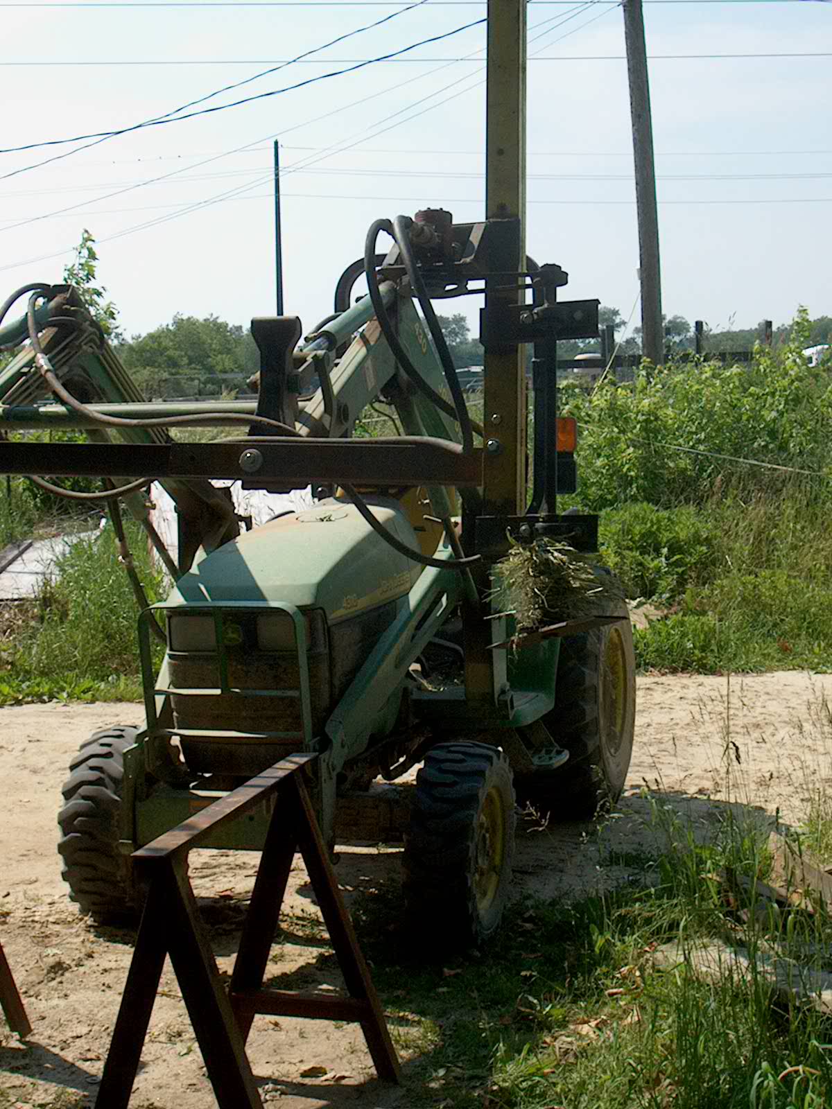

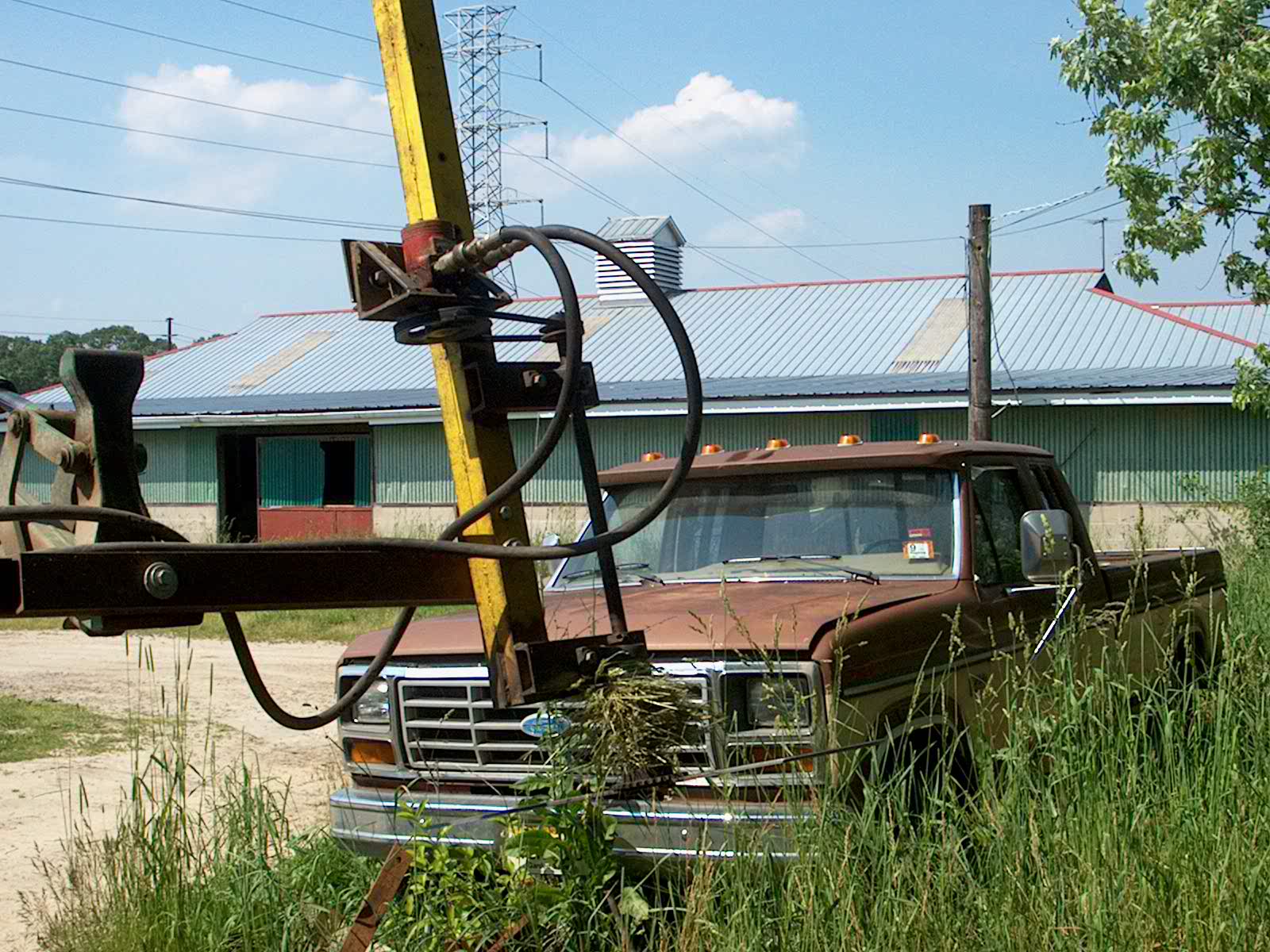

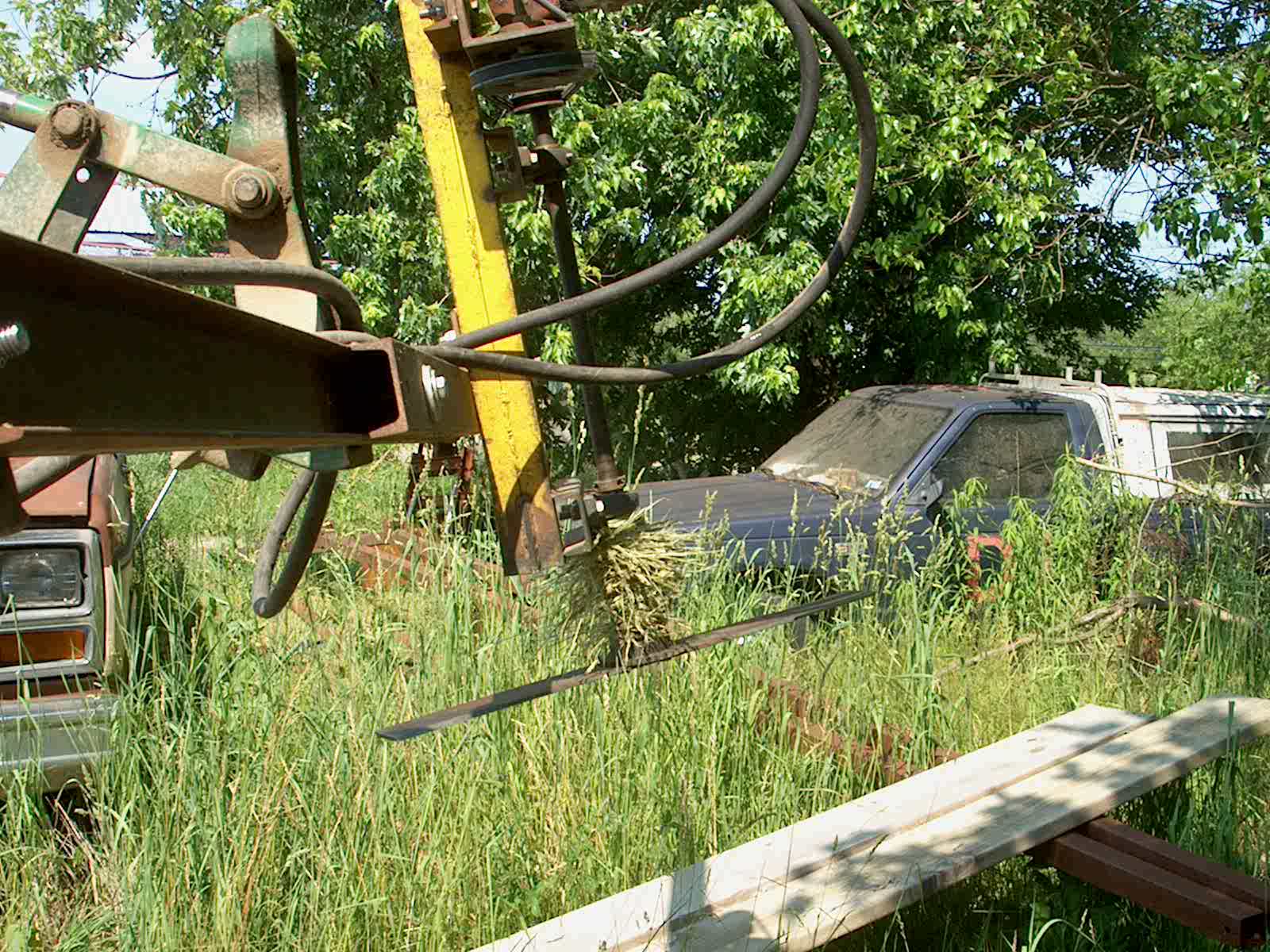

can be mounted to cut horizontaly or vertically

how fast, dont really know but it works
and ive been whacked many times its not as hard as it looks like it would be
i wear safty glasses and a hat and it cuts in both directions so i use a rotation that flings most away from me
actually i find the ticks and heat more annoying
if needed i could add a wire shield in front of me

ive cut up to 2"-3" branches and saplings with it by just easing into them

so far i only use it out back on my horse track to trim back vegitation and trees when no one is around
if i was to use it otherwise i'd shield it, it would be easy to do
with safty glasses and hat there is little danger to the operator as the cutter is some distance away
iv used it 3 times for about 2 days each time with no ill affect
its one of those things that looks more dangerous than it is
i was a tool and die maker for 30 years and in a shop some of the machines that look the most dangerous are in fact the safest, sorta like with this
the way i use it its harmless to me, other aplications maybe would be different and i would use it acordingly
iv never gotten so much as a bruise
anything that has hit me is more a thud than anything else, a screen could be mounted to the fel uprights if needed

branches sorta just drop down, to big to fly
ive cut through branches up to 2' - 3" , takes careful moving but branches are les hazardous than the smaller stuff
unless youve seen the way i use it , it does look dangerous and under other circumstances might be
im no more willing to hurt myself than the next guy
it may spin maybe 2000 - 3000 rpm , not sure and its far enough away that momentum is lost by the time anything reaches me

the blade is a comercial cutter blade about a 1/4" by 3" by 24" turning at about 20% its rated speed
when i run into heavy cutting the v belt slips long before enough torque is put on it to break
also it hangs over the fel by about 2 feet so the plane of spin is about 4 feet from me
and up in the air where it cuts theres nothing to break it
and when i flip it to cut horizontaly, id be more worried about the front tire as im sitting well above its plane of spin and have the fel arm and tractor as a shield
you really need to see how its applied to understand
im more likely to be injured driving than useing this the way i do

those look like saw blades, im using a comercial grass blade that spins upwards of 15,000 plus rpm im going a fraction of that and the vbelt will slip and it will stop spinning long before i reach any limit it may have
i have quite a safty factor the way i use it
i wear glasses and a hat
ive been hit many times and mostly its anoying
many times when operating a machine tool id have to stand there getting burned by hot chips because i had to, so i could stop a cut, sometimes you gotta do what has to be done
come on if you drive a tractor, your supposed to be macho, dumb and tough
