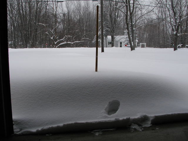

see my post under this forum B2400 WORK HORSE. will give u an idea of what u can move with a fel and rear blade. although did not use rear blade today to damm much snow/w3tcompact/icons/eyes.gif

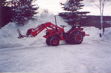

yet another one, this is a clever design. This is from a guy on the kubota owners group at yahoo groups.
If you click on this link and then click on heavy equipment, you can scroll until you see this really nice picture of the b21 with the snow plow. Much nice quality than the other pic. I gave. http://photos.yahoo.com/bc/bswallow25/lst?.dir=/&.view=t&.src=ph&.done=
Let me know if that doesn't work.

BLAKE: i just don't want to give up the fel, to many times i want to actually move snow from one place to another, too much snow at time at the edge of driveway, can't see when pulling out, so when it gets like that i need to pick it up and dump it elsewhere.
