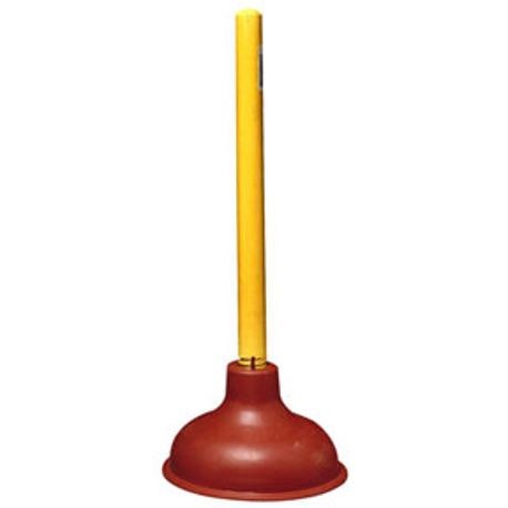

   / Using a metal snake on ABS plastic drain pipe? #13
Also, there's toilet plungers and sink plungers. Use a sink plunger. Toilet plungers look like this...

I've never heard of a sink plunger ... just a toilet plunger?
