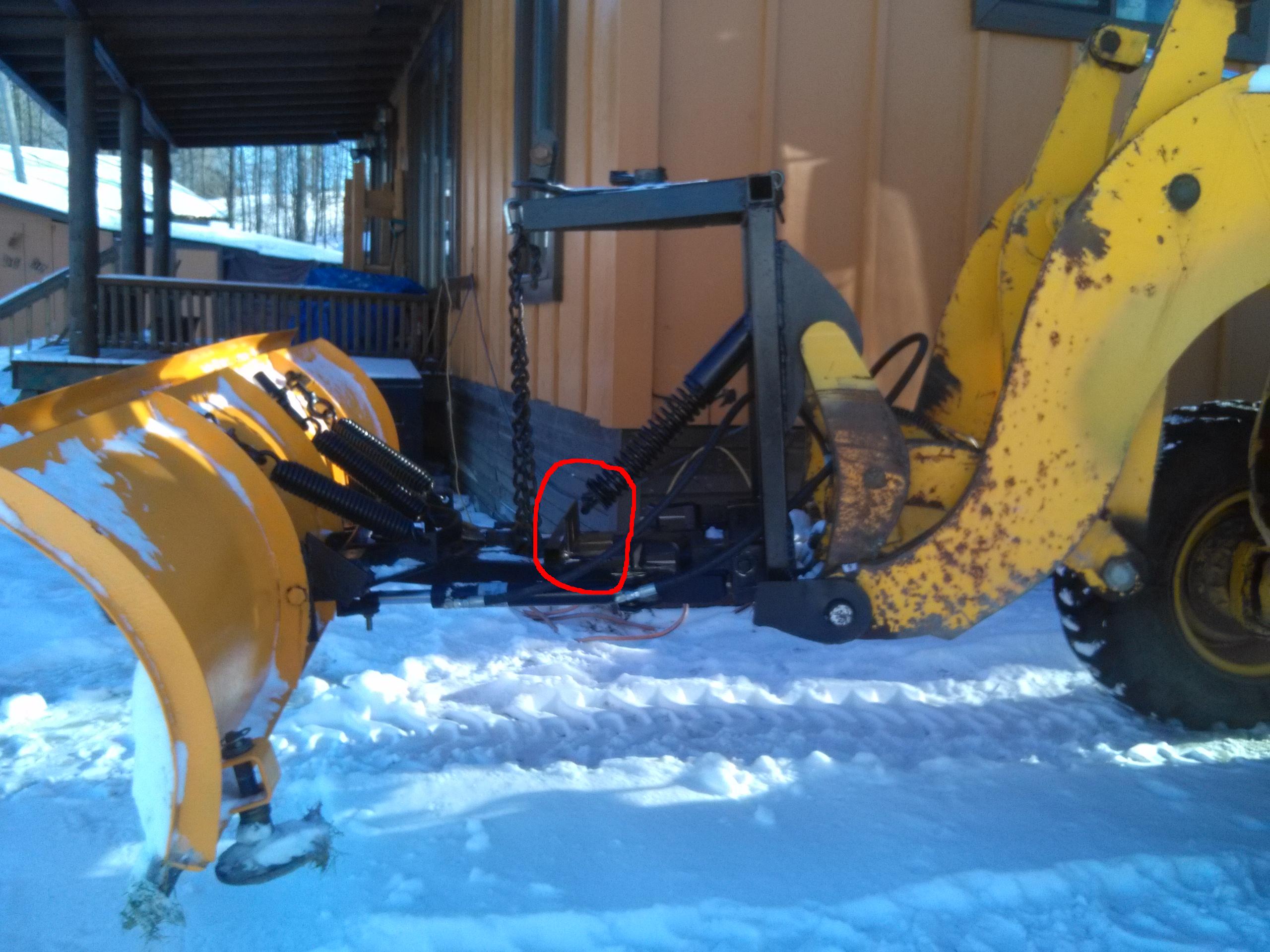

Here's mine with a chain supported plow, if you look in the circle, when I angle the plow "down", the cross pin connects with the plate and the spring puts tension on the plow for down pressure.
   / Using a pickup snow blade for my Mahindra #18
Very cool!!!! Did you design that??
