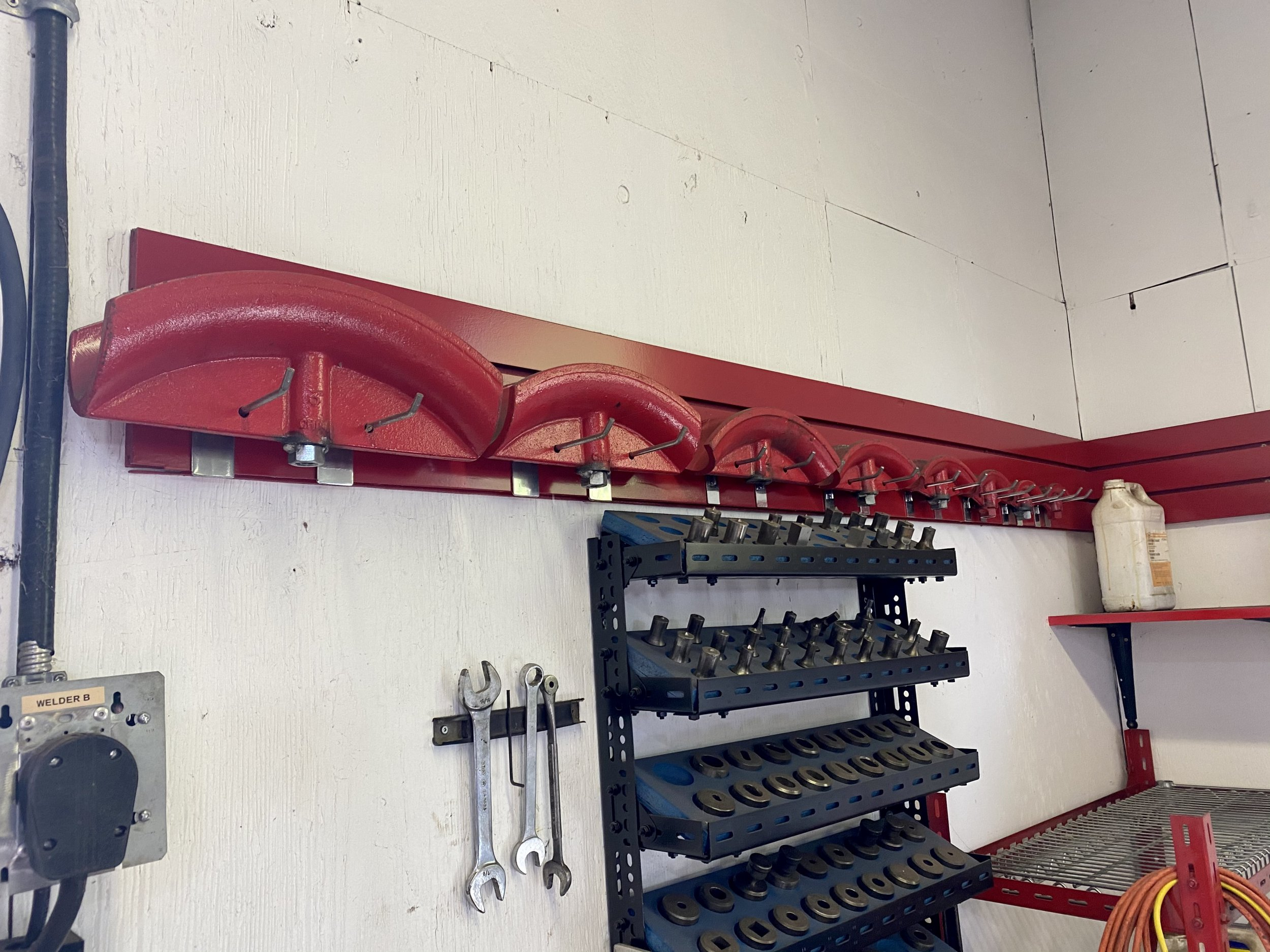

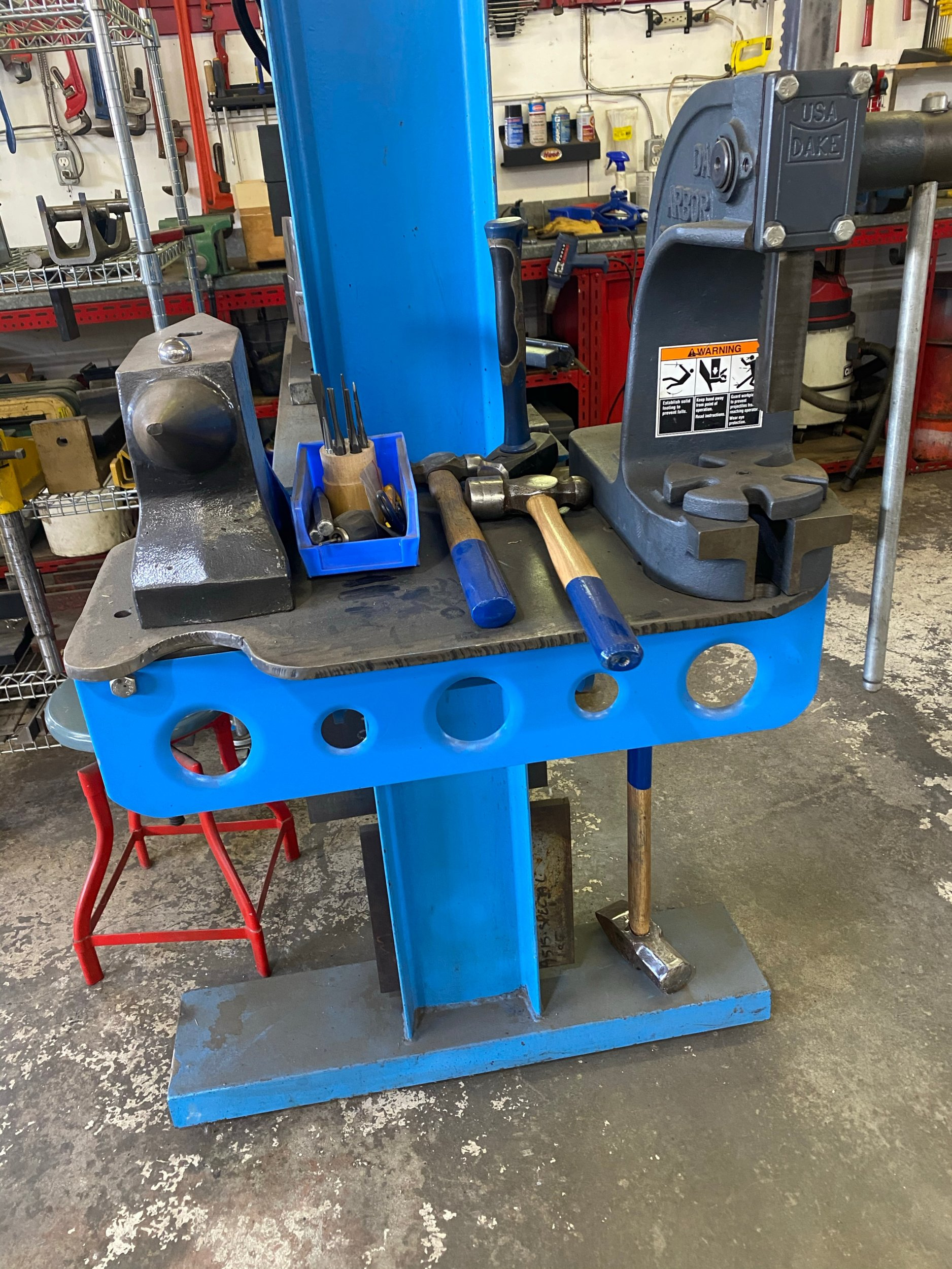

Dimple Dies

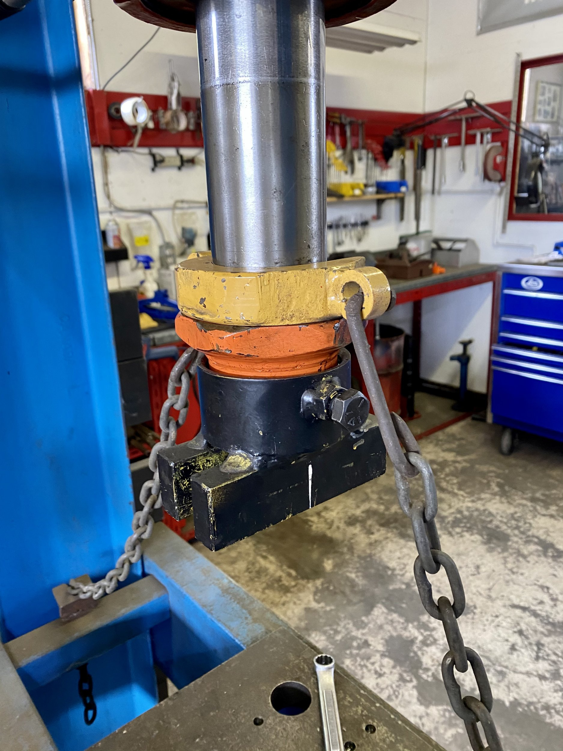

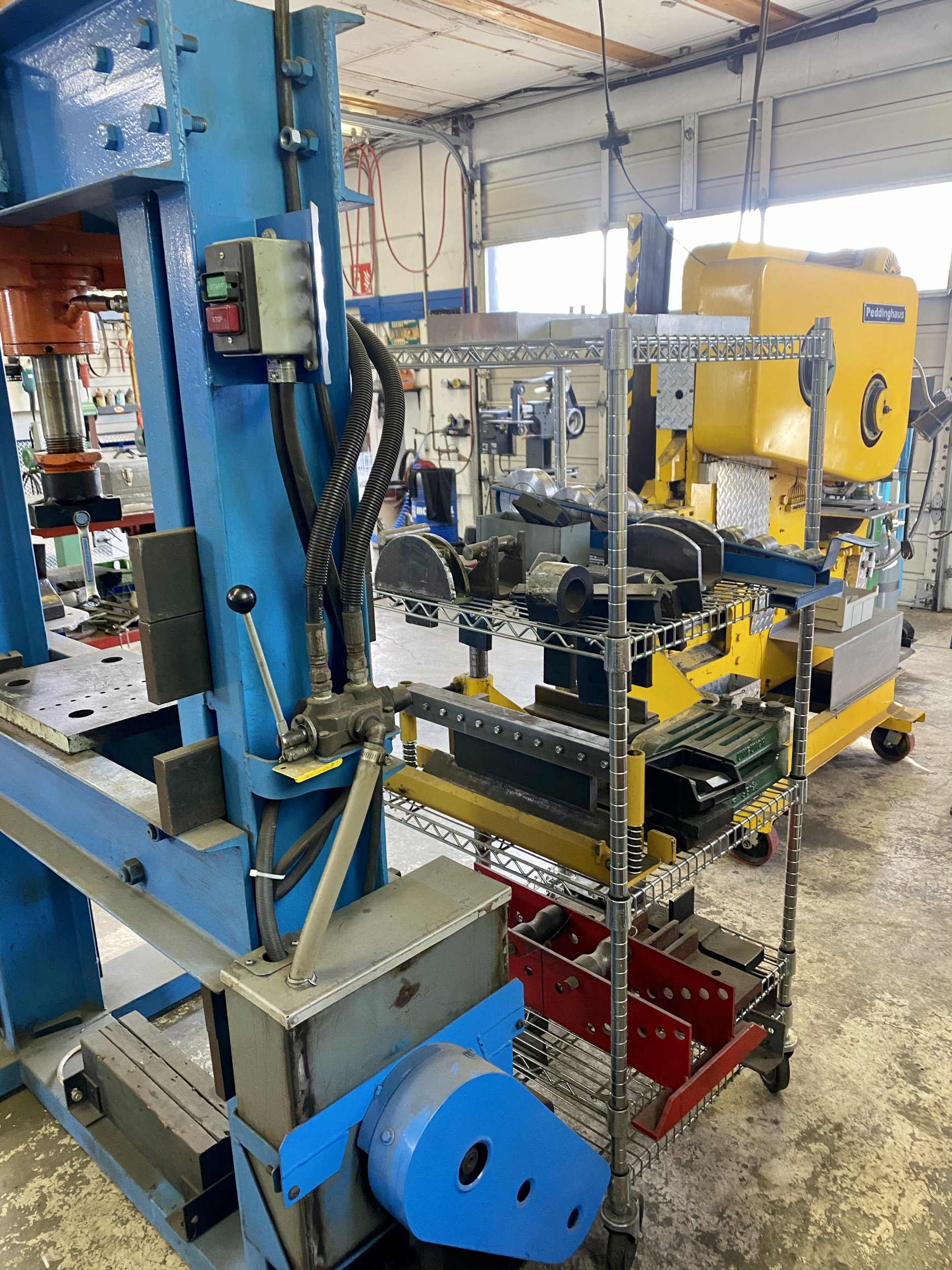

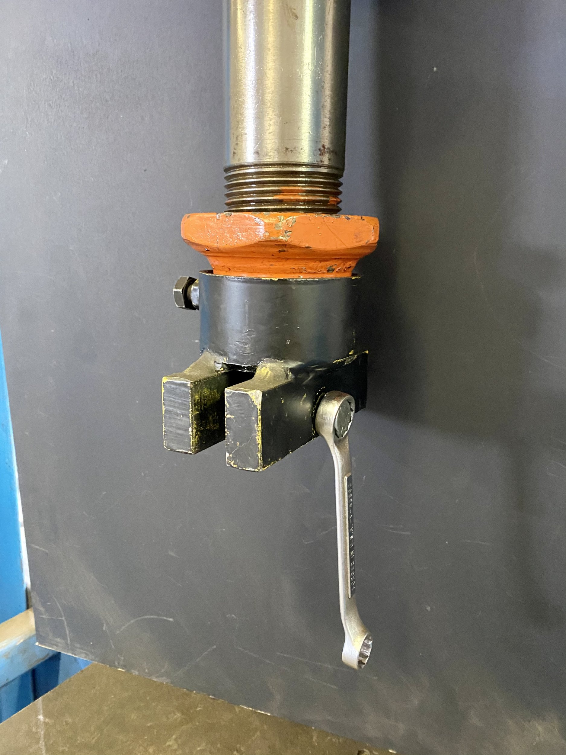

The ram's receiver.

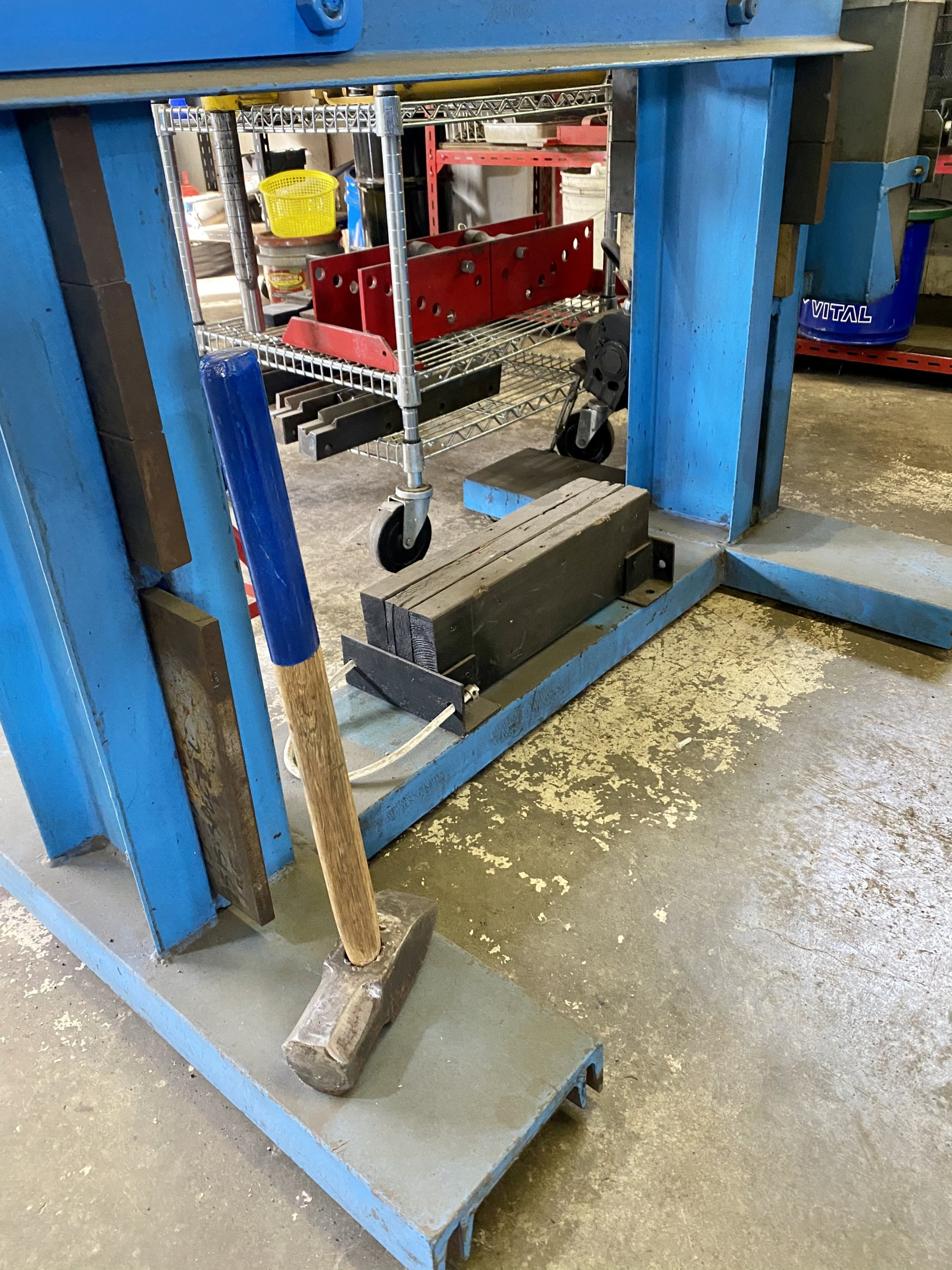

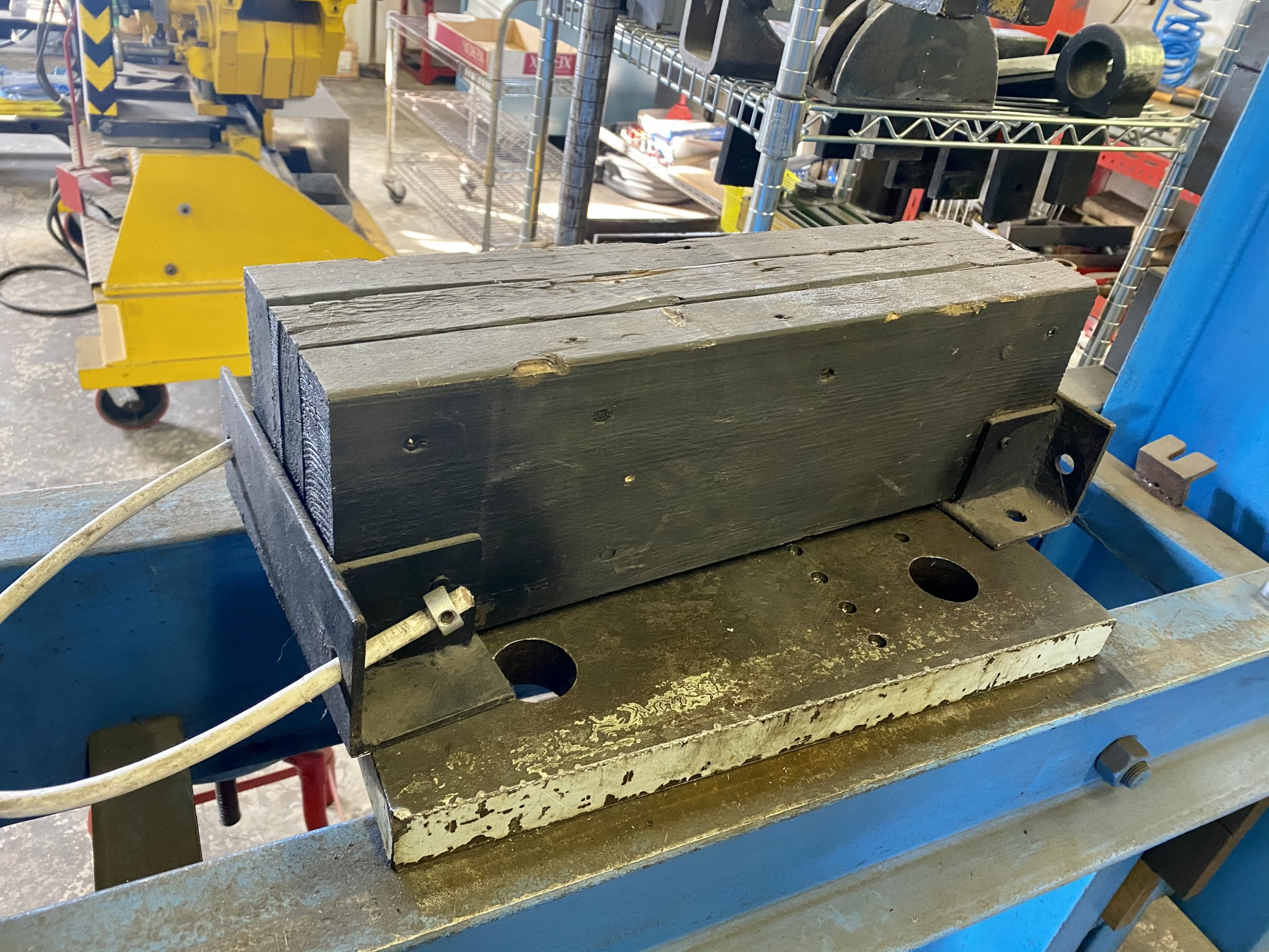

A laminated wood block I keep handy.
Use your imagination as to its uses. I'm certain you will have plenty.

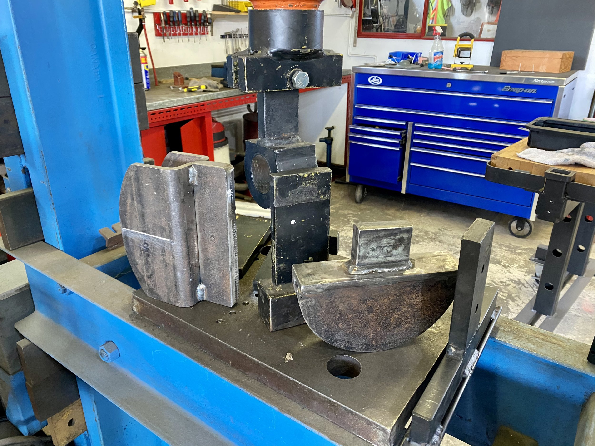

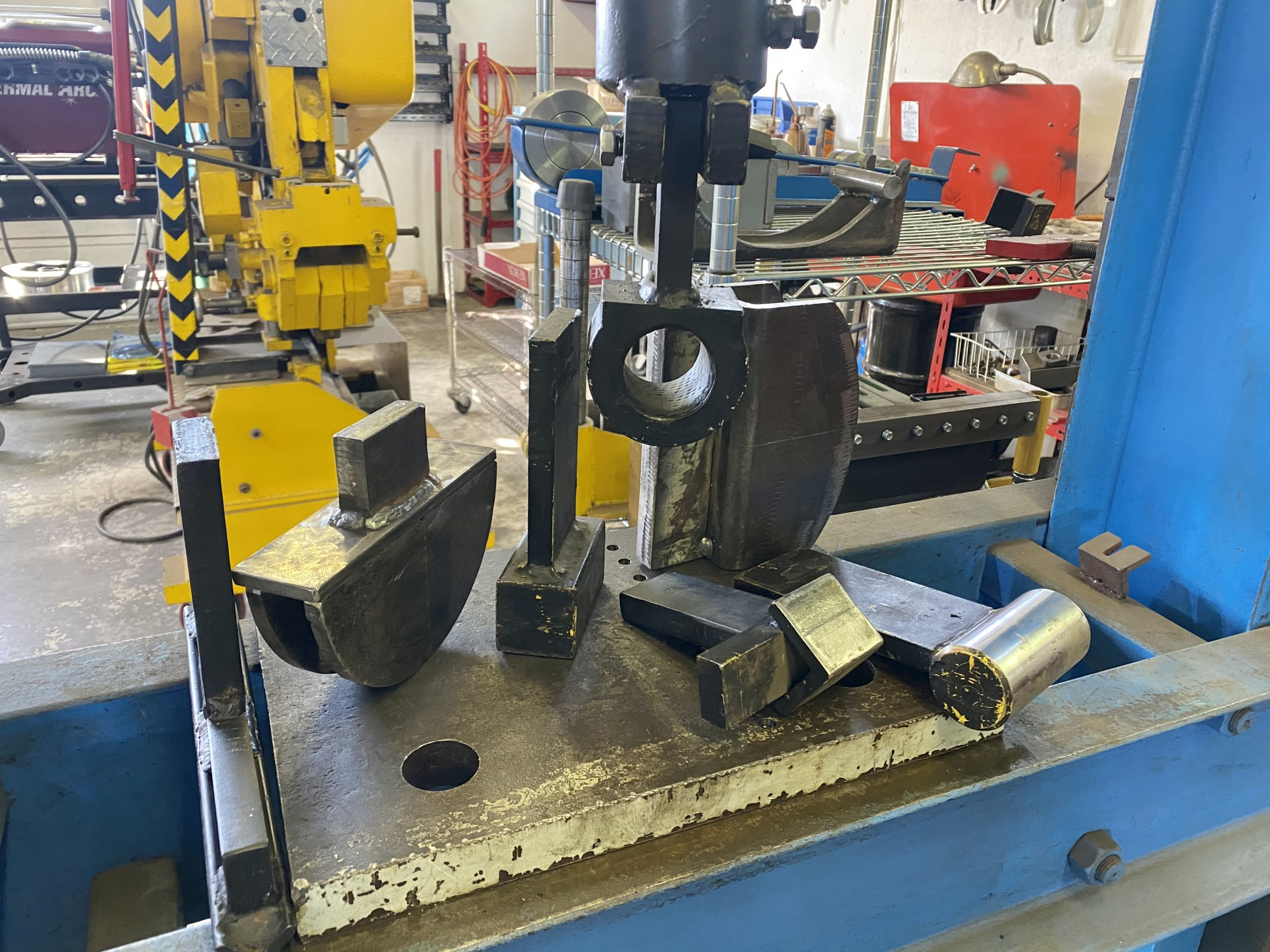

Some dies. All shop made as needed.
Pipe dies from a store bought (Harbor Freight type) hydraulic bending kit modified to fit Big Barn receiver.

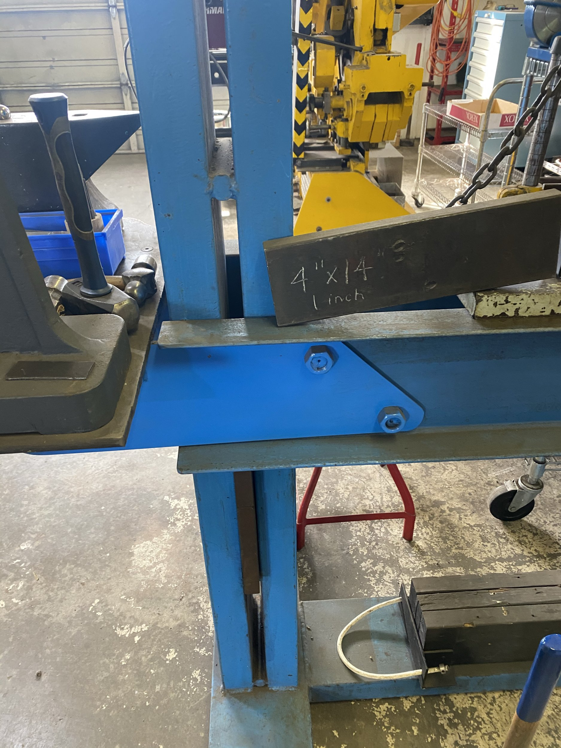

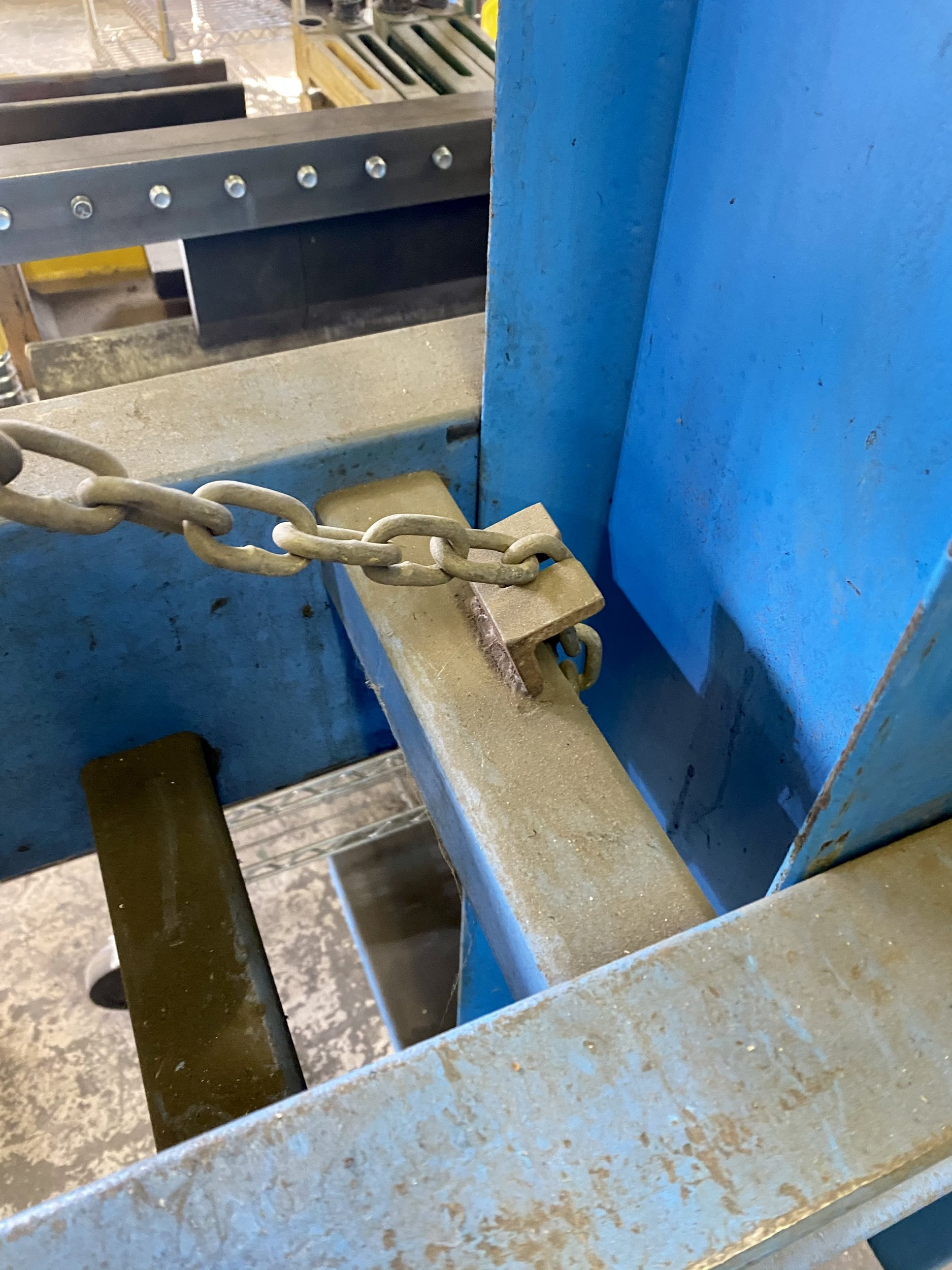

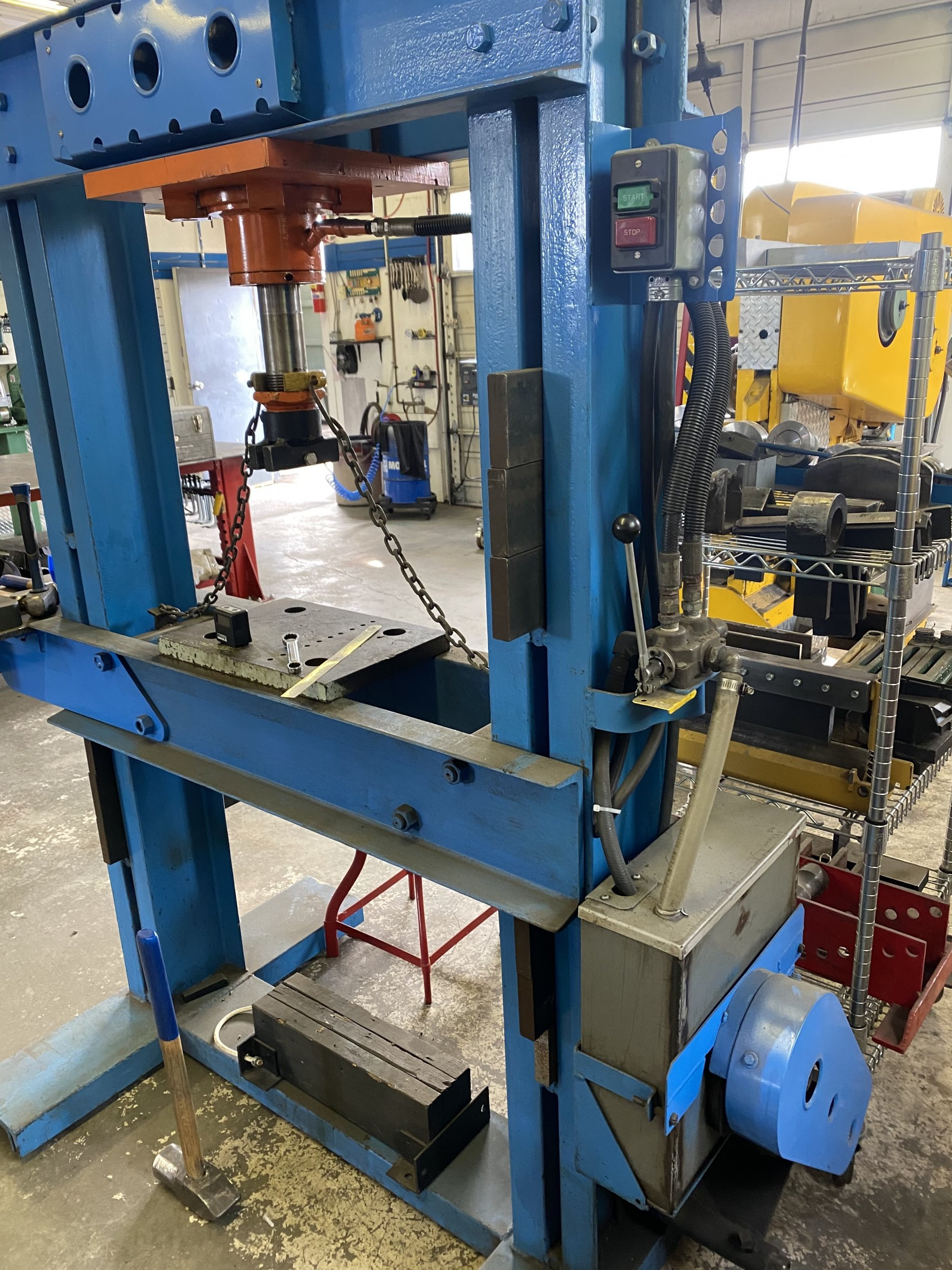

Lift assembly for bed height adjustment...

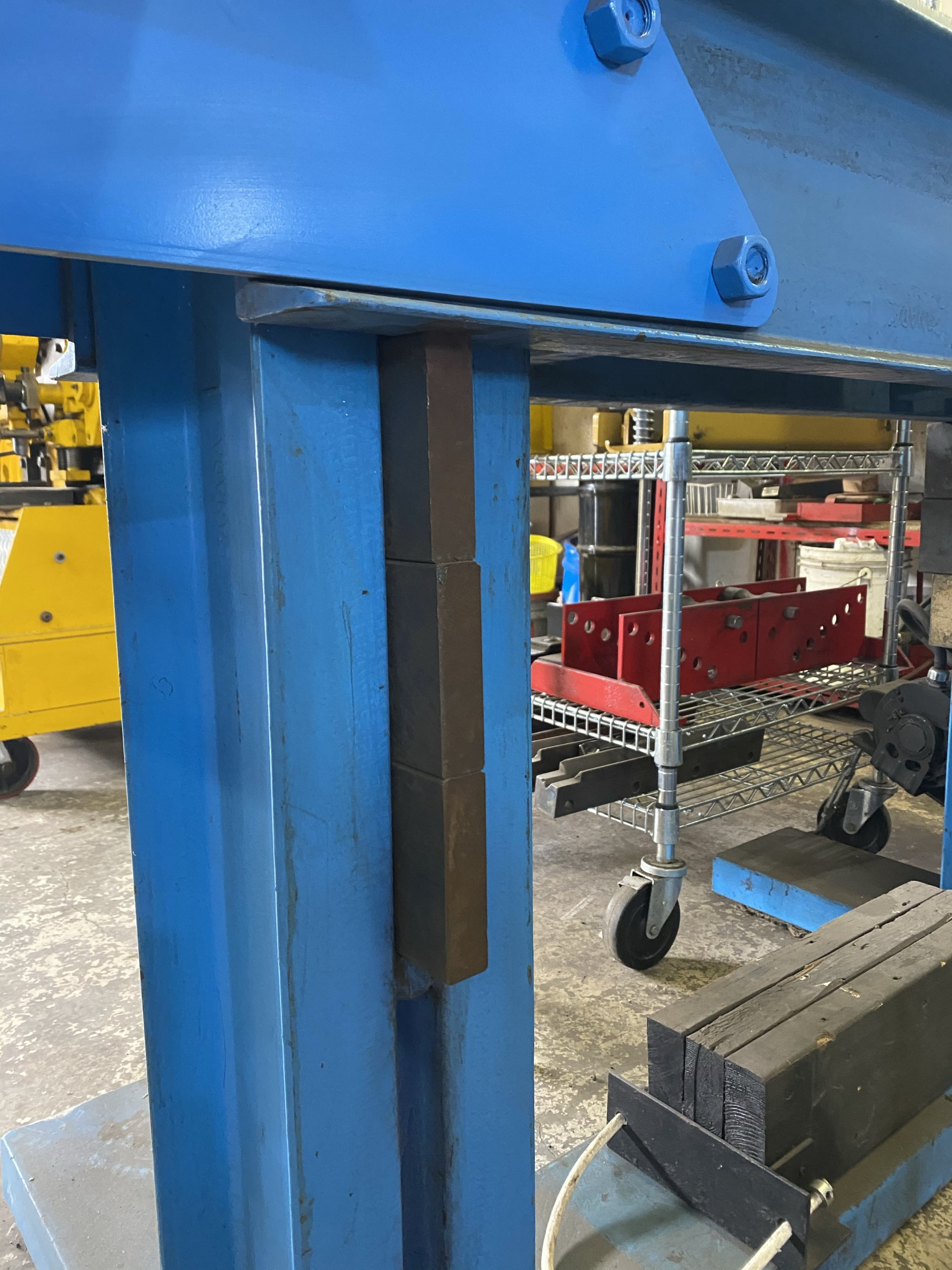

   / Using a shop press - tips & tricks #18

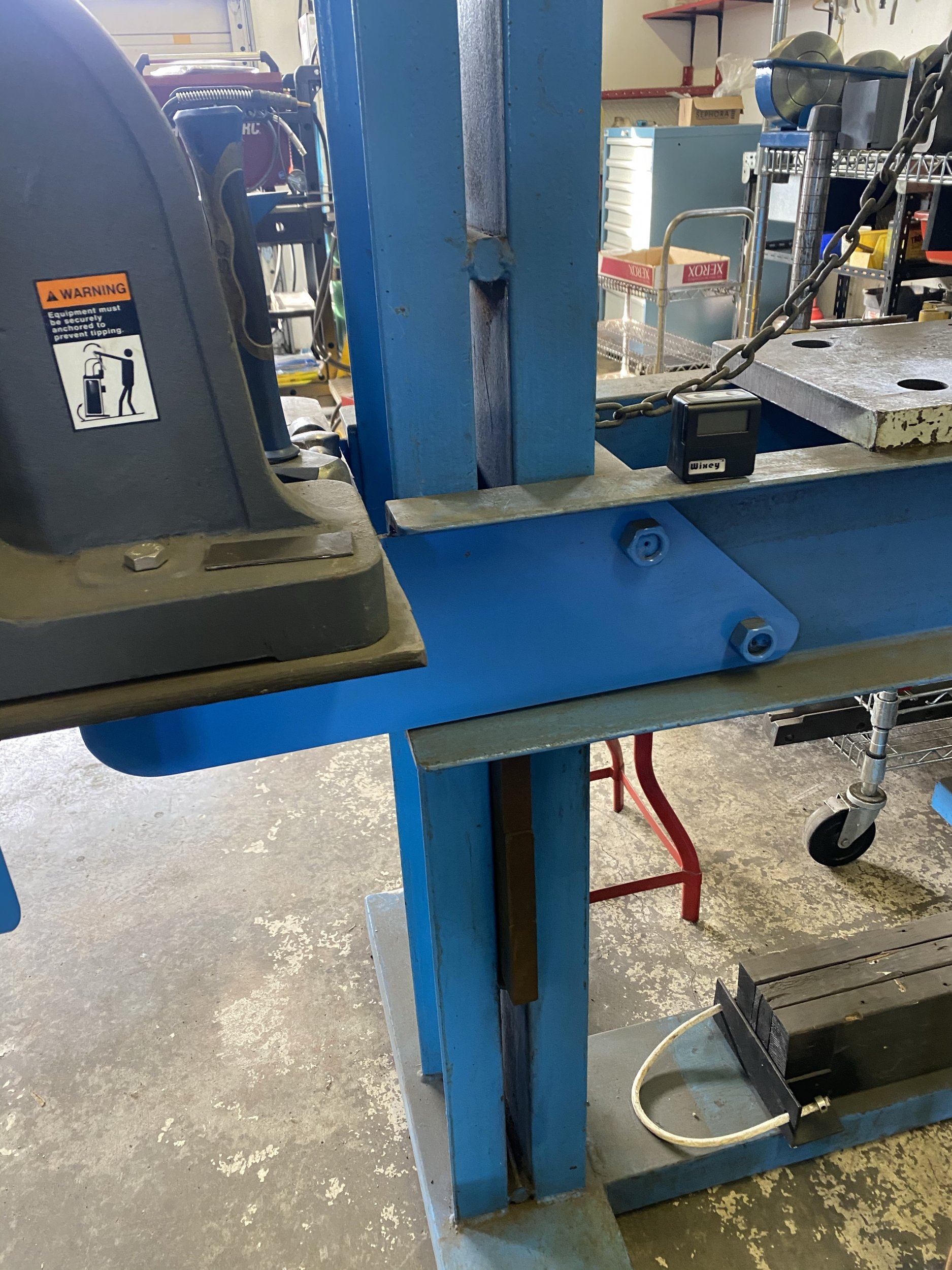

No bolts used for height adjustment.
4 inch increments achieved utilizing 1x4x14" flat bar.
