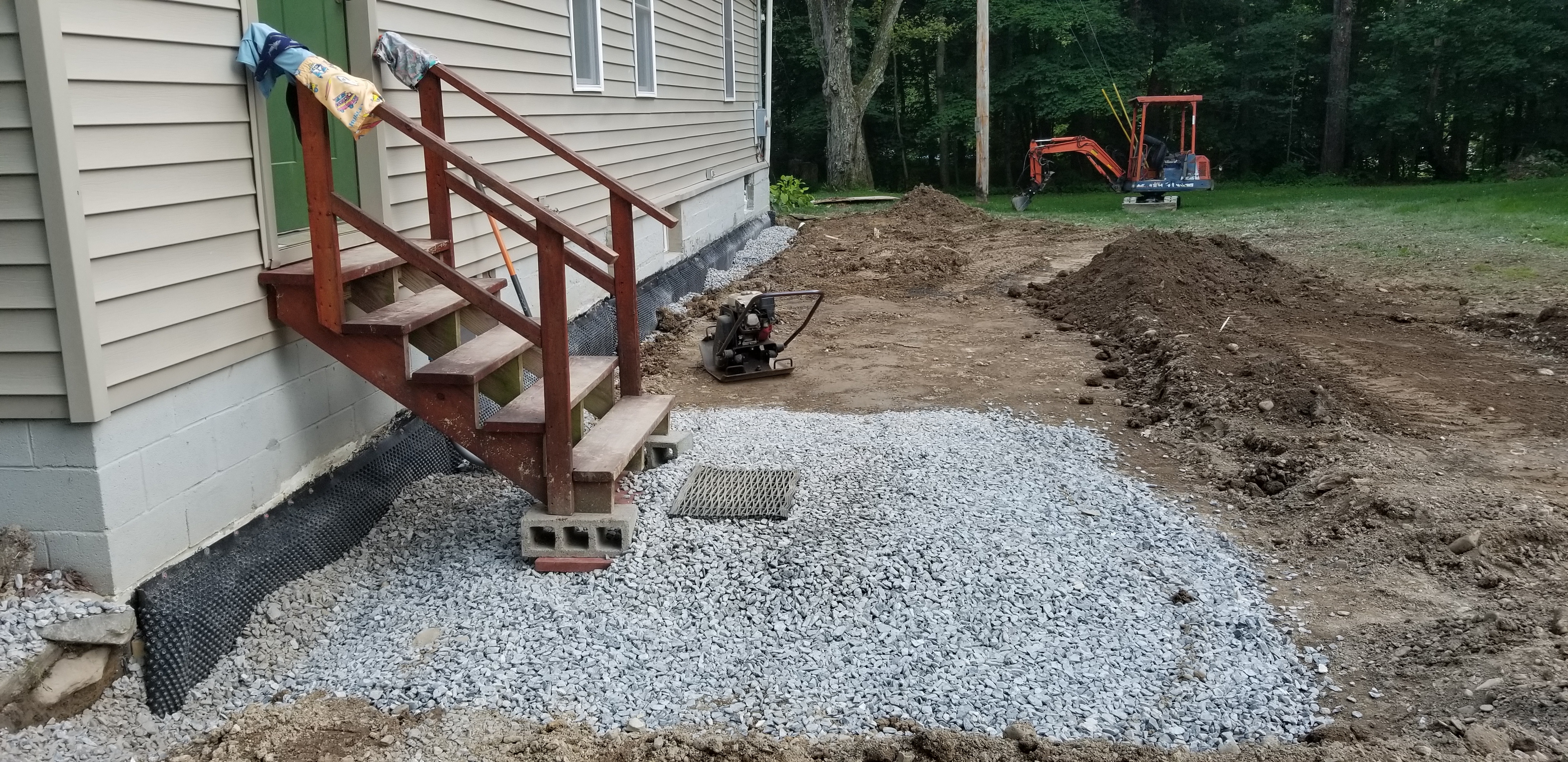

I have a kubota kh-41 (1990s era) 19hp machine. A month ago I got a 31in tilt grading bucket. The tilt lock ability of my machine isnt great. However the ability to scoop and move 31in of material is wonderfull. I have really hard rocky clay and it will fill the bucket in two scoops.
These smooth buckets work really good for doing patios too.
