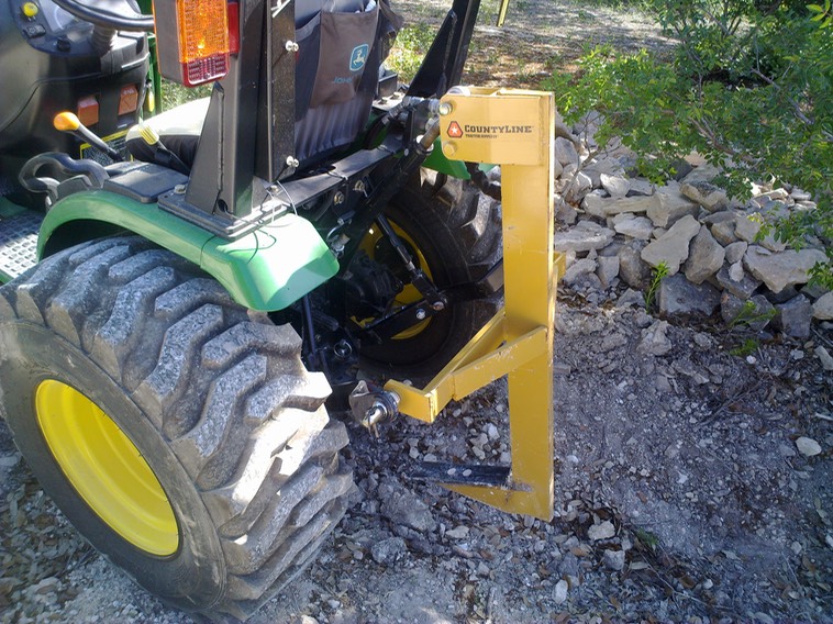

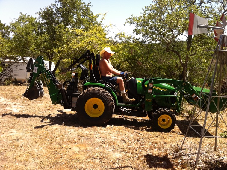

Steep, rough, off camber I got it in spades down here in the Texas Hill Country. I bought a JD 2520 abd while its a compact tractor its still a tractor with its HIGH center of gravity and I have 1 & 2 wheels off the ground so many times I cannot count, albeit I have never laid it over, but certainly been close. The tools I use most are my FEL, Backhoe and sub soiler which I use to clean out ditches and create ditches andtrailer hitch. Yesterday I pulled 3 different size trailers from 6 ft to 18 ft.
Ideally the setup would be a lower center of gravity, wide track front and rear and enough weight and HP to get the job done. I am not a farmer, have no row crops, I just work the land by clean, clearing, managing water runoff, moving rocks and tree debris. Hill Country has GOT rocks. On my place I have generally about 6 in of top soil and below that it's limestone and its limestone down a long long ways. My well is 728 ft and I know folks that get water below a 1000 ft. The ONLY flat ground on my place is where I have made it flat, otherwise none!
