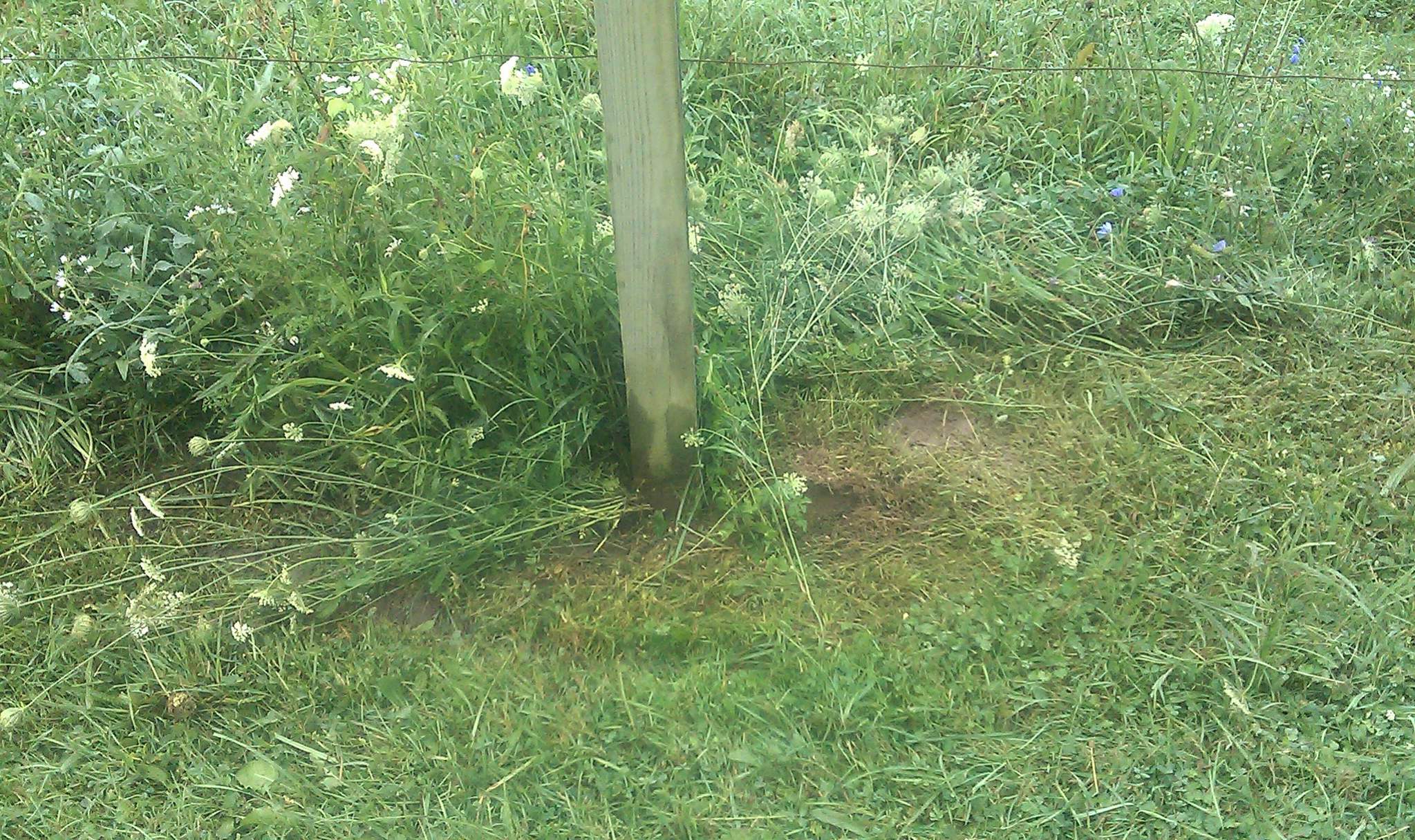

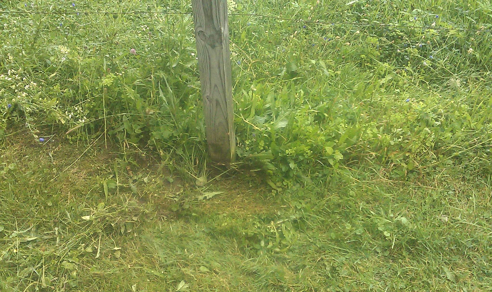

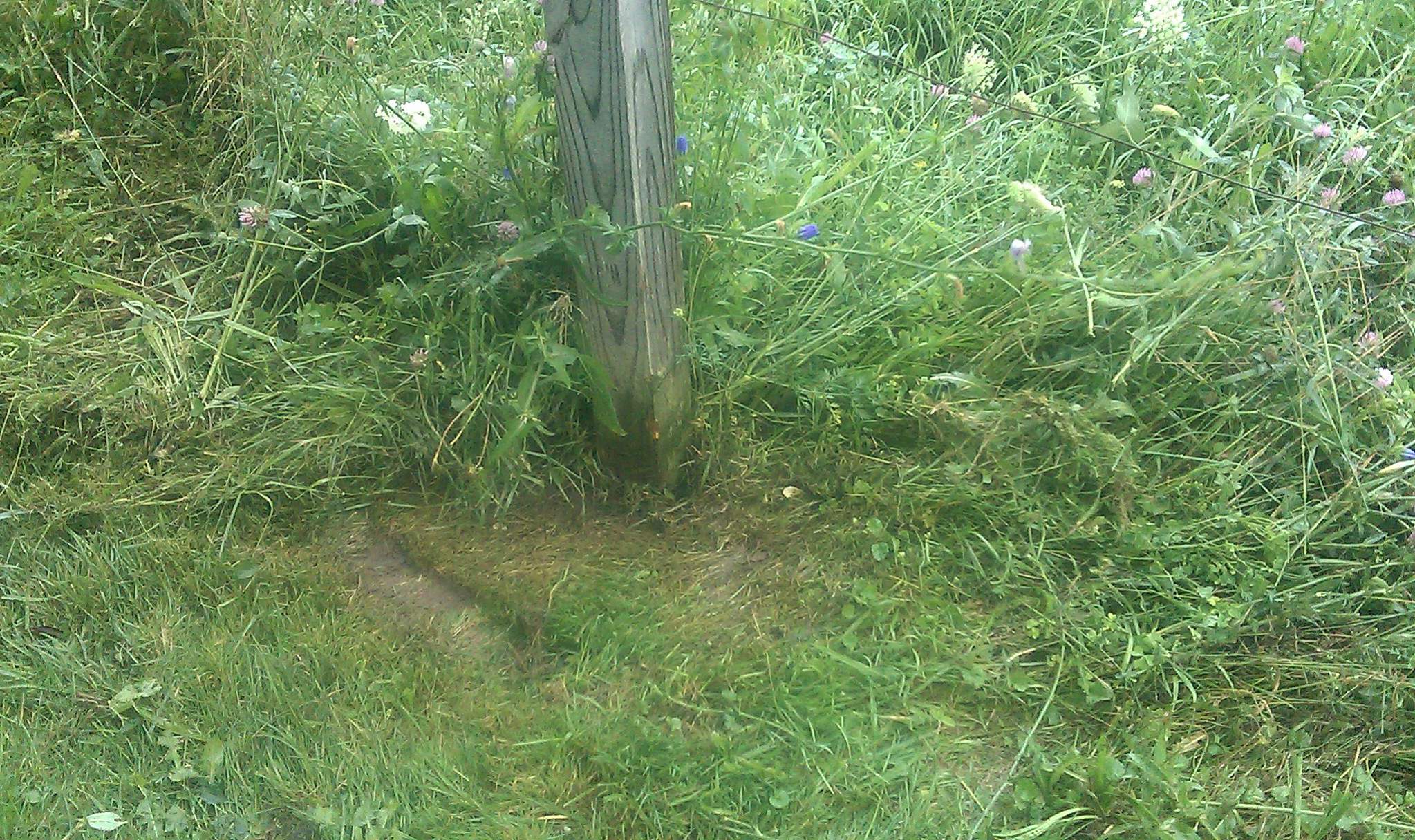

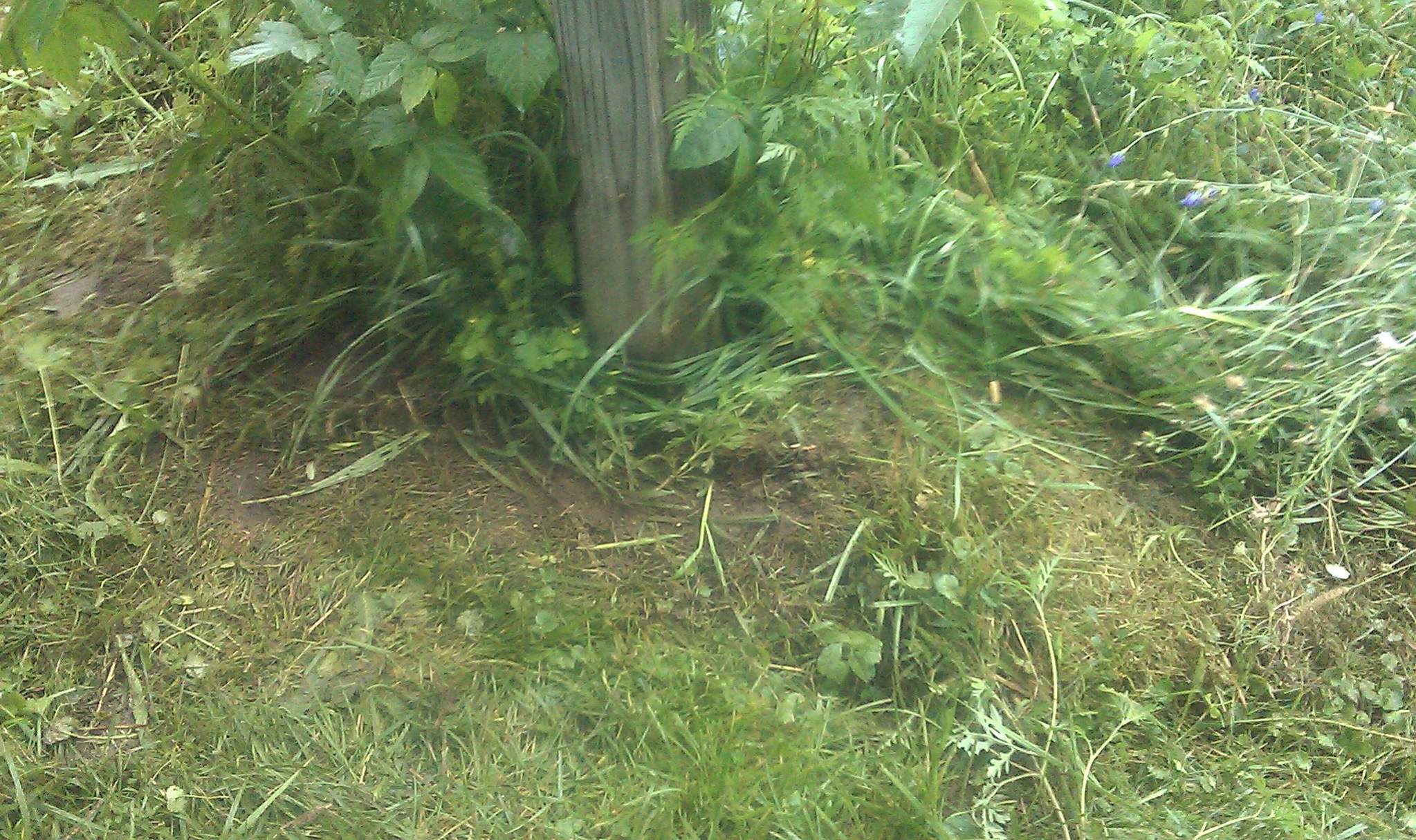

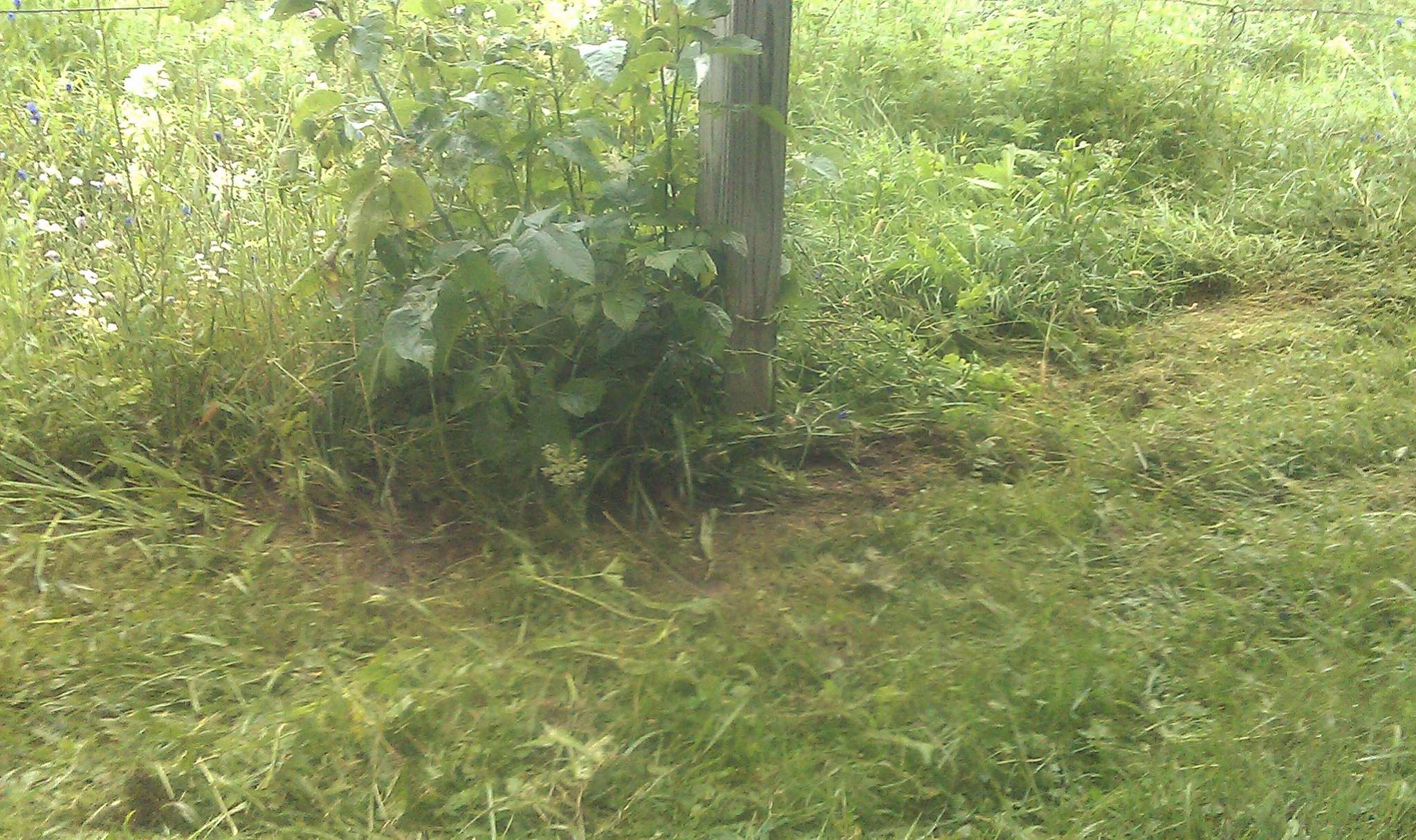

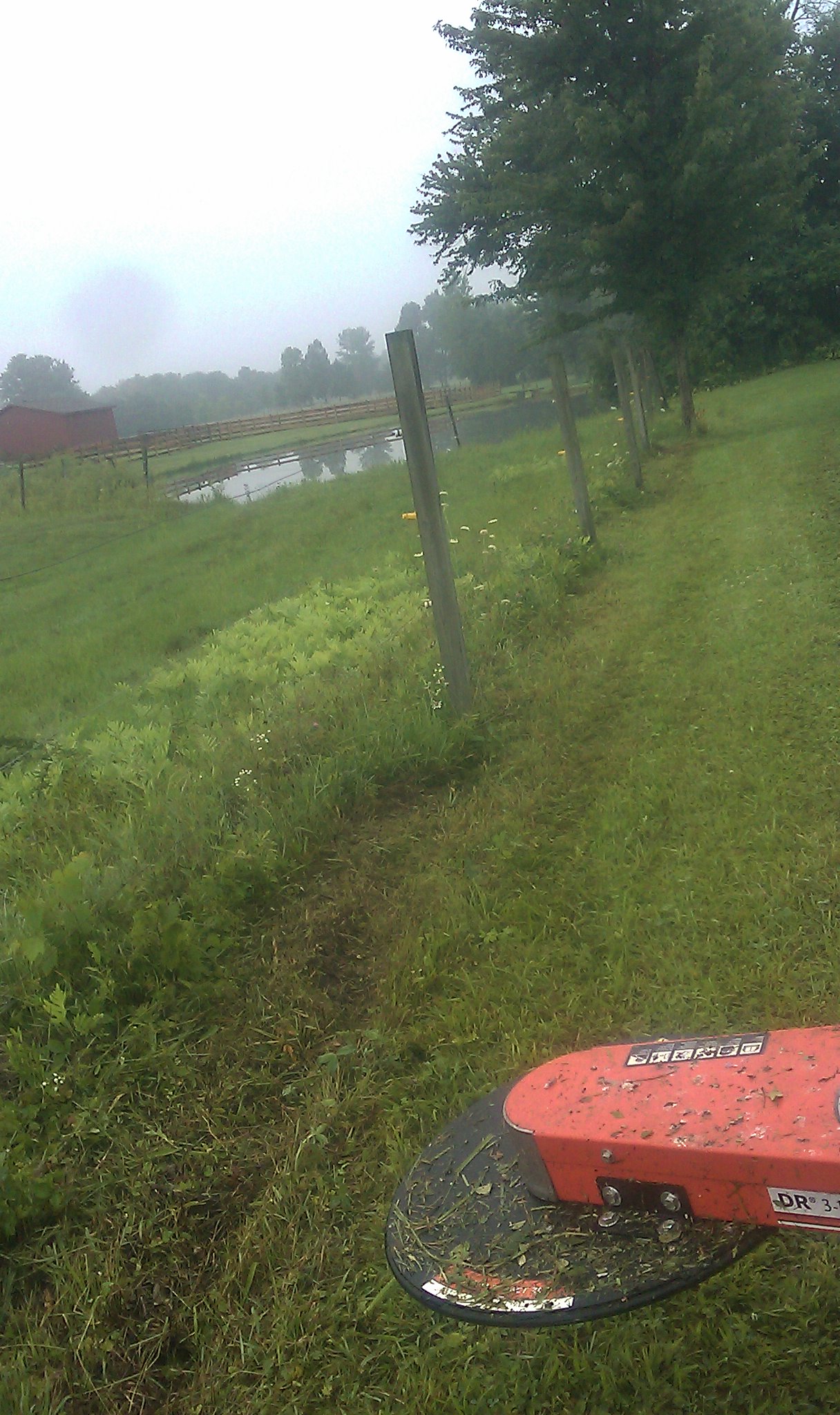

Some examples of how it looks when you trim on one side of the fence:

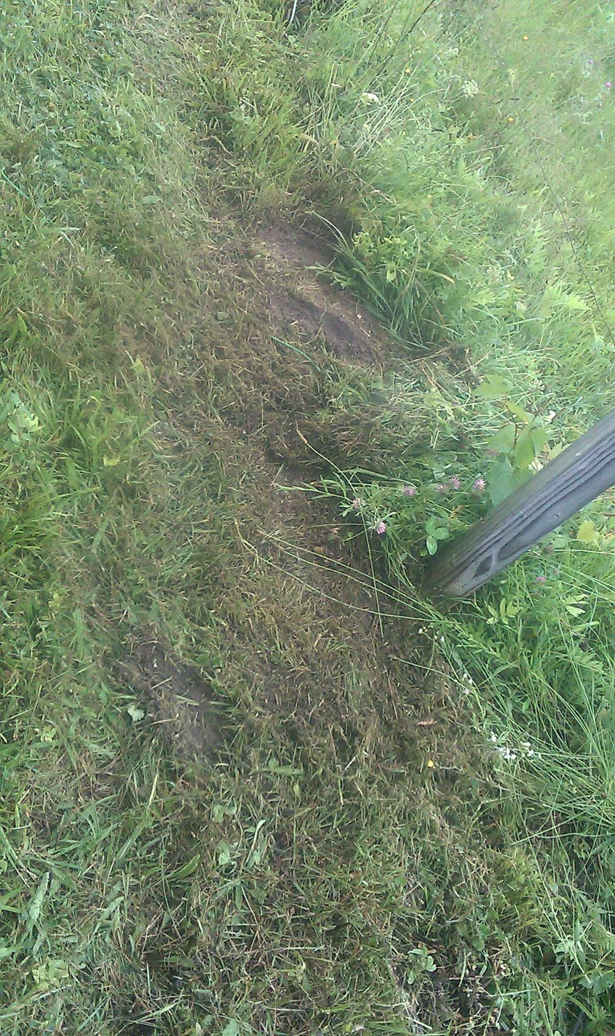

You never want the line to touch the ground. In this picture, there is a small ditch that the wheel kept dropping into and running the line into the ground. One set of lines lasted from the tree in the background to where the tractor is in the picture:

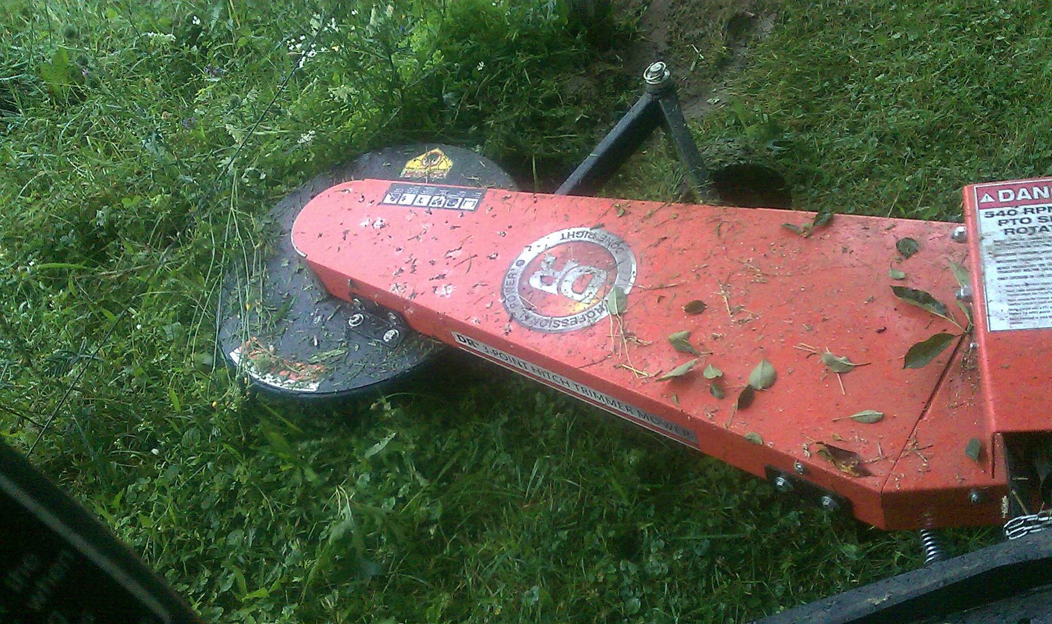

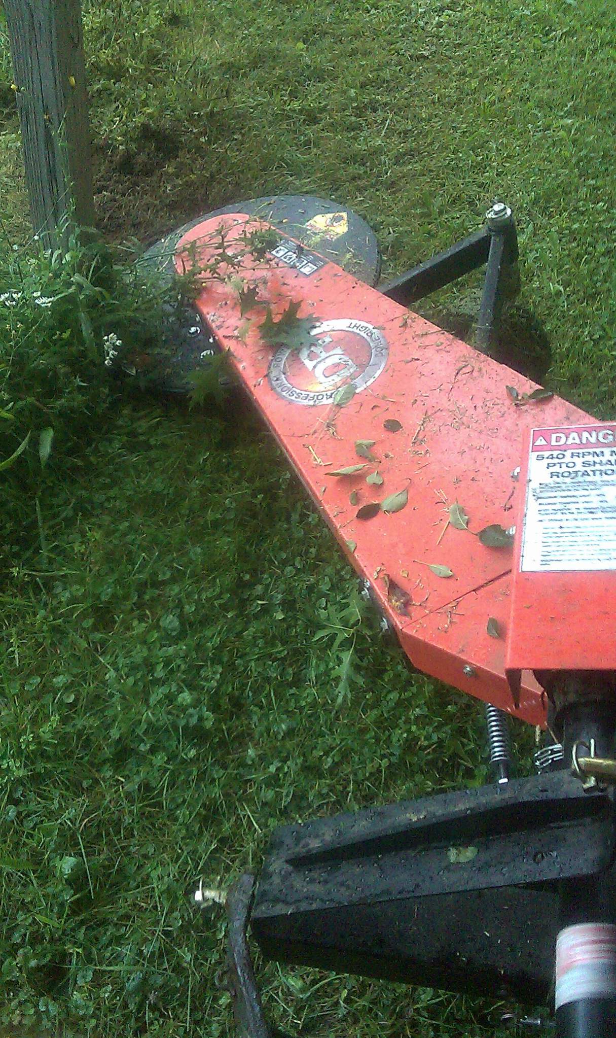

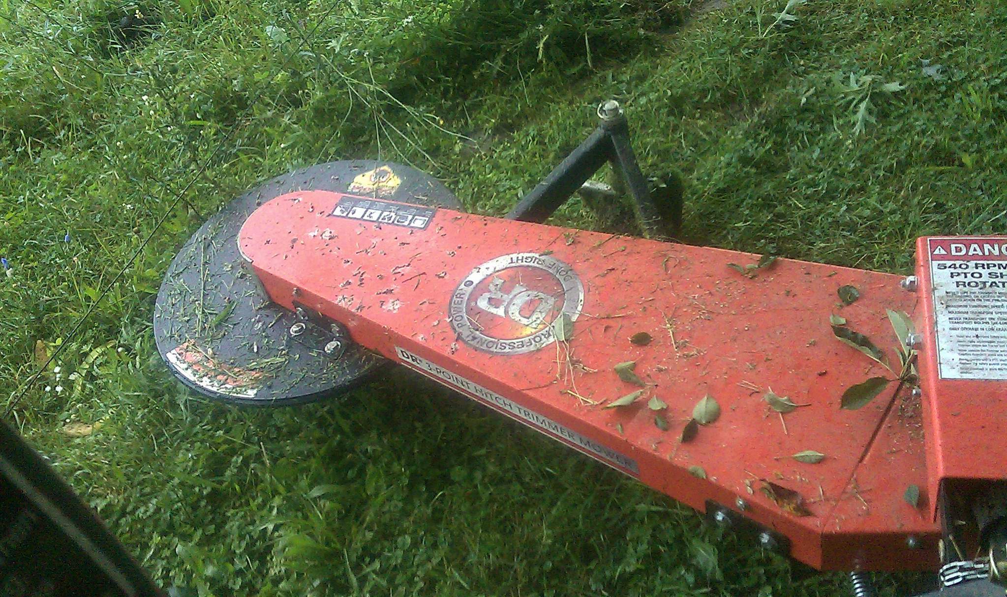

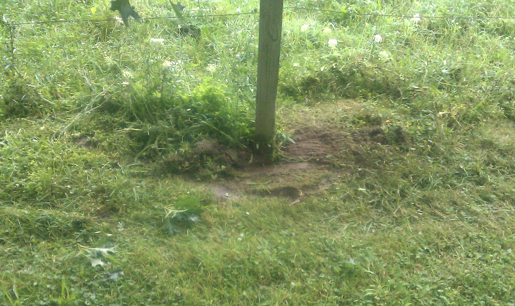

One of the downsides is that if the tractor hits a bump and goes up while the arm is back (as seen below) it will angle the cutterhead down drastically and scalp around that post. This is greatly reduced if you ignore DR's recommendation and leave it locked in "transport" mode rather than putting it into "float" mode:

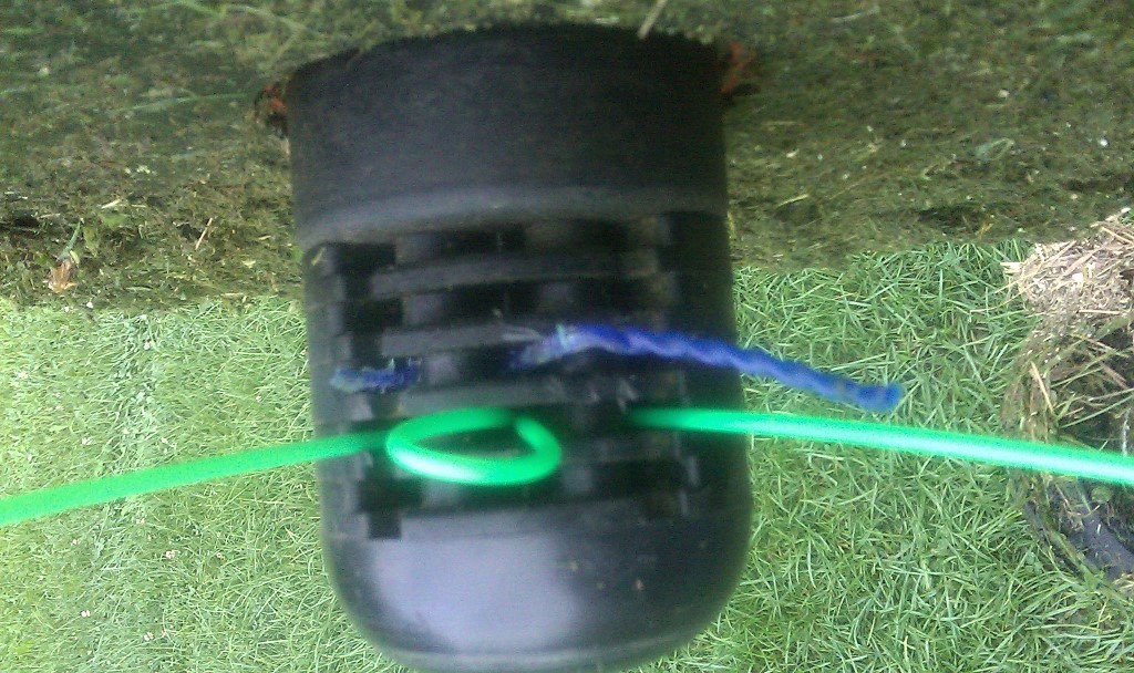

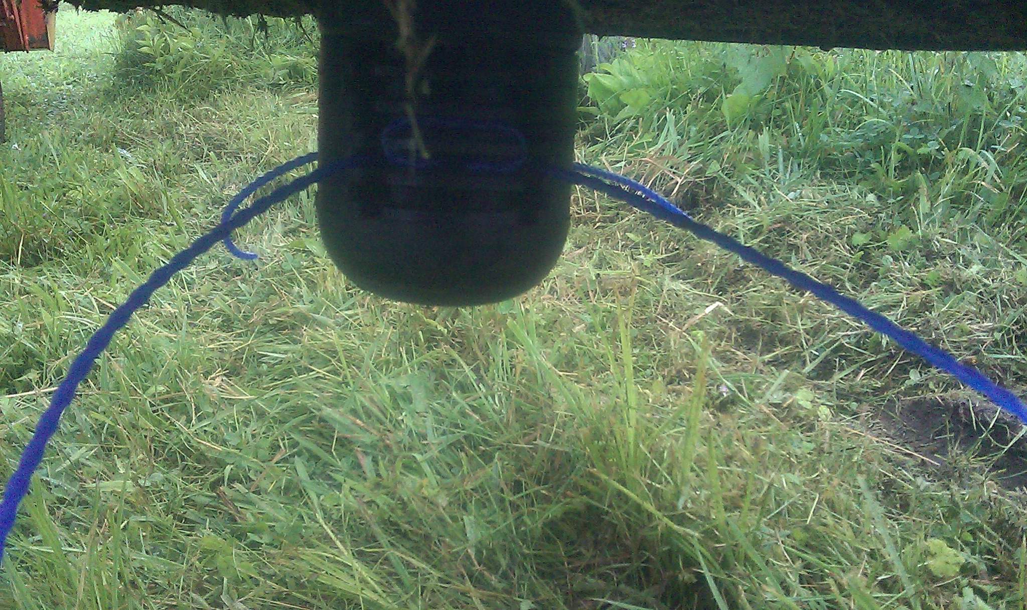

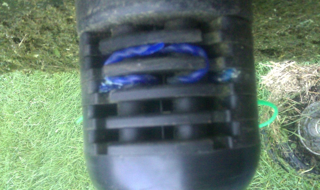

Here is how the line attaches:
I have it on the B7500 and can take more pictures if anyone wants to see a particular part.

Some examples of how it looks when you trim on one side of the fence: Aaron Z
Aaron;
Thanks for the update and pics. We would use it on a B2710 so seems to be similar to your application. Our primary use would be trimming two stock tanks.
Think I remember reading that one member had changed to smaller line with improved line life.
Sent from my iPad using TractorByNet
   / Using DR PTO trimmer on Cat 2 Tractor? #119
I think i would be upgradeing to small aircraft cable with welded ends.
