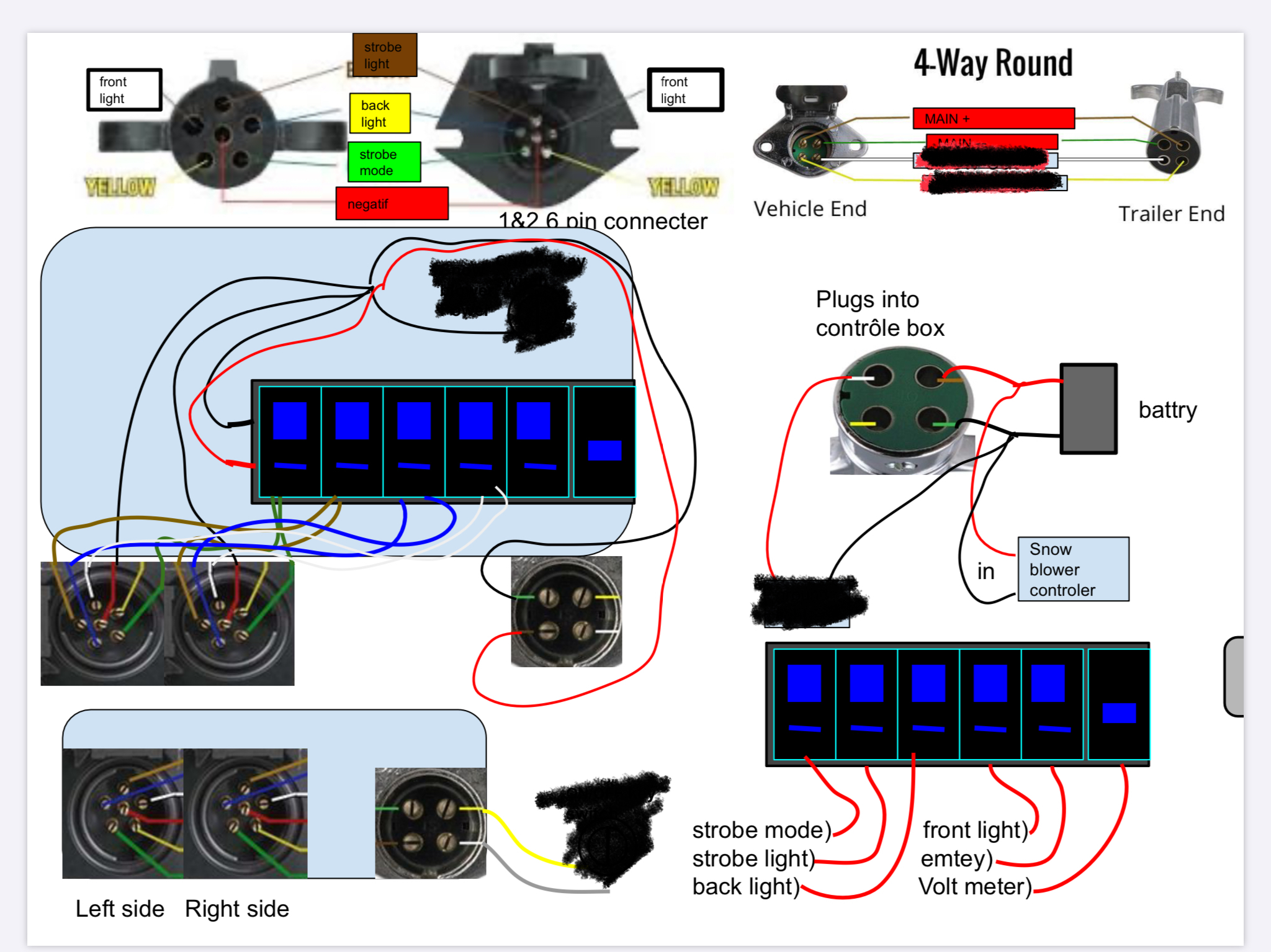

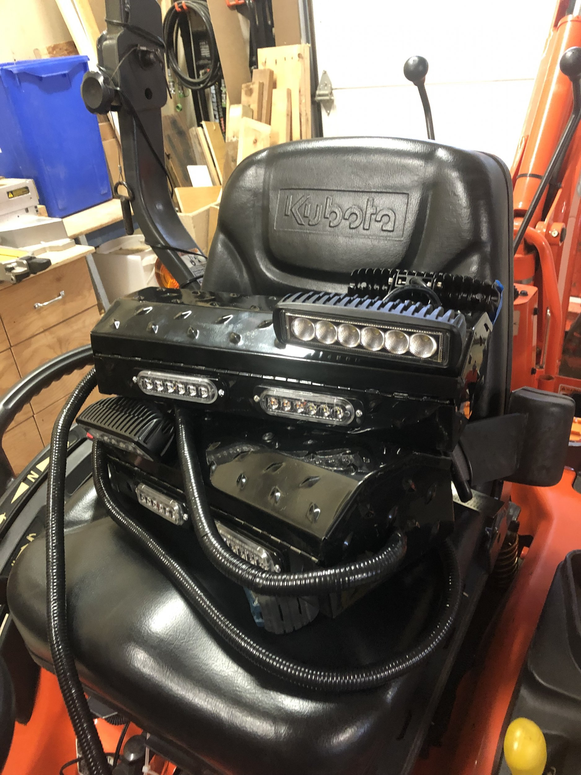

Here are shots of the fuse box. I gave up. The empty slots do not have the power side clips to even feed the fuse. I am sure the individual terminals I posted earlier would be fine to connect to a new device, and could also be used to run a new power feed for each circuit. But the only thing I'm gaining there is less leads on the battery. I spent more time researching and running to part stores than the actual project took to complete. Pictures of that to follow in another post later.

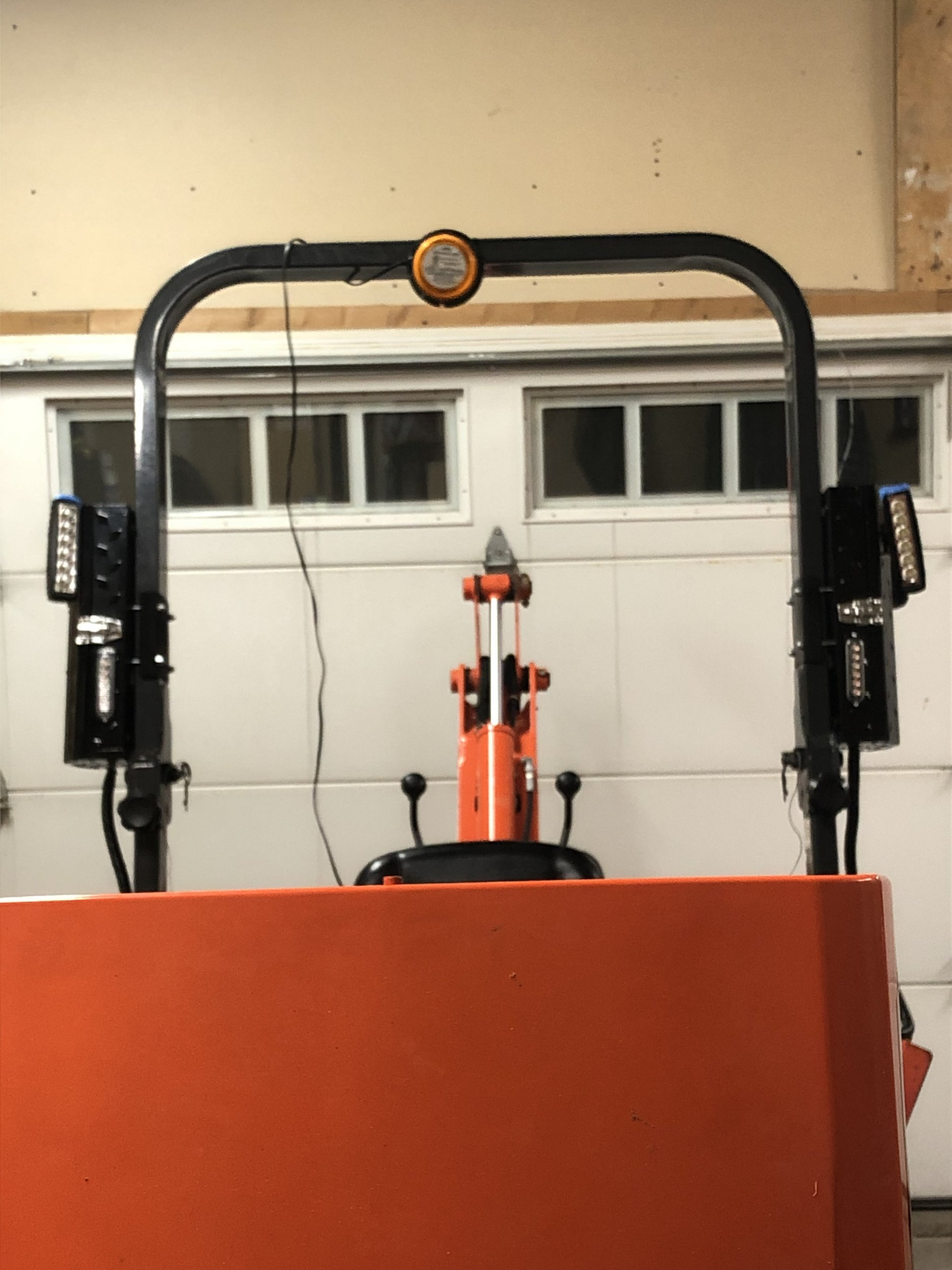

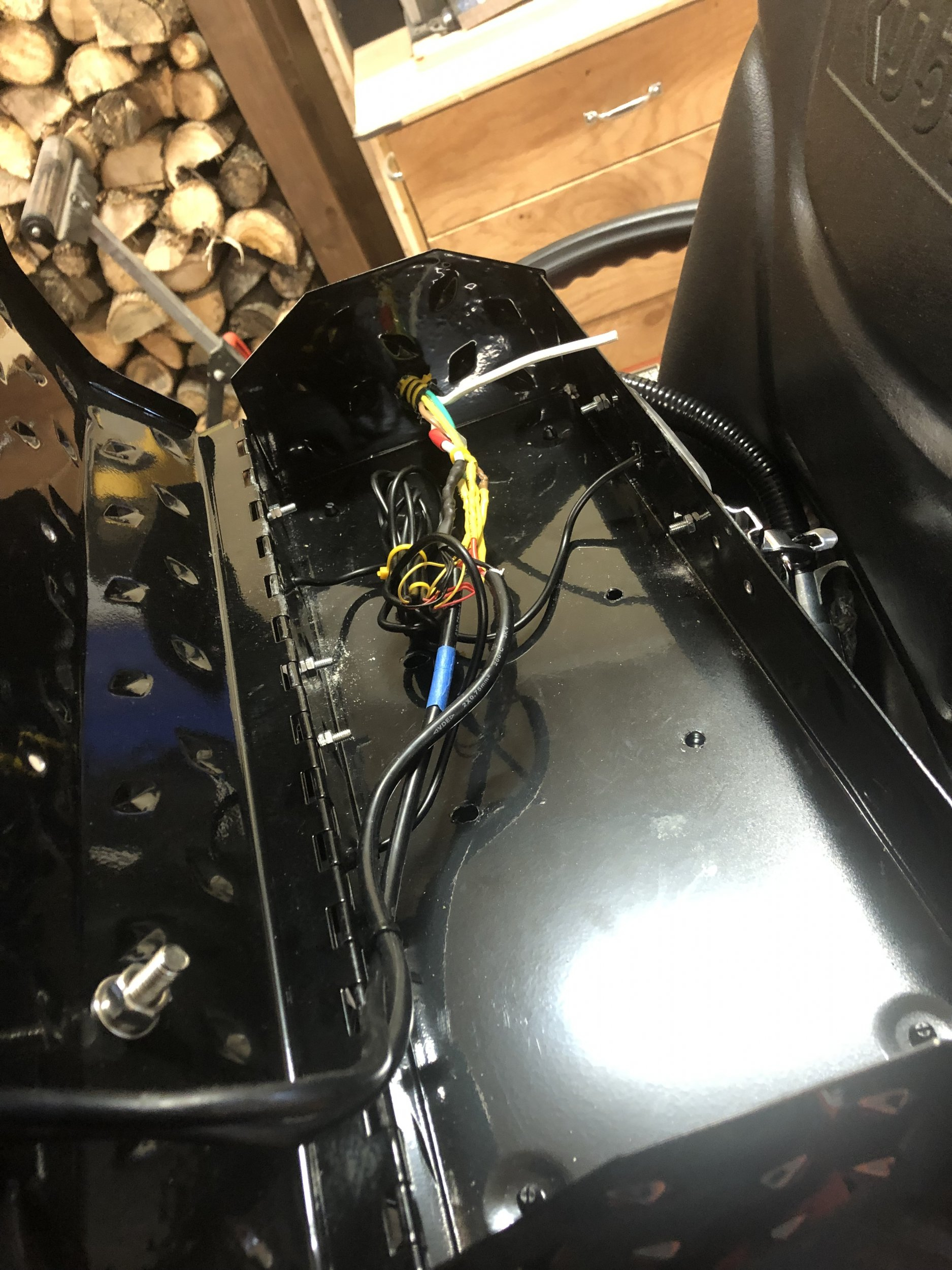

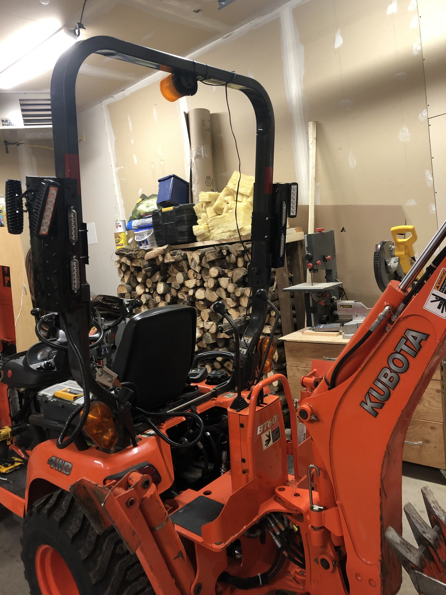

Thanks for posting this information, it’s pretty frustrating that we can’t use the empty slots. I’m making a removable side spot and strobe light boxs, controlled with a removable switch panel box on the side of the seat. All of that uses so much power we need a fuse to protect everything, so sadly we have to buy a single fuse holder.
And as a 16 year old this is really imperative, i made myself a wiring diagram to find out what connection to do.
The blackout spots are things that i removed.
