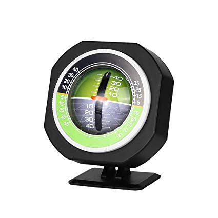

I've thought of a remote camera (magnetic mount) but not practical at the moment. There has to be some type of remote or Bluetooth enabled level out there, just for this situation. My biggest problem is just getting them level, front to back.
