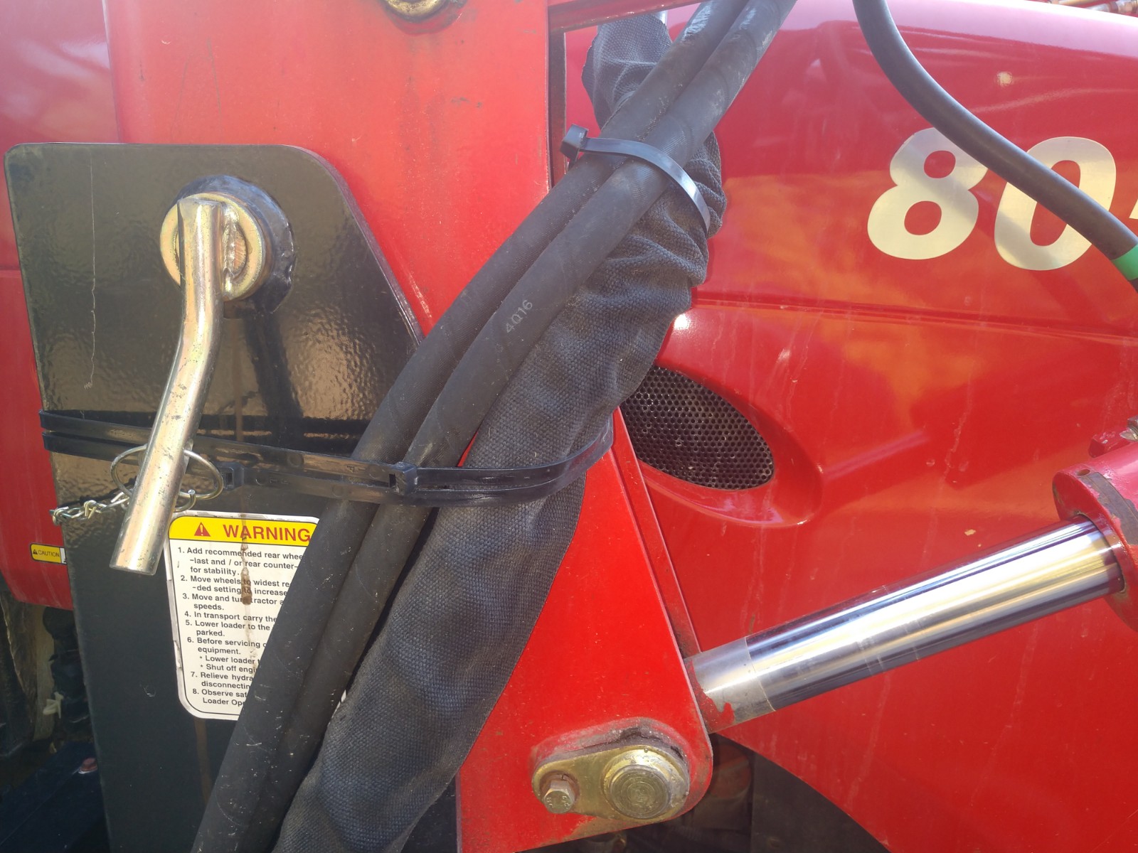

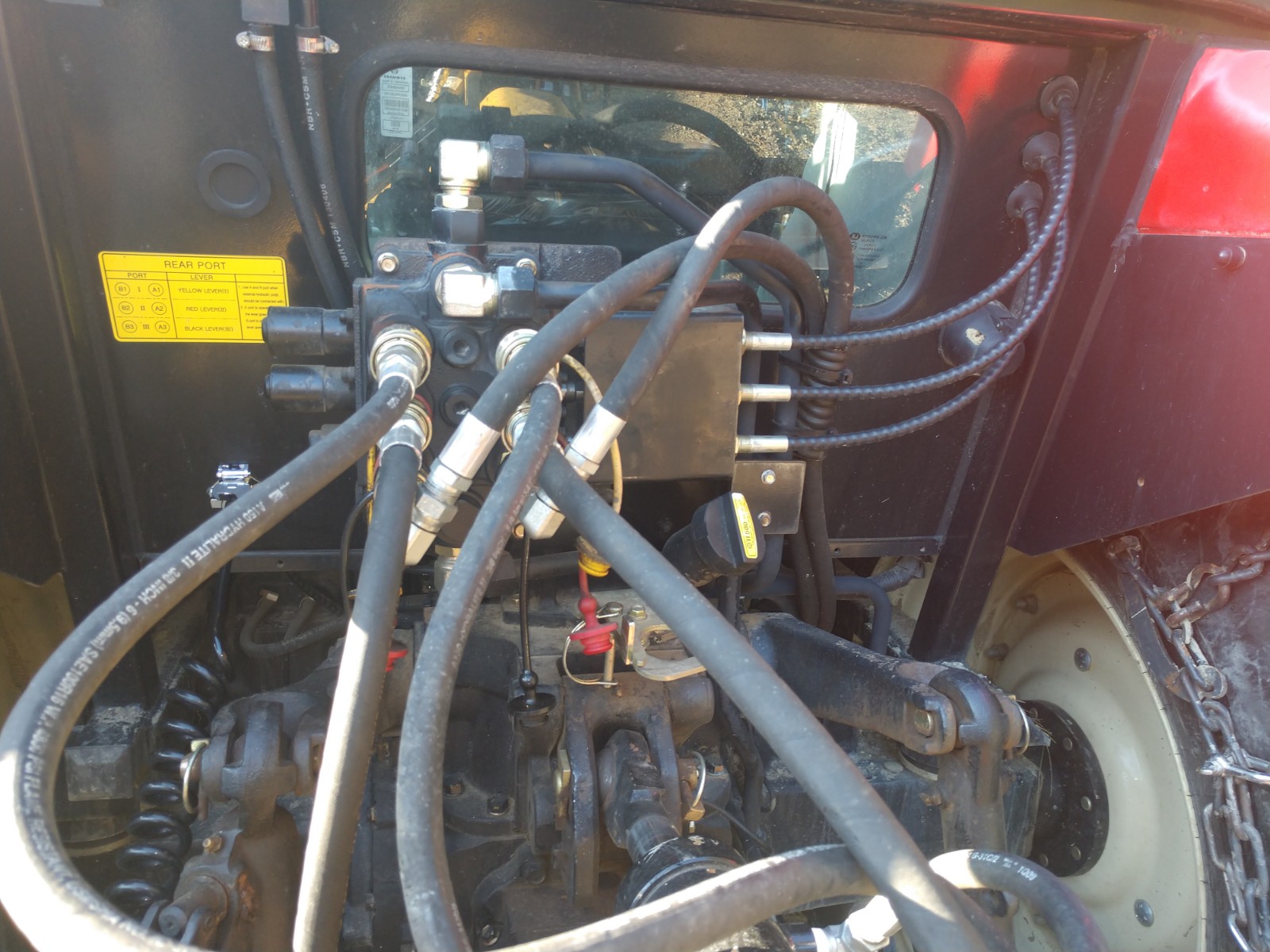

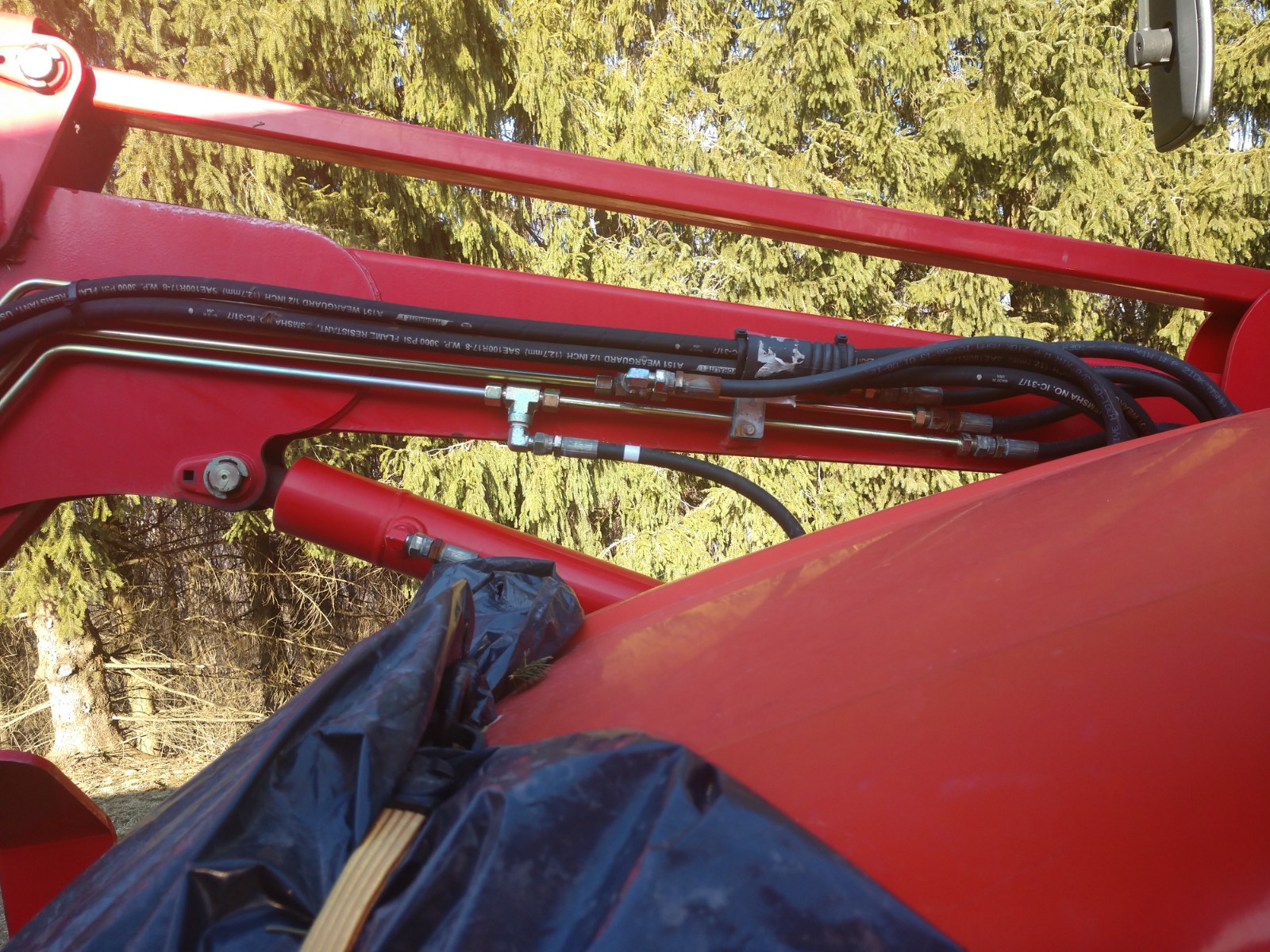

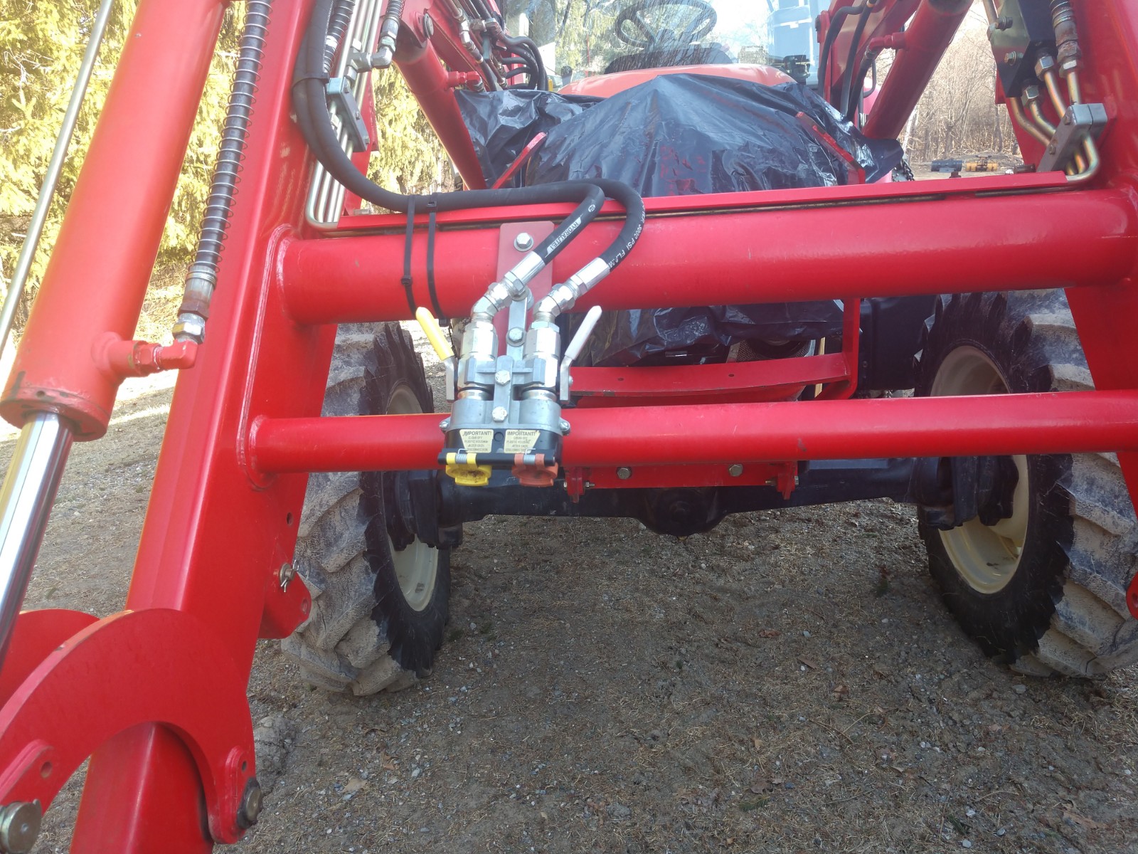

Lots of grapples run off of the rear remotes;
rear to front remotes3.jpg rear to front remotes2.jpg rear to front remotes1.jpg Rear remotes1.jpg

Yes, the extension has really worked out very well. It is all at your fingertips, and operates fast and effortlessly.

I ran the hoses from my rear remote over the rear axle tie strapping them every few inches to the fel loaders hoses or tubing. I ran a solid hose and the quick connects would be nice if you removed the fel, if not I would not add the extra cost. If you are new to grapples one thing I learned was to install quick connect fittings with male on one port and female on the other port. Made it easy to connect properly first time and I connect my fel grapple hoses to each other when disconnect to if the cylinder moves the pressure is not increased on one side of the cylinder. One other thing to consider on using a grapple as you are is be sure if the grapple is open in the rear to install a grill guard. If the grapple is solid or expanded metal on the rear your grill area is still exposed when loader is raised when driving into a pile.
