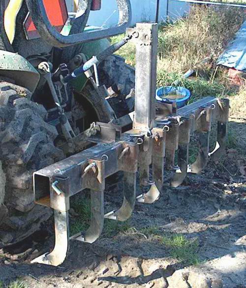

   / Using Scarifier as Chisel Plow? #12
this is one i made
