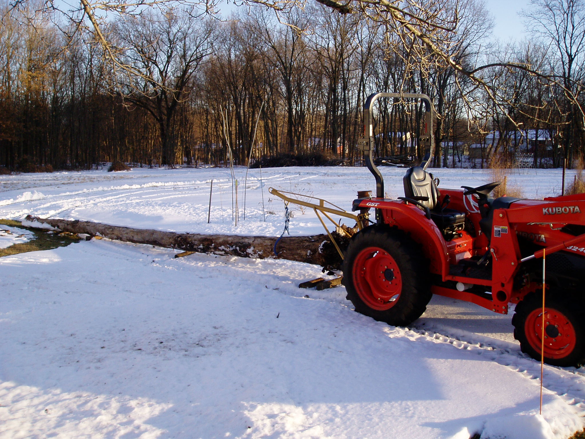

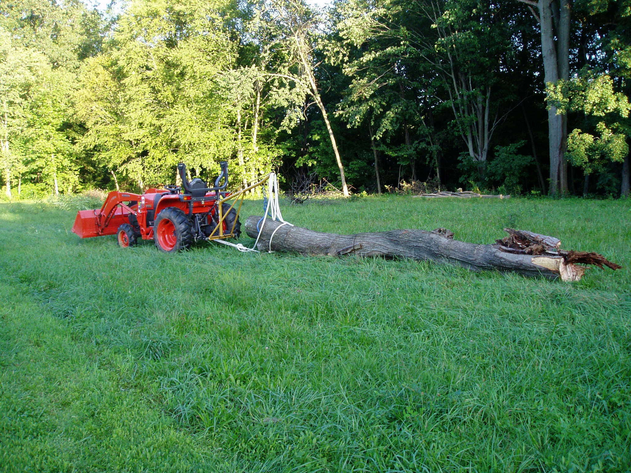

Here's my present method (until I get a winch):
Notice the shorty logs set under the one hanging from the boom pole - this gets my bar out of the dirt enough to cut to splitting length (22").
No where near ideal and still rough on my old back.
The boom pole is not an ideal way to skid logs, either, as the attachment is high and the pulling load is transfered to the tractor high; thru the top link. This presents a real "oportunity" for doing a back flip, with me getting crushed under the tractor, as well as creating roll instability when turning.
For this reason, I only lift with the tongs and always pull with a separate chain or rope attached to the frame mounted drawbar:

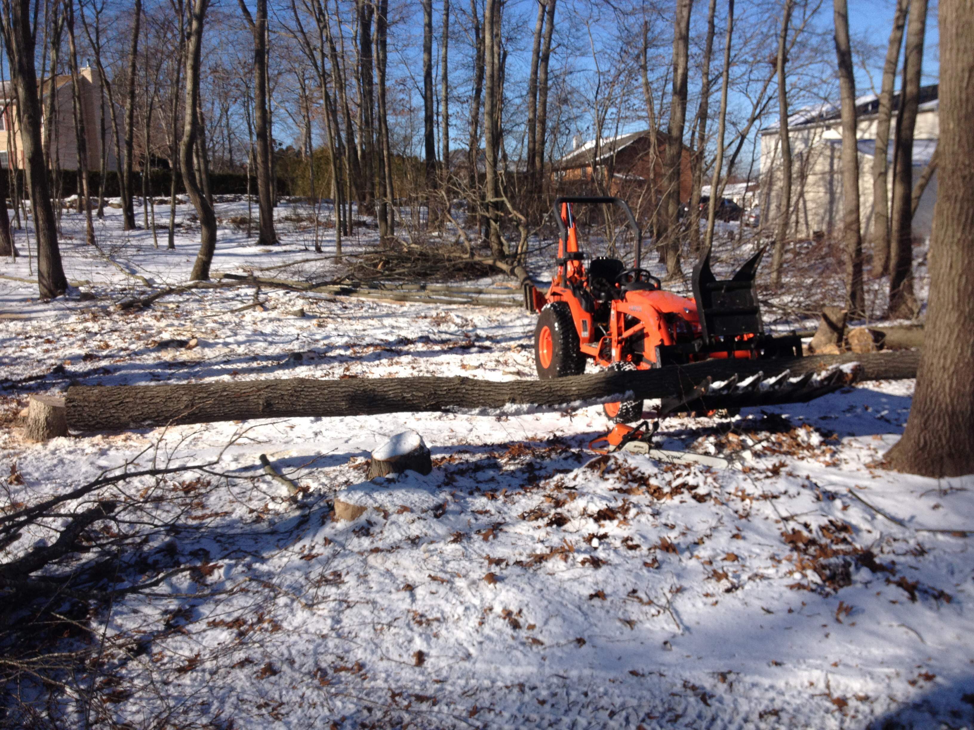

I find the toothbar handy for lifting logs. Just drive under it, curl and lift. It is possible to lift and balance medium-sized, 70' fir and pines across the teeth and then cut from both ends so it stays balanced across the bucket. This works particularly well if cutting with a neighbour. We mark the entire log and each cut on opposite ends, maintaining the balance. It takes just a few minutes to cut up the entire log.
If the tree is too large I just raise the butt using a tooth or two.

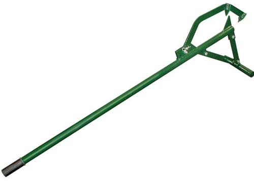

I also have a log jack where it is impractical to lift with the tractor:

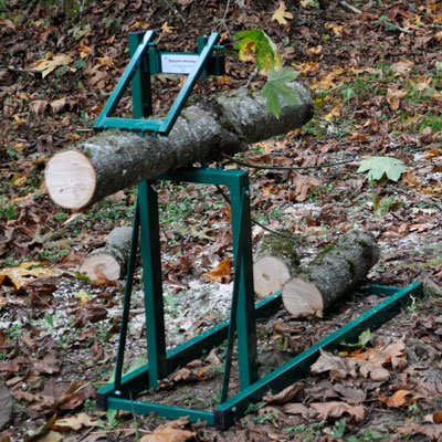

And a Smart Holder for cutting smaller wood:
I'd like to make a bracket to attach the Smart Holder to the tractor bucket. It improves safety, particularly when cutting those smaller tree ends and branches--much better than holding them with a foot!
