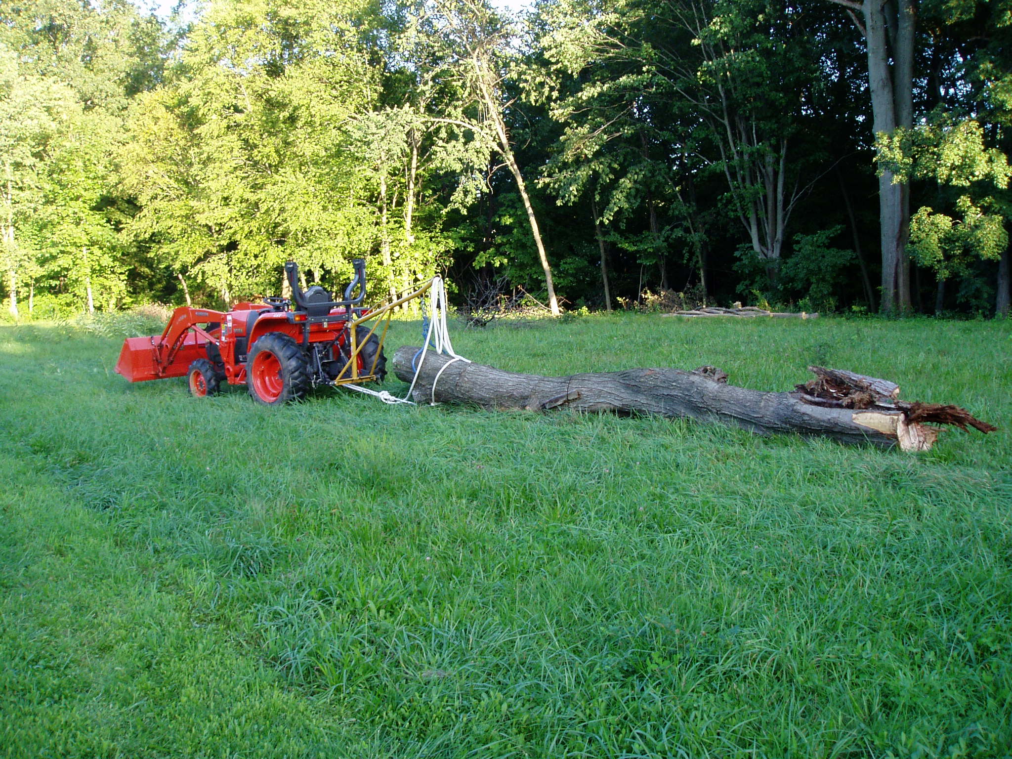

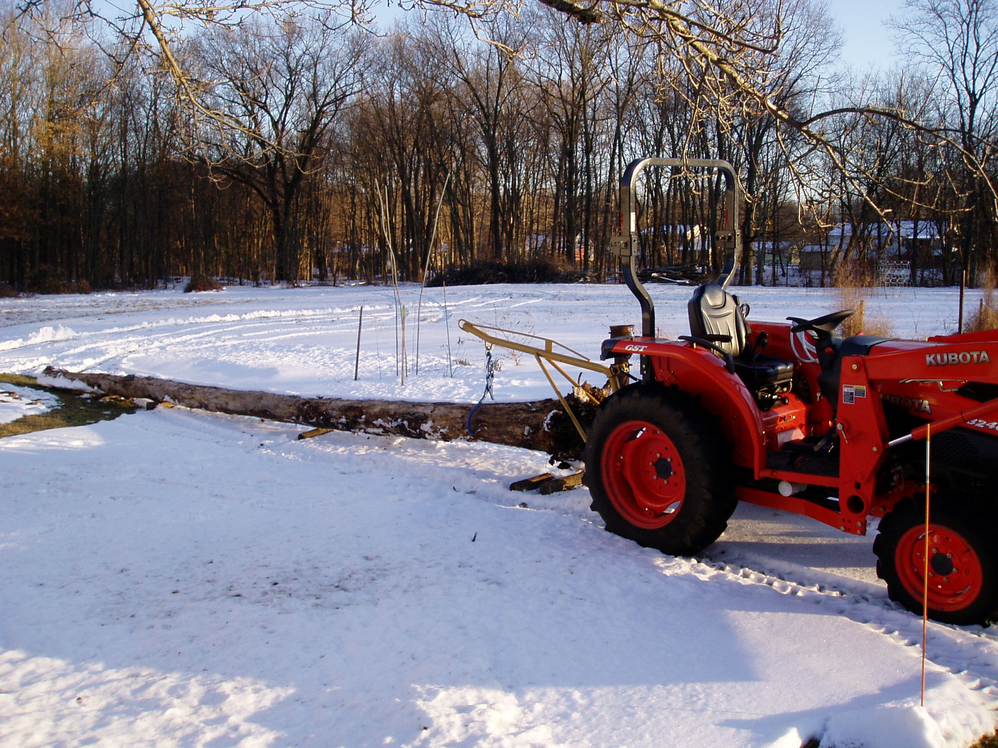

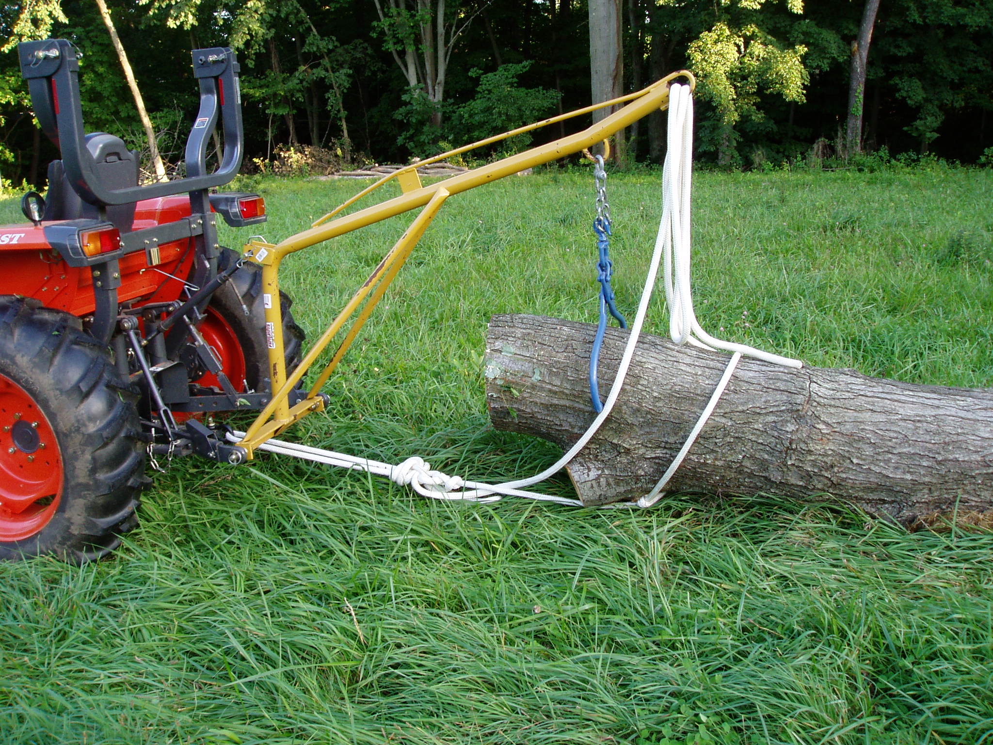

Here's my present method (until I get a winch):
Notice the shorty logs set under the one hanging from the boom pole - this gets my bar out of the dirt enough to cut to splitting length (22").
No where near ideal and still rough on my old back.
The boom pole is not an ideal way to skid logs, either, as the attachment is high and the pulling load is transfered to the tractor high; thru the top link. This presents a real "oportunity" for doing a back flip, with me getting crushed under the tractor, as well as creating roll instability when turning.
For this reason, I only lift with the tongs and always pull with a separate chain or rope attached to the frame mounted drawbar:
Thanks for that tip!! Yeah, it can be pretty dangerous to pull something heavy from higher up... Your chain/rope trick to the drawbar is a really nice tip for those using a 3pt mount. When I think back 20 years to the one I made for the fordson, one of the design errors was that it picked up too close to the tractor, so you couldn't turn to sharp without rubbing the tires....
I wonder if I can make one that attaches to the backblade..... Could just remove it but we use the blade quite often, and my old man is going to want it on there - and I'll be the one hauling wood....
CM

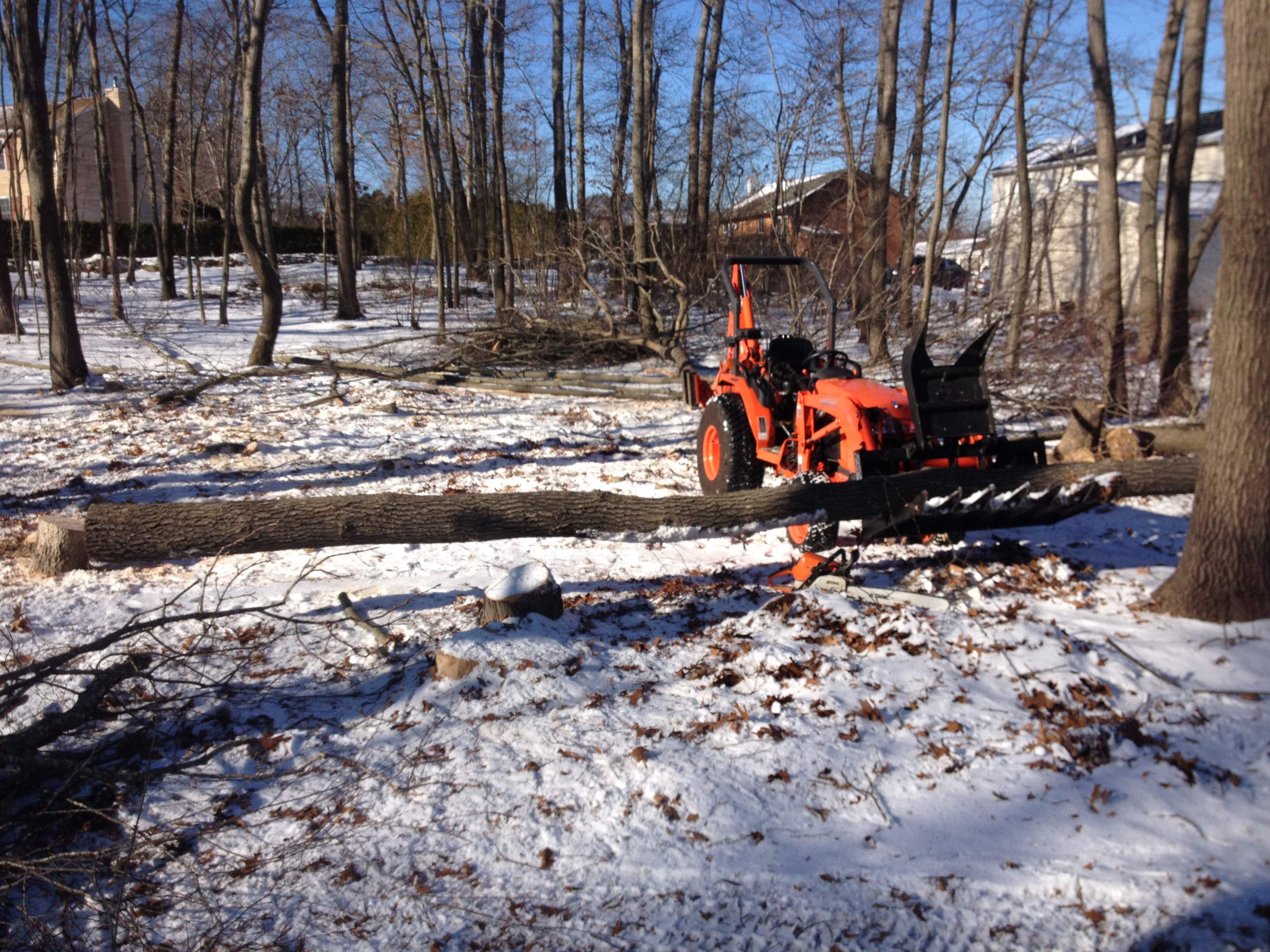

I find the toothbar handy for lifting logs. Just drive under it, curl and lift. It is possible to lift and balance medium-sized, 70' fir and pines across the teeth and then cut from both ends so it stays balanced across the bucket. This works particularly well if cutting with a neighbour. We mark the entire log and each cut on opposite ends, maintaining the balance. It takes just a few minutes to cut up the entire log.
If the tree is too large I just raise the butt using a tooth or two.

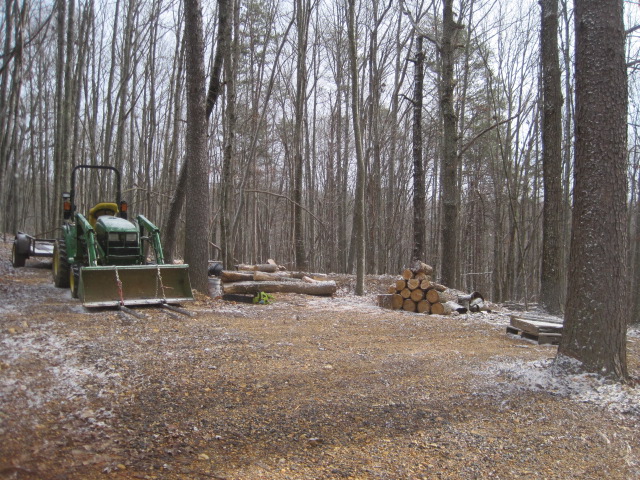

   / Using Tractors for Cutting/Handling Firewood #20
Colonel Monk,

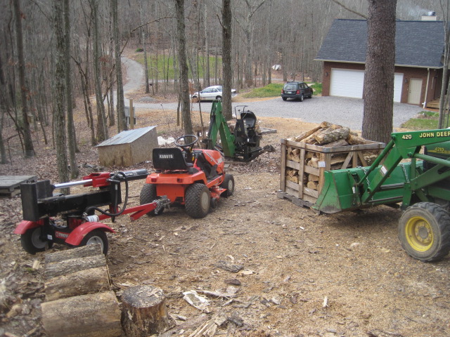

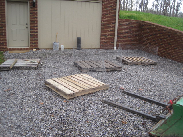

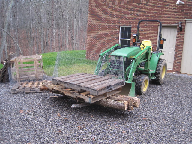

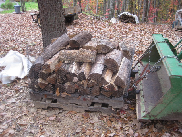

I've been fine tuning my firewood cutting/moving process. Forks on the bucket are indespensible.
I put chicken wire around some pallets and can easily move cut and split firewood around.

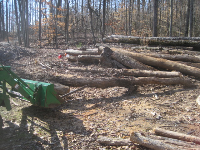

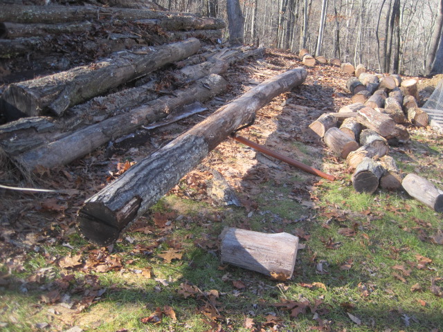

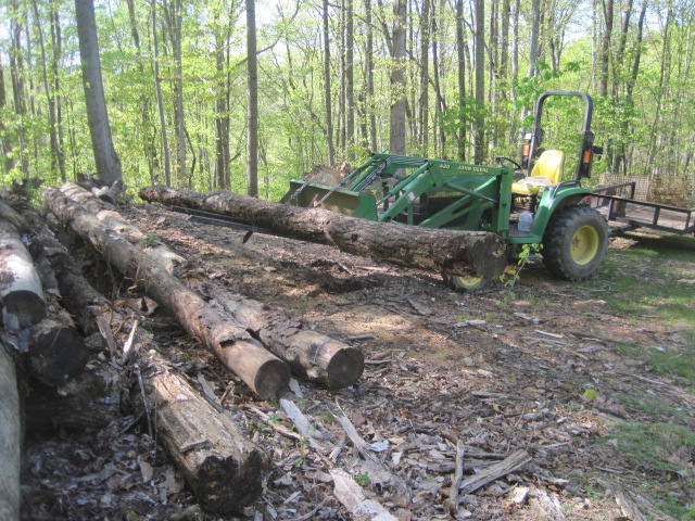

For moving logs, I cut them up about 8 feet long and carry them on the forks. No dirt on the logs this way, unlike skidding.

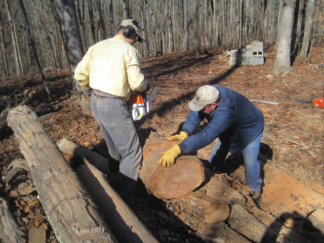

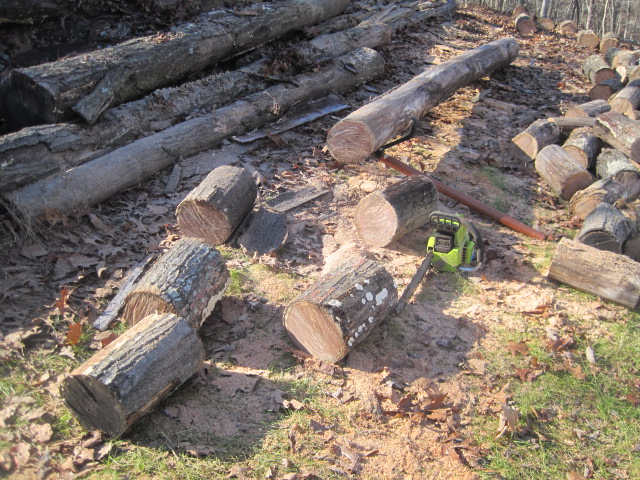

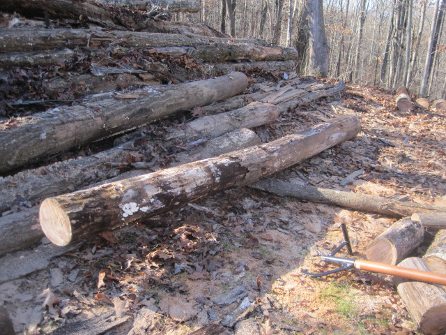

Get a good chainsaw.

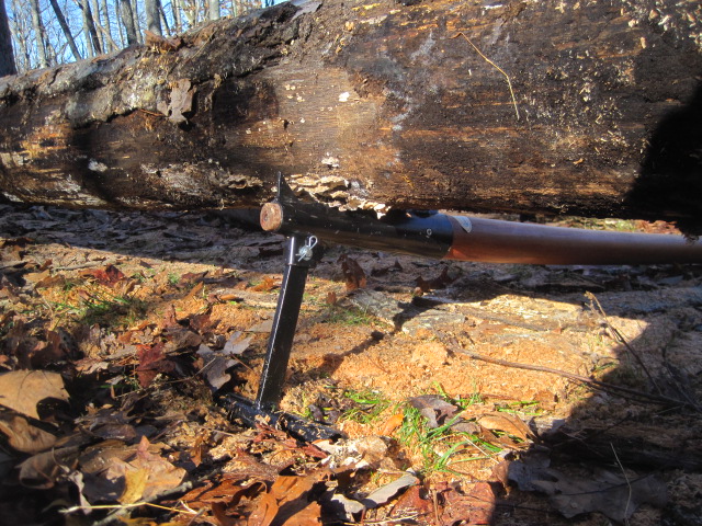

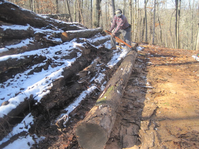

This cant-hook can lift logs for cutting. However, I normally just cut the log 3/4 through, roll the log over, then finish the cuts.

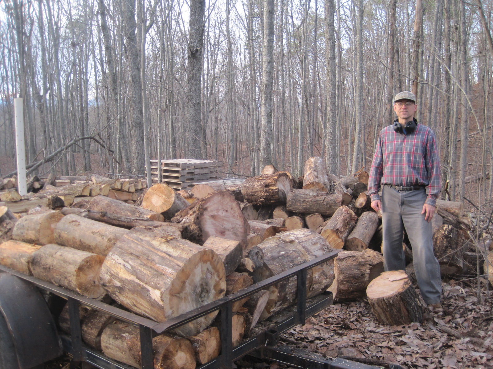

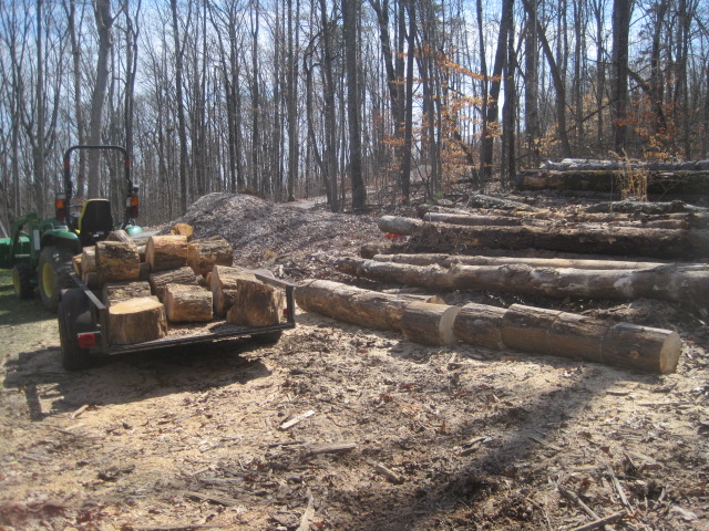

5x8 trailer I pull behind the tractor (paid $300 off of Craigslist)

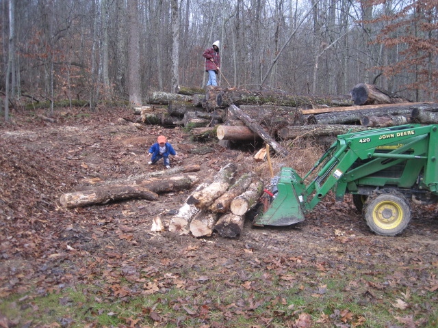

Lifting logs with the forks

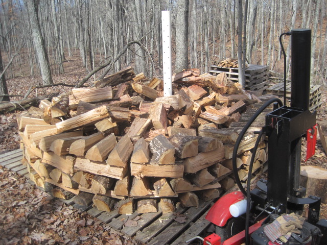

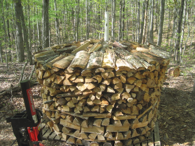

European round firewood stack - so you can throw tough to stack odd shaped firewood pieces in the middle.
