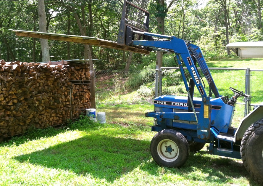

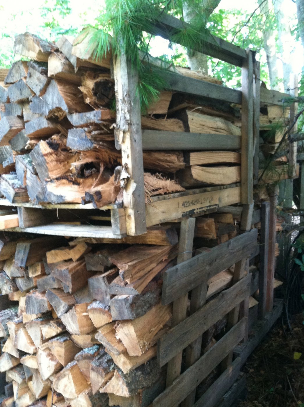

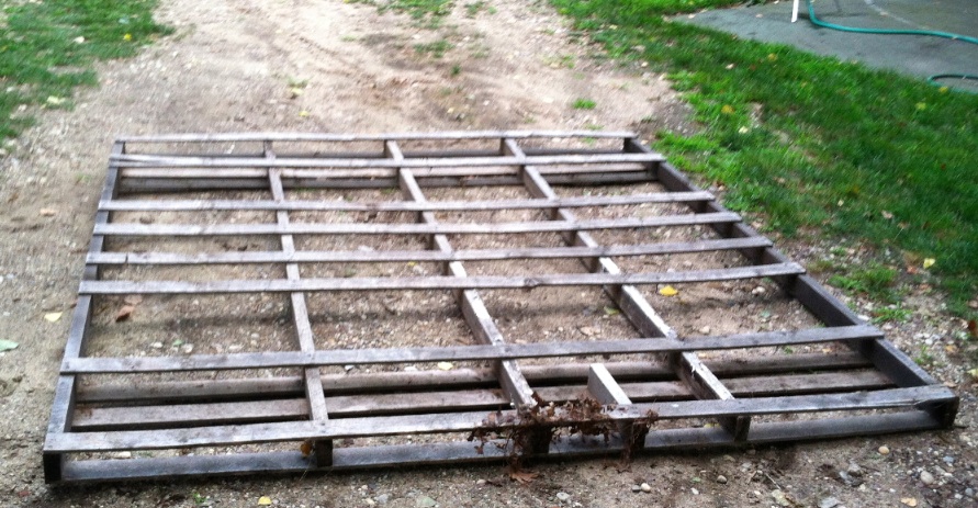

I have used pallets for sides but when empty they're hard to take apart and stack. I've even made them half height so I can put a half on top of a full height one.

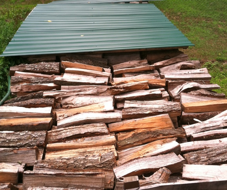

I let my oak sit for 3 full summers before burning.
I think I have 25 of the full pallet racks and 10 of the half racks made
I now have much more wood than the pallet racks can hold so I use some like bookends and then fill in between with loose wood that I empty off the last 2 pallet racks.I use the last tow to fill in all racks unloading and stacking till I'm done then fill them and leave them alone.

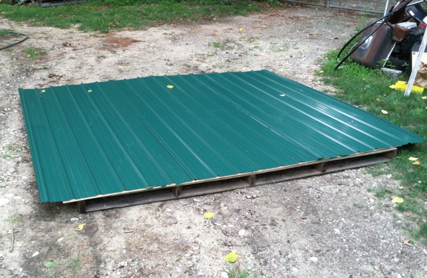

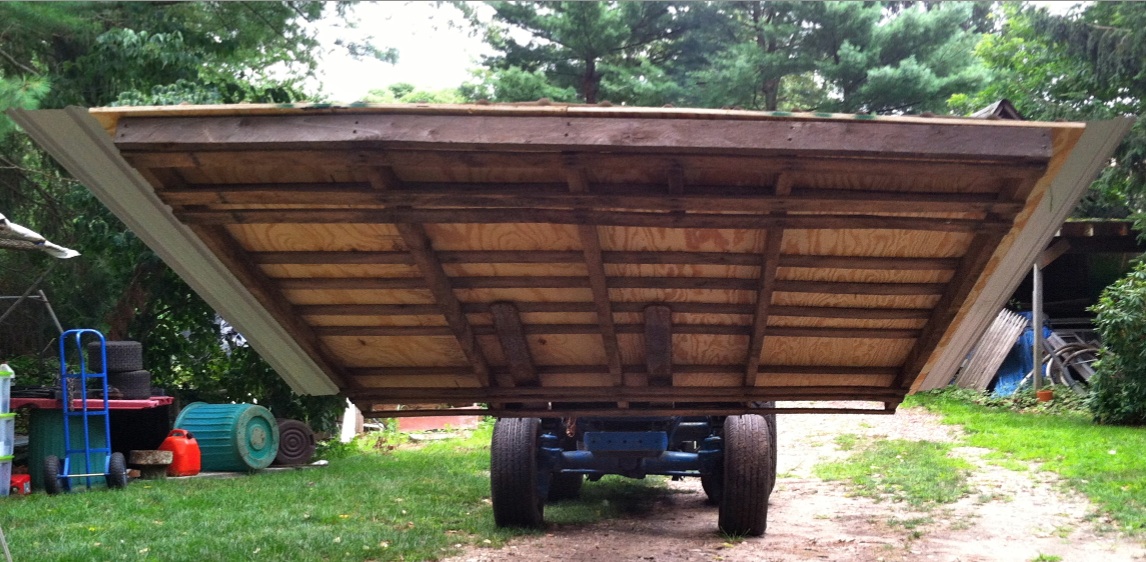

I also used skids from the local hot tup store 7ft x 7 ft put ply and metal roofing on to use as a temp and moveable roof.
I only use it to cover the wood being burned this season
Since Sandy I've built up quite a supply about 30 cords
I use 5 per year and give away a few per year to people who need it.
