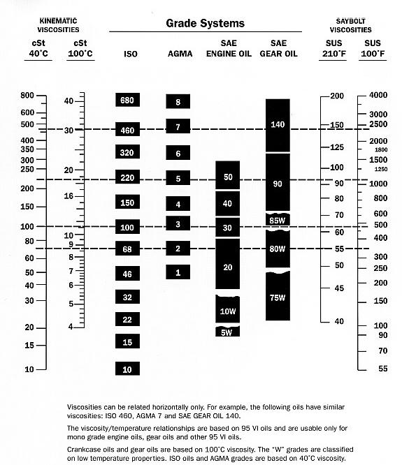

Do so at your own risk. UTF isn't formulated to replace 80w-90 gear oil. It does not have an AGMA rating.
