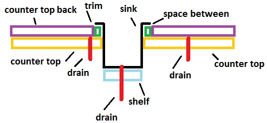

not to sure about this idea... first time you put something wet down, the water going to go between counter top and edge of sink and down. as you fill sink with water and drain it a few times and plain just over time. the sides (in the middle) are going to warp in/out and wiggle about. so any sort of silicon or even spray foam. is going to come loose and still leak between counter top edge and sink edge.
leave the sink free standing. or chop off the legs. and place it on a shelf. and let the top of sink stay above the counter top.
for counter top you have the normal L shape (counter top itself, and then a backing that forms an L), but also put a piece of trim up against the sink on top of counter top. to help fill in the gap. and the edge that sticks out from top of the sink. so water on counter top does not have a chance to drip down.
i don't remember the words. but shower inserts, it has been a while since i last looked. but you might be able to get a piece of plastic for the long side of a bath tub (just a sheet of plastic). toss that down on some plywood, instead of laminate. perhaps go as far as sanding down the plywood. and tilting plywood on purpose. so any water drains to a single common back corner or back in the middle. and install 1" to 2" shower drain. or a regular sink drain. so water goes straight down the drain. vs having to wipe the water off. a shower pan with a drain might give better idea for a counter top with drain.
custom aquariums, custom reef tanks, custom salt water tanks, to custom ponds with bottom drains, many of these have plywood and/or wooded bottom. were holes are drilled and a flange / toilet drain or like is used. from fiberglass, to epdm pond liner, to pvc liners, to other type of plastic like liners.
EDIT: add a chicken scratch diagram

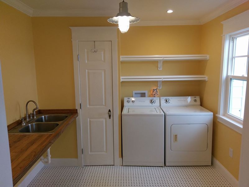

This is what I would do. Return the plastic shop sink, or sell it, or just through it away. Get a stainless steel sink that will work nicely on any counter top that you want to use that will look nice, wont leak,and wont require any modifications.
Here is a sink that I put into a laundry room that I remodeled for a client that used to be in their kitchen. The counter is red oak flooring.
