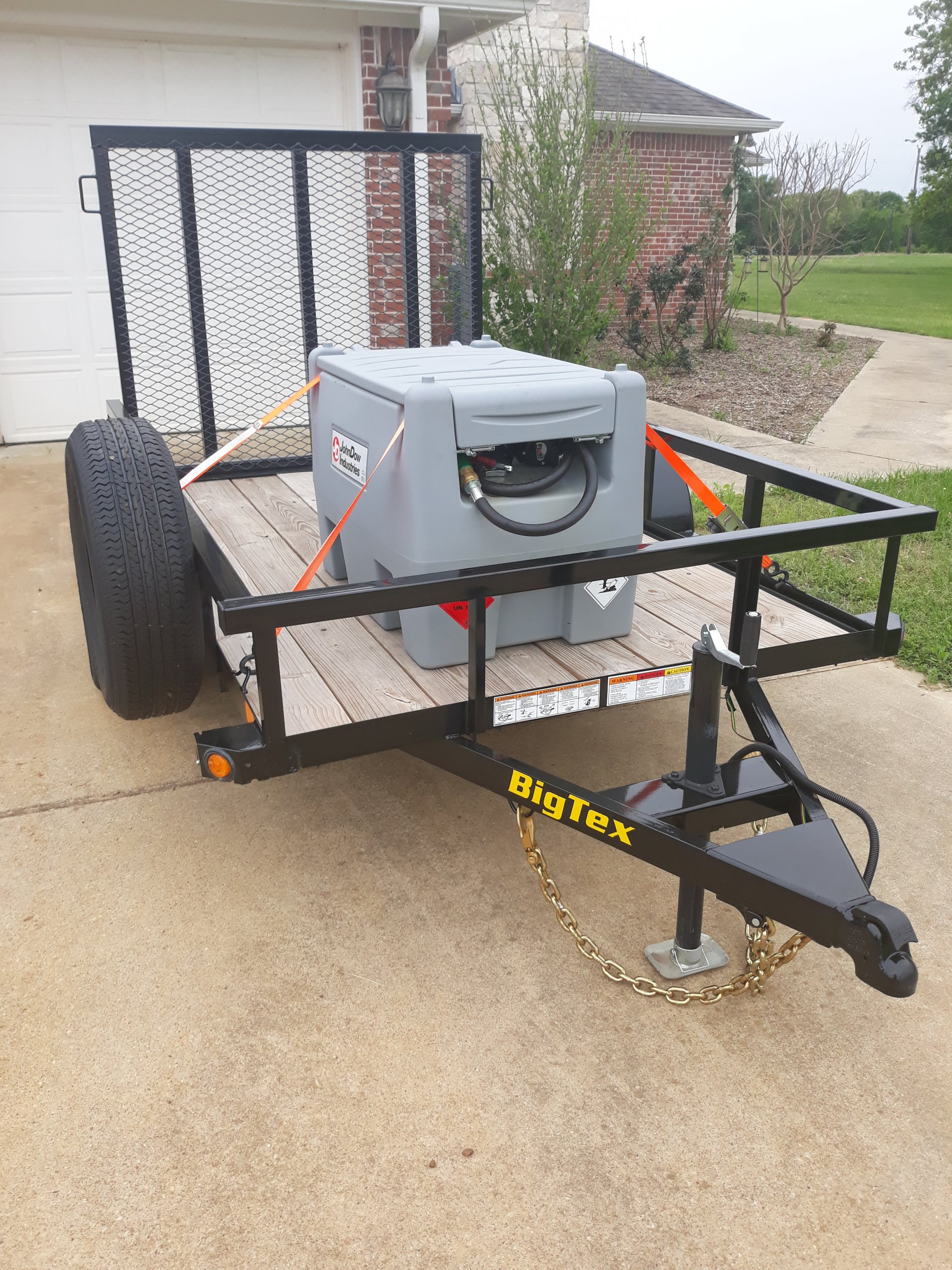

You can never have too many trailers. I have 3 Big Tex utility trailers - a 20' GN 12K, a 6'X14' 2 axle bumper pull 5K, and a 5'X8' single axle bumper pull 3.5K. The most used is the 14' trailer. It hauls hay, takes the ZTR and UTV to the shop, and stays hooked to the truck. The 20' GN is used to haul the smaller tractor and occasionally large loads of hay. The smaller trailer is my dedicated fuel trailer, the fuel pod holds 58 gallons of diesel with a 13' hose and pump.
The smallest tire I will have is the 15" on the 2 bumper pull trailers. They don't make a LT in that size so I use load range D ST tires. All are wood floors and have to be occasionally replaced.
