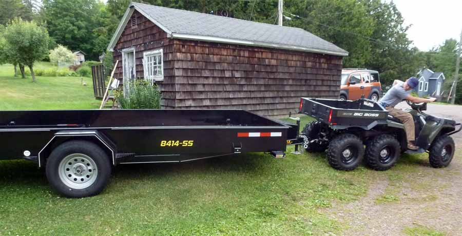

Any thoughts on PJ trailers? They have a 77"x 12' trailer with an optional 5200 axle...capacity ends up being just under 4000 lbs. Still light enough to be pulled by UTV with a few hundred pounds and can haul the utv and any related gear with no trouble.
/ Utility trailers - what should i know? #27
Like this?? :LOL:
I love my 7 x 14 PJ single 5200lb axle trailer. Only thing is it doesn’t have brakes, so while the axle can take ~4000lb of payload, it’s limited by law to 3500lbs max weight. If you need to haul 16ft fence boards you’ll need to remove the rear gate/ramp.
I’m about to upgrade to a 24ft Diamond C 14K Hydraulic Dampened Tilt (HDT) because I want the capability to haul tractors and vehicles.
