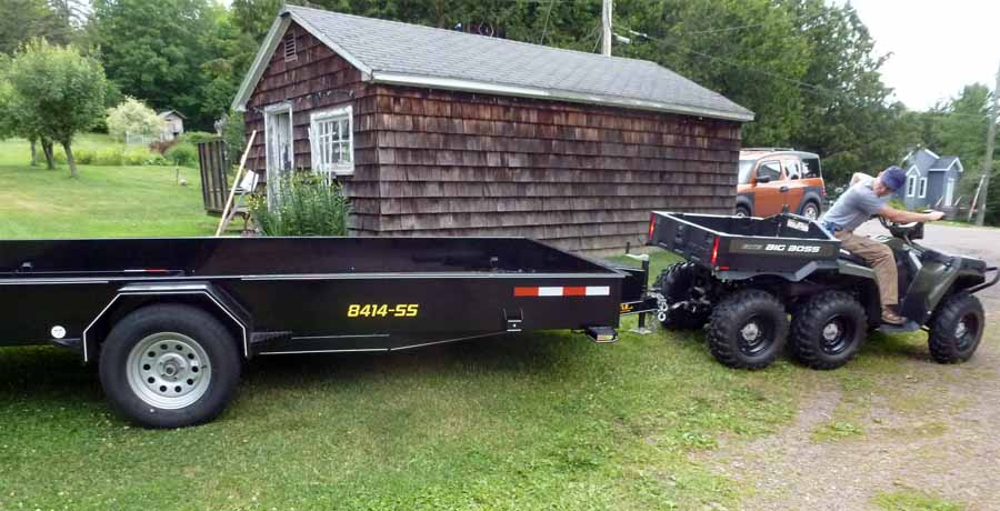

This is what I bought..Works great for everything I need it for. 16' 2 3500# axles.

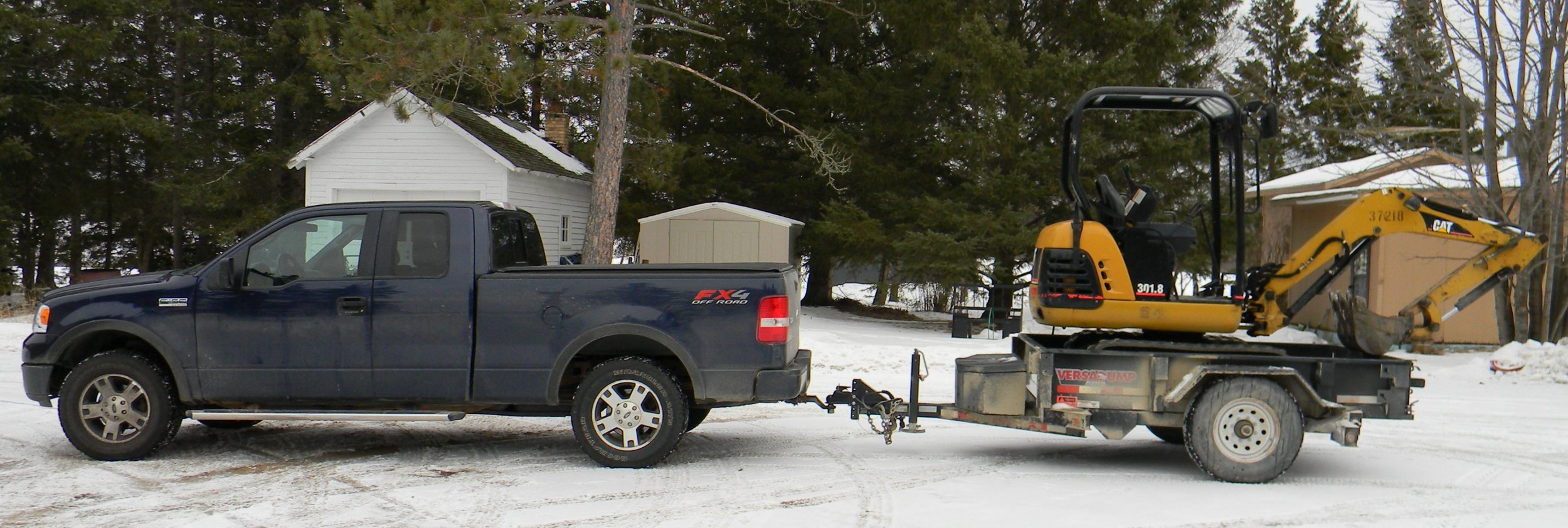

I have 4 trailers. This is a handy little trailer. 7,500 pound single axle, 5 x 8 dump, fits my F-150 (one in the picture has long since been replaced) and F-250 very well. Can haul my mini-excavator to a job behind pickup or tractor, use mini to do work on the job site and haul away material as needed, then reload and go home. Probably more expensive than what you want but at the time, price was reasonable and its multi-use capability has been outstanding. Size is 5' x 8'. Incidentally all of the buildings in the background of this pic were on our home site when we purchased it. With the aid of this little mini, the trailer, plus an L5740, they were demolished and hauled off within a few months of this picture.
