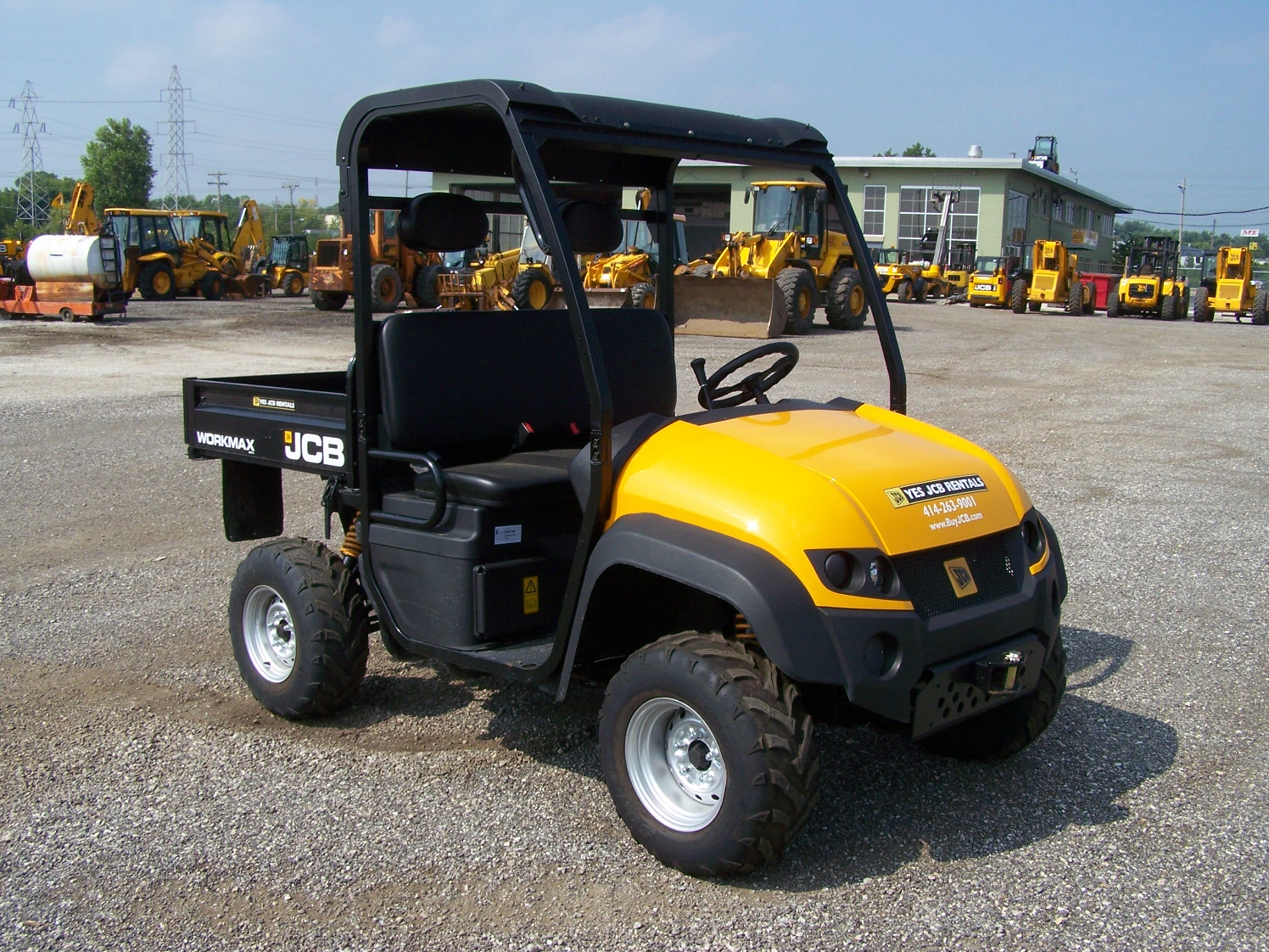

Hey guys, my neighbor is looking to get a utility vehicle and has given the project of finding one to me LOL. Since she has already made that first mistake ;), I want to get her the best possible utility vehicle for the money. I have a 610 Kawasaki, and love it but that is a little too small for her needs. I have driven gators, and loved them but they are out of the price range (she wants to buy new). Have also driven other mules and the kubotas, once again nice machines, but not what she wants. We have been looking at the JCB Workmax 800D, New Holland Rustler 120, and the Honda 700. All look like nice machines, and from the dealerships can get them for the right price about. We have a good JCB dealership and New Holland Dealer which I have dealed with. Our honda dealer is good as well, and I buy parts from them. My issue with the honda is it looks more like a playtoy then a work vehicle. She needs it to work on their trails, move hay, feed etc. Does anyone have any experience with any of these machines? Thanks, John

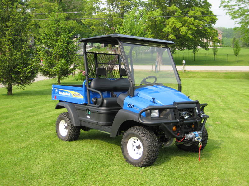

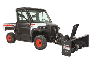

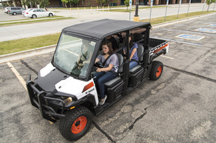

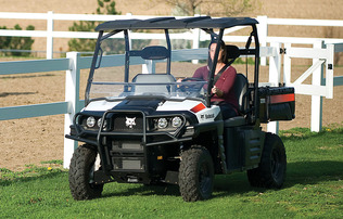

The Rustler is made for New Holland by Club Car. Let her drive it, she will want it. Only one lever for forward, neutral, reverse. 4WD is automatic, it runs open differential, switches to 4WD if needed, and locks either or both differentials it if needed.

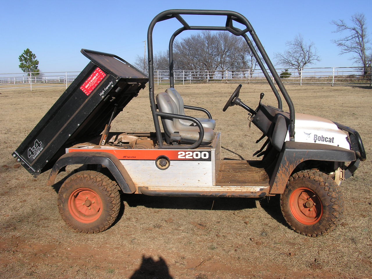

I have experience with the old Bobcat version. First one was gasoline powered, note the aluminum frame showing at the front wheel. Put 163 hours on it, then traded it in on the diesel
Second one was diesel. Put 145 hours on it.
Liked them both! They never got stuck and pulled my TORO out several times. :thumbsup:

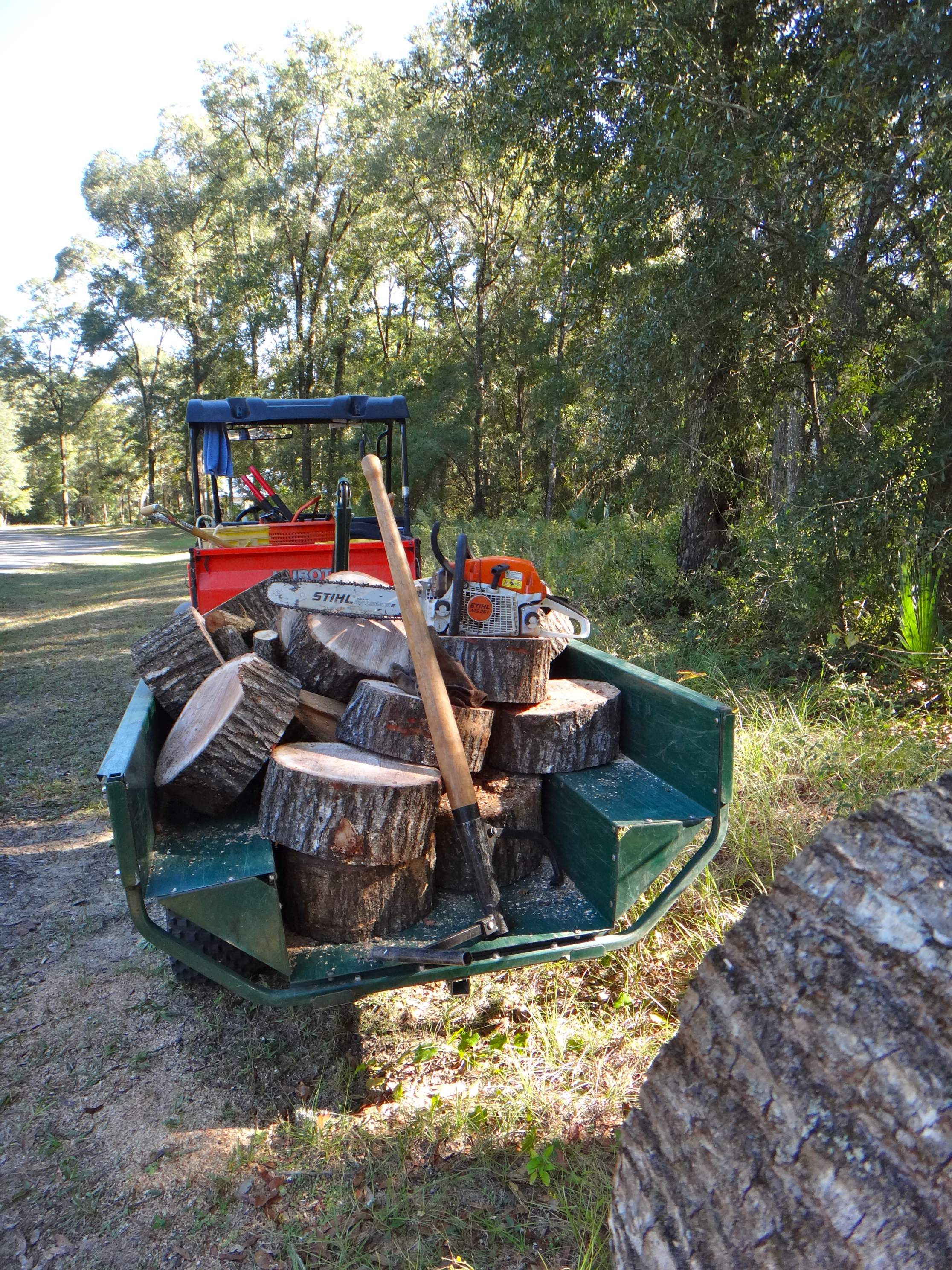

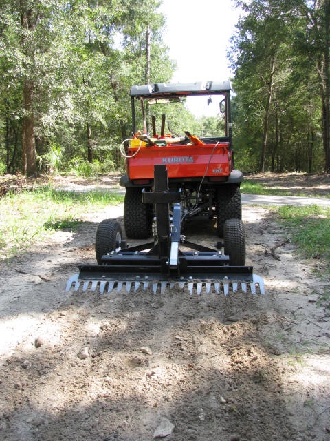

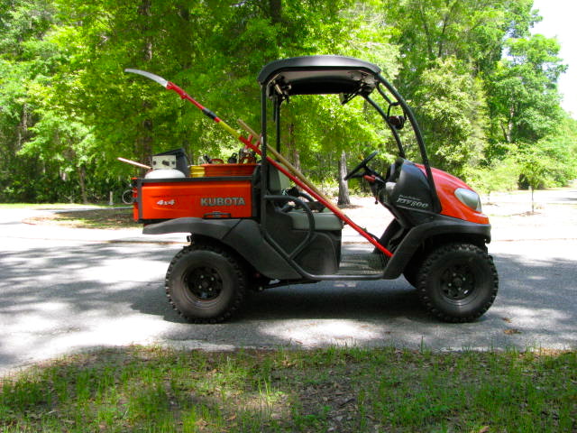

I have been highly satisfied with my gas (16-hp) Kubota RTV500 / $10,000. When you buy a Kubota utility vehicle you are buying the HST transmission, which makes the Kubotas WORKING machines. Carefully consider whether other brands can pull a trailer with 1,000 pounds in it. Most of the other brand's transmissions cannot take it.
My bed is always loaded with tools. The all terrain trailer is for cargo.

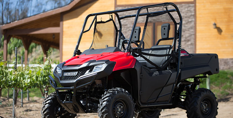

I have a Honda Big Red, it's the previous version to the Pioneer. Over all it's been real good for me. I'll load the bed heaping full of green split firewood and it doesn't seam to bother it a bit. I often will haul about 1/4 cord of blocked up wood down to the house (both in the bed and on a trailer). My land is pretty steep yet it has no problems what so ever. It's kind of a balance between work and play. I will say this, don't get one stuck. I've underestimated snow twice now only to find it was a lot deeper that I thought. I went with the Honda because I was never a fan of belts. Had too many snow machines over the years and replaced too many belts. The 3 speed transmission works well. I would buy another if I ever replace it. I did find that because it's fuel injected when it's cold it starts much easier if you wait for the fuel pump to reach pressure (couple of seconds) before turning it over. Also the battery was kind of undersized. I replaced mine with a car battery.

As I understand it, the Bobcats UTVs are made by Club Car for Bobcat.

Lol, she isn't my wife, literally my neighbor haha. But yes, her main needs are using around their horse farm, and for going on very rugged trails. This took the JCB out after I looked more into it. The kubota and the mules are great machines, but not the off road capabilities we need. I wanted her to get a gator, but we will see what she says about the money.

The advantage of HST transmission over all others is max torque at minimum speed; the reason HST is selected by 90% of people buying 18 horsepower - 40 horsepower TRACTORS. An HST equipped utility vehicle will creep out of and over about anything.
I have had my RTV500 four years. I have never been stuck even though I pull a loaded trailer most of the time. I rarely use 4-WD and have only used 4-WD and had to engage the differential lock perhaps five times.
