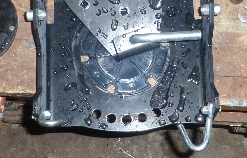

Nice plow be we wore out our KFI angle pin lock out in 2 years. That pin needs to be more than 1/2. Ours is now 5/8. Seen here is the original 1/2 one.
/ UTV Snowplow choice?
Yeah, 1/2" seems too small for sure. I'm debating between Poly and steel blade. Leaning toward Poly. Interesting that the Poly is 87 lbs and the steel is 85 lbs. Seemed weird until I saw that the steel blade is like 5" shorter...

The poly blade also has more steel reinforcement behind it than the steel blade. That and the taller blade make up the weight savings you'd expect from a poly blade.
KFI did do a redesign of what they call the "push tube" a few years ago. That is the assembly that includes the pivot mechanism. I have no idea if the redesign included changes to the pivot mechanism or not. The newer design is built around square push tubes. The older one used round tubes. I've only used mine for one winter season so far, but I just went out and checked: there is zero sign of wear on the locking pin or the holes the pin locks in to. It was not a particularly heavy winter, but neither was it a light one.
We probably don't get the kind of snow that @ArlyA regularly sees in his area. On the other hand, I'd figure 1/4 mile of mostly gravel, uneven driveway would give it enough of a workout to show at least some wear on a system that might give out after 2 years, as ArlyA's did. (I definitely scalped the gravel from time-to-time.) However, I'm running on a much smaller ATV than he has as well.

I should add that our 6x6 with pods has so much pushing power, the 72" blade we have could be wider.
Which may be why you wore out that 1/2" pin so quickly. For heavy, wet snow, I'd be using my tractor, not an ATV, and I can guarantee you this UTV snow plow would not hold up with the kind of pushing my tractor can do.
/ UTV Snowplow choice? #19
We have the Denali UTV version.
OK. Your earlier post said KFI. Your picture of the pin/locking mechanism looks different than the current Denali offerings.
