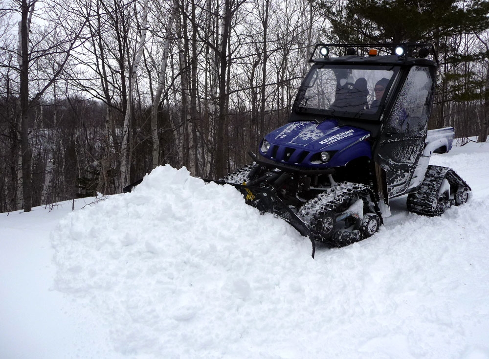

I'm using a 72" Tusk Subzero snowplow from rocky mountain atv on my SxS.
Seems to work fine

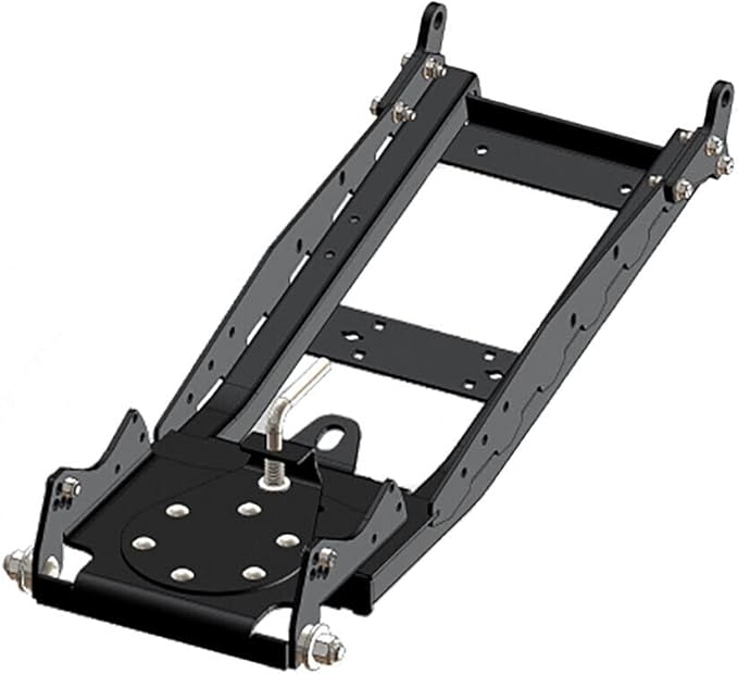

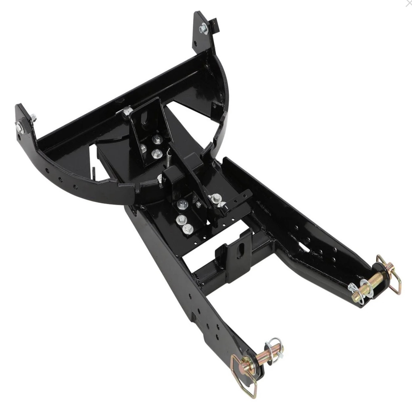

Ours looks like this (as far as I can tell anyway)
That looks more the like current model KFI (because of the square tubes along the corners).
The Denali mechanism looks like this:

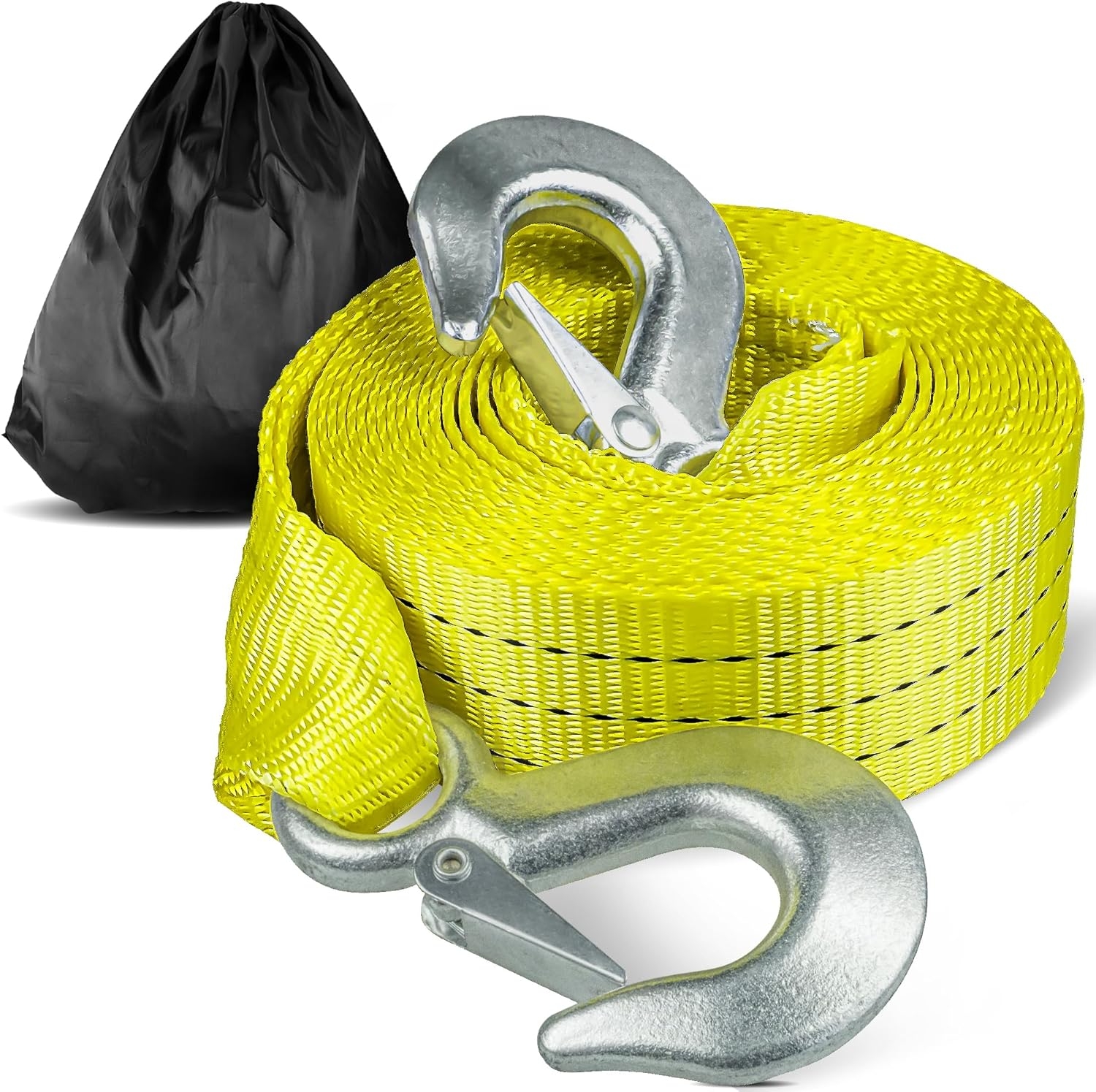

I ended up going with one of their Plow Straps, rather than using the cable on my winch. A neighbor who has been plowing with his ATV for years mentioned that he does wear the end of the cable more quickly: it's a lot of in and out motion over just that last short length of cable, and depending on how your angles work out, it can be a sharp bend. Replacing the cable with the strap is supposed to hold up a lot longer. The downside is that you have to change from cable to strap at the start of snow season, and back again at the end of the season. The strap is also only 64" long, so you lose the ability to do longer winching while it is in place.
I also added the optional plow strap roller. It mounts down on the push tube. The strap runs down from the winch, around the roller, then hooks on back up on the bumper frame. This cuts the line speed in half on the winch (as well as reducing the load by half, not that the plow is a heavy load for the winch). The diagram at the link probably describes it better than I am. If you like that slower action on the lift, but don't want to go to a strap, you can do the same thing with one of their plow fairlead pulleys (These can mount on your fairlead, so the cable does not bend as tightly, or down on the push tube, where it works like the strap roller.)
The straps or extra rollers are something you can easily add later, if you try the standard set up and decide you want to make a switch.
One other word of advice: if your Ranger 800 has larger than stock tires or a lift kit, you will probably need one of their push tube leveling kits. These compensate for the higher mounting point of a lifted UTV in order to keep the pivot geometry of the plow properly aligned. Which kit you need depends on how much lift you have. If you have stock diameter tires and no lift kit on your UTV, there is no need for this addition. My local KFI dealer was not too familiar with how this works on a Honda (they are not Honda dealers), so I emailed KFI directly for some input on choosing a leveling kit size, since my tires are bigger than stock.

I switched to a 10ft strap and never going back to cable ever, even in the summer. I get about 2 years of snowplowing before it breaks. No big deal. I believe they are 20ft, 8000lb towing straps and I cut in the middle. Like this.

Ha! I cleaned the drum and used exactly that. Been holding for like 6 years :LOL: (do replace the strap every 2 or when it breaks) Duck tape does fine.
