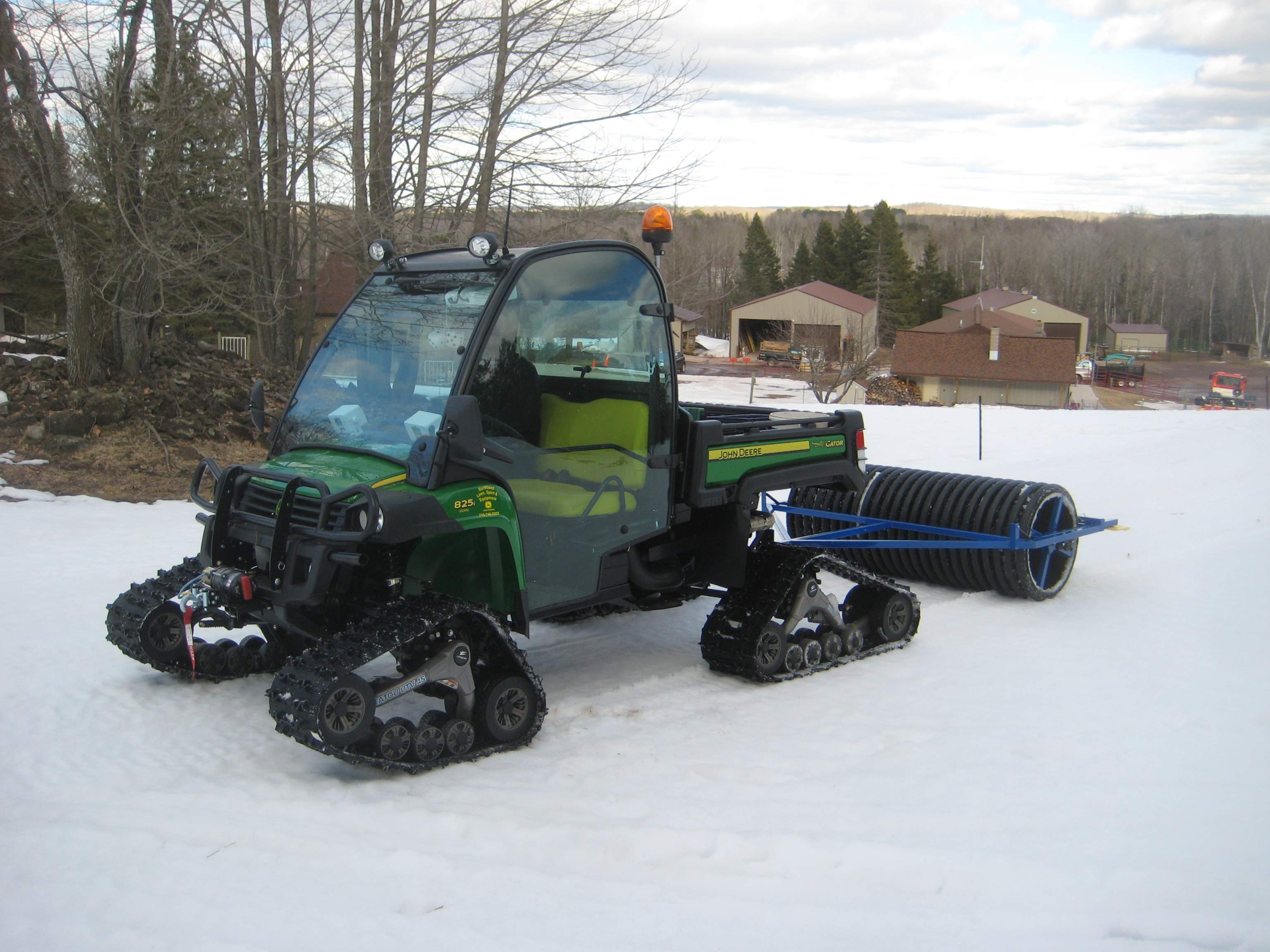

The Gator noise on the new 825i (XUV) is not an issue. We have used them with and without the cab.
