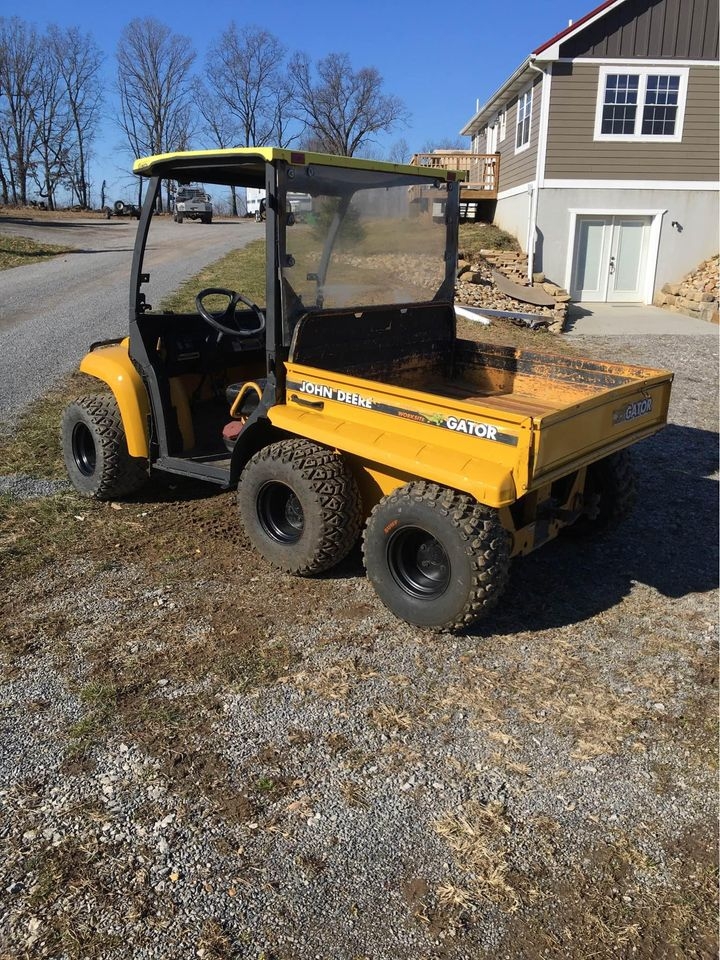

I still want a old school Gator 6x4 diesel with a Curtis cab, but I heard vital parts are now discontinued? I was going to buy one for sale locally on FBM, but my JD parts guy thinks I will have issues with finding some parts.
The new version of the 6x4 looks like it’s built out of Tupperware (n) , but still has similar drivetrain.
Wish I had more real useable information.
My old 6x4 was fun. I have a NIB clutch, belts etc on FB marketplace if u ever have a need.
Ditto on the foreman w solid rear axle. Friend has one. The older ones are referred to as the “f250” of quads. (That is supposed to mean tough and dependable lol not fix or repair daily!!)
I would jump on an old one priced right

It’s funny because the parts guy was telling me the “low speed” clutches were a part no longer in production.
Would you recommend the Gator 6x4? I would be using it for work on hilly fields. No need for high speed. More work, pulling, etc.

A neighbor had one, it would pull and go like a bear, in a straight line. With a load in or behind it and especially on slick surfaces it wouldn't turn worth a dang.
The old Suzuki quadrunner with the Hi, Lo, and super low would out run and out turn it every wheres.
