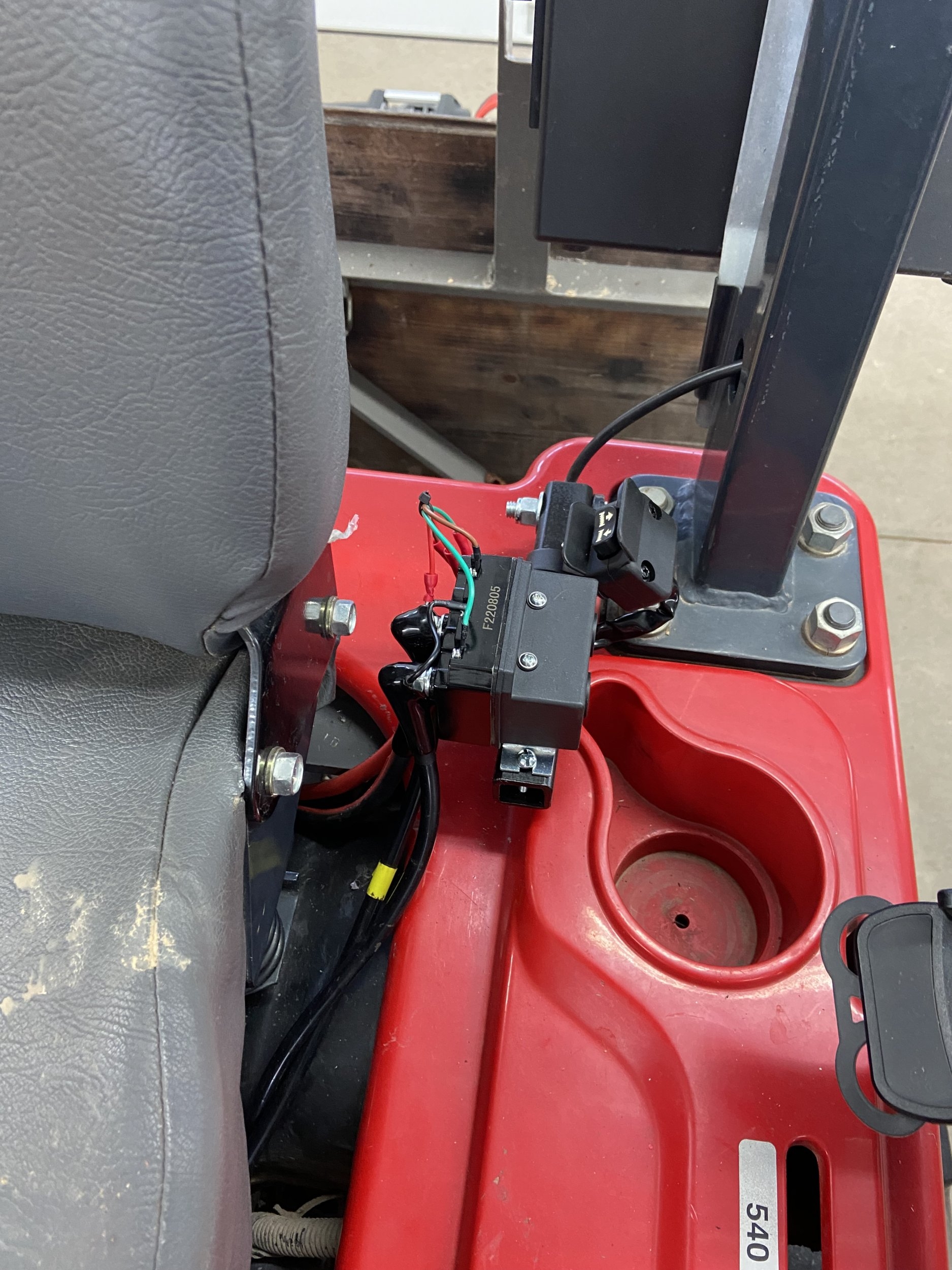

Finished it up yesterday. I still plan on buying a quick connection at some point so I do not need to remove the cables so much.
