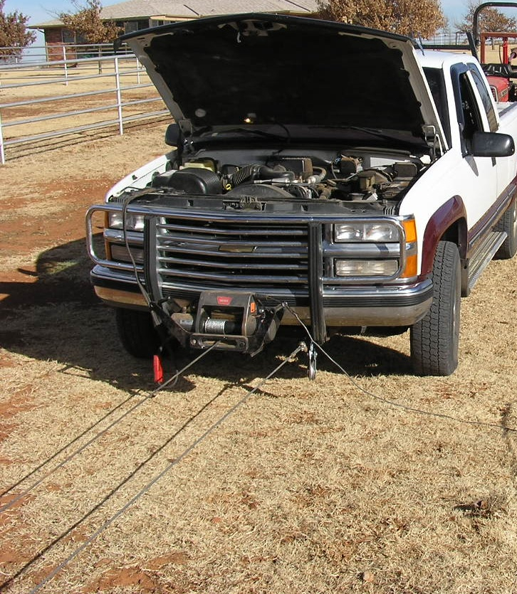

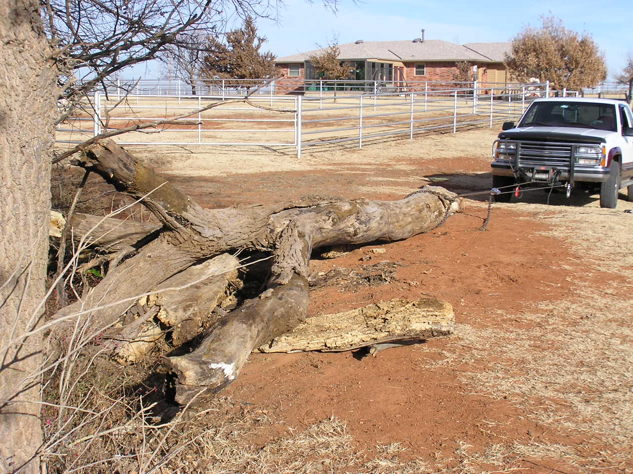

/ UTV Winch? #26
Did the Massey Ferguson 240's backhoe hold the truck in place?
No the backhoe wasn't on then.
There was a chain from the truck to the tractor.

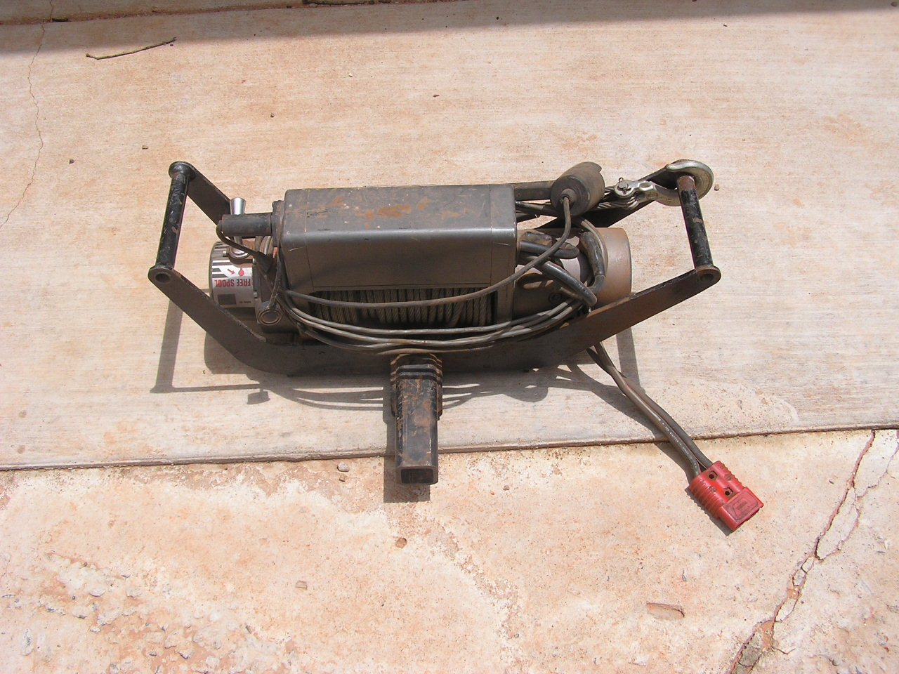

Had 3 Warns (old Belleview 8K, 8274 and now a XD9000i on a multimount. Pleased with all of them with the small exception that the old Belleview was power-in only. However, after watching many vids of Matt, Fabrats, Casey and others I wouldn't hesitate to get a Harbor Freight 12K. Can't beat the price and it looks like they work fine.
Connections are via 2/0 welding cable with crimp lugs and 300A Anderson type plugs.

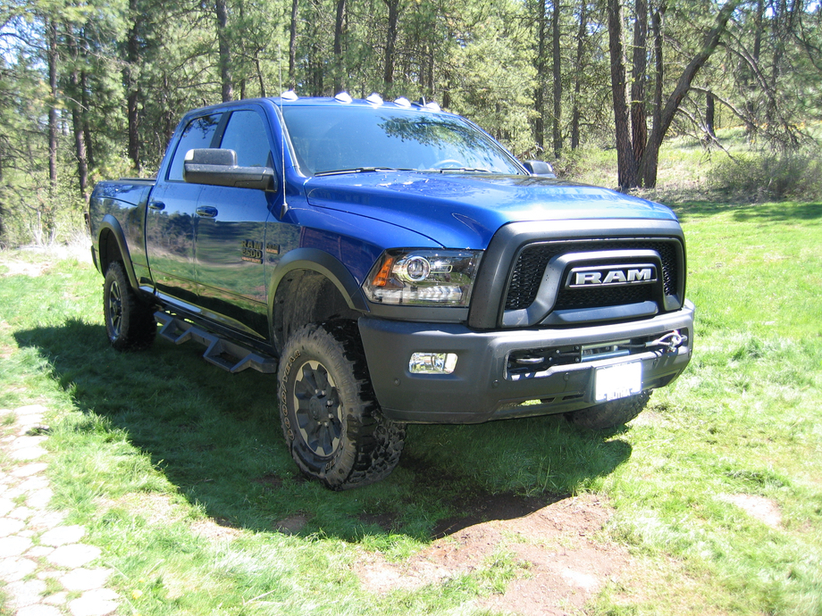

Mile marker two speed 10,500# hydraulic winch off the power steering pump. Continuous duty. High speed quickly deploys or retrieves cable. Use mainly to control the fall of trees off fences, property lines and around buildings.
/ UTV Winch? #31
Is that the right picture? where's the winch?
/ UTV Winch? #33
If you zoom in you can see the fairlead in the front bumper. To pull a tree have to anchor the truck to another tree or tractor with grapple or bucket in the ground.
Never been impressed with several of the electric winches I’ve used for other than self recovery.
Hydraulic winches are scary strong.
PTO winches have serious muscle.
