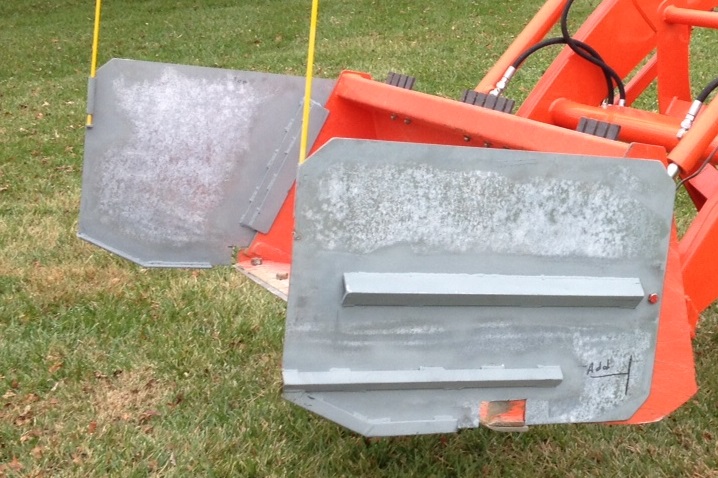

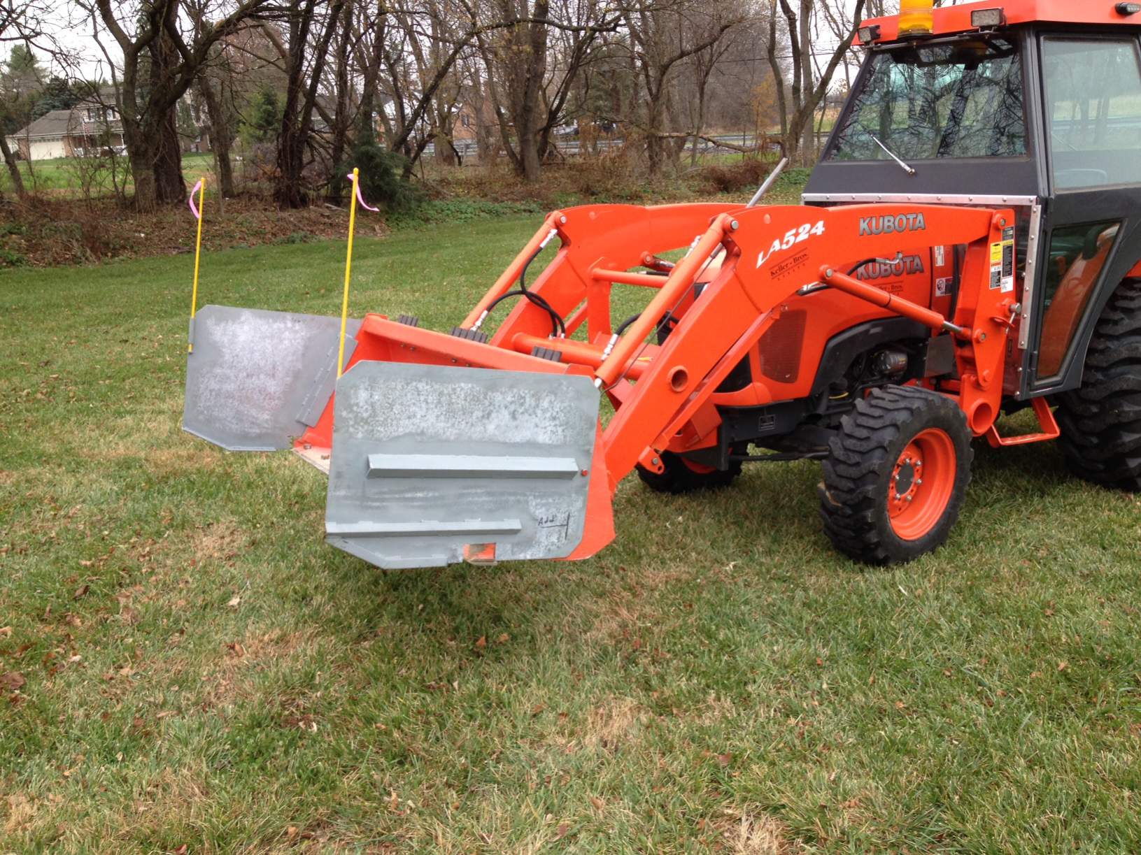

I made side shields for my bucket. Easy on and off with one bolt.
