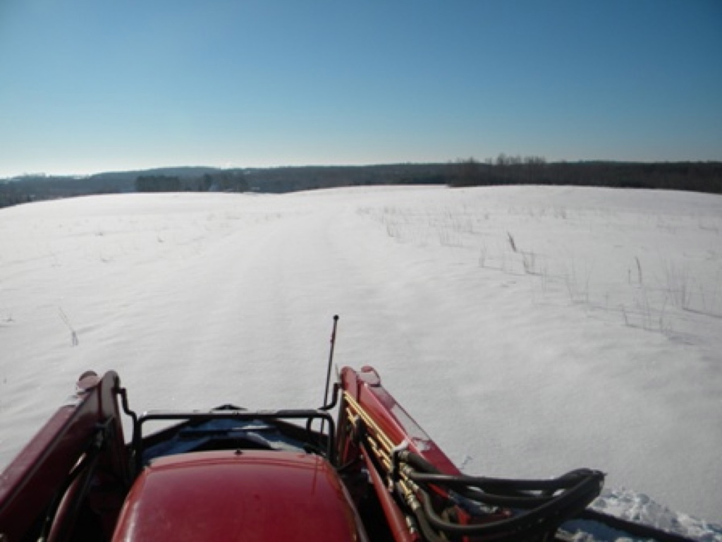

I have a 1200' driveway, so I feel your pain.
I actually went with a snow pusher last year and was much happier. The problem with plows is you eventually build up mounds on either side of the drive and you then have to get rid of them, because you can't push any more snow to the sides. With the pusher, I can get rid of lots of snow and move it off the driveway and away from the edges.
I am backing it up with a PTO Snowblower as well.
For lighter snows, I use my Mule with a plow.

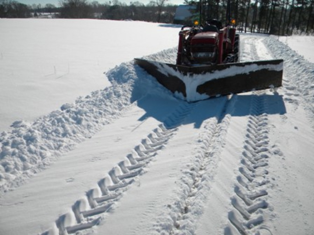

I think the snow pusher is a large light duty box blade made for snow. It has runners it rides on and collects snow in the box. I think it would work good for a parking area or area between buildings with limited pile areas.

A snow pusher is basically a three sided box. When I am pushing the snow off the driveway, and the box gets full, I just continue to the side and push it off 10' or so, leaving me lots of room for more snow in the future.
I have a 7' pusher on my Mahindra, and you would be surprised how much you can load up in that thing. I am one to fight the snow as it is falling. If I get on it with 3"-6" of snow, I can push the majority of my driveway with 2 or 3 loads.

I bought it off a guy who fabbed it. It is 7' wide and when it gets deep, it is a bit much for the machine. So a 6' unit would be easy work, regardless of snow depth. I think an 8' would be too much.

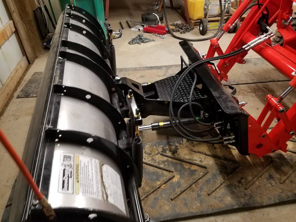

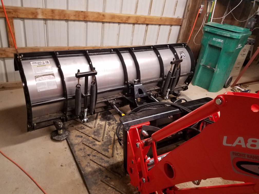

I could live without a v-plow, or beer. But I wouldn't purposely choose that kind of life. 20180225_154330.jpeg

Tractor FELs are not designed nor built to PUSH heavy loads. Something will buckle if your push regularly.
The forces applied to the FEL arms pushing a snow plow, do not differ from those exerted when driving with the bucket down, and pushing the bucket into a pile of dirt. And, they are most defiantly designed to do that.
Yes, there is a possibility of the plow hitting something and damaging the FEL. Just as there is a possibility or the bucket hitting something, and damaging the FEL, when using that. Or, a frame mounted plow hitting something and damaging everything. Any use of a tractor, carries with it, the possibility that some sort of damage can occur.
If the plow is sprung properly, it will actually trip and completely prevent damage, in a case where the FEL bucket could not do so. This is why I would rather have a plow, than a snow pusher.
With a proper set up, and reasonable care, it is most certainly possible to plow snow with a FEL mounted plow.

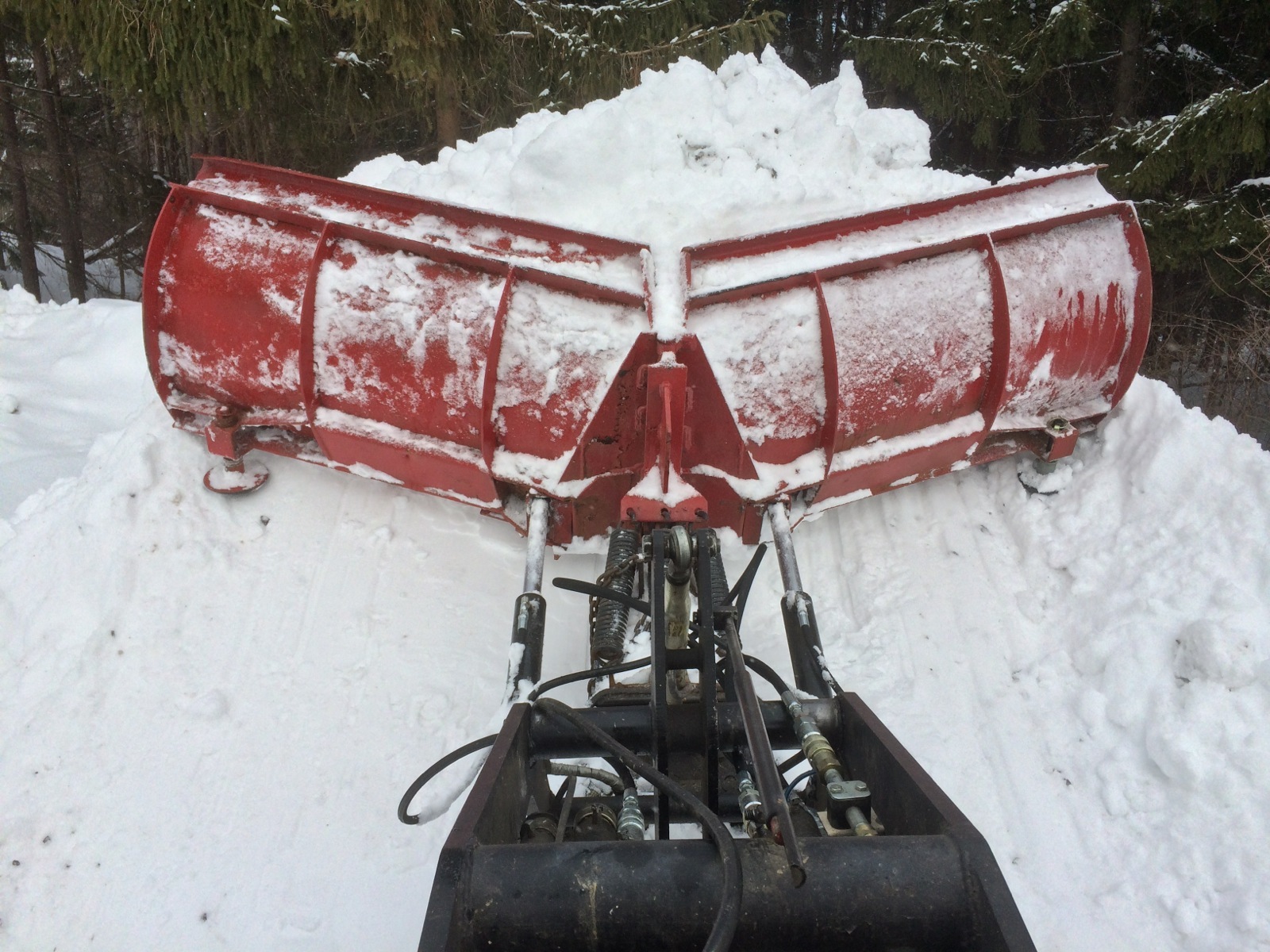

Been plowing snow with my tractor and FEL mounted snow plow for many years. (9' power angle truck plow converted to SSQA on my 35 HP tractor with chains on all 4 tires)
No issues
   / V-Plow for FEL #34
Nice, did you build that? How wide is each wing?
No, that is a commercial unit manufactured by FFC. Each side is 4 ft. It has a sequencing valve so both wings are controlled by a single hydraulic circuit. I agree that it is possible to damage an FEL plowing snow, but I've used this plow in pretty tough conditions (we have lot of rock, pretty much all over the place) and I haven't had an issues, so I think if you're reasonably careful its worth it. I could make my tractor and attachments last nearly forever if I left them parked. :laughing:

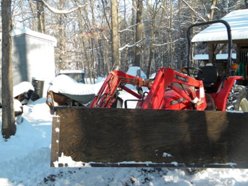

I made side shields for my bucket. Easy on and off with one bolt.
