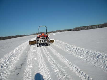

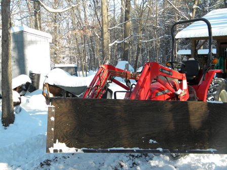

You might try making your own like this one. Using 3/4 " marine plywood , oak, treated lumber, and steel this will open an 11 ft wide path in one pass. I am using a 35 hp Century 4wd tractor. So far the deepest snow I have tried is 8 ". But I feel certain I can move double that with the V angle at 45 degrees. Cost is about $200. In this part of Va. we do not get too many deep snows. It is no problem to reduce the width to 8' which would allow some serious depth to be moved. Hardest part is to make a mount that fits your particualr front end loader. Willie Jones

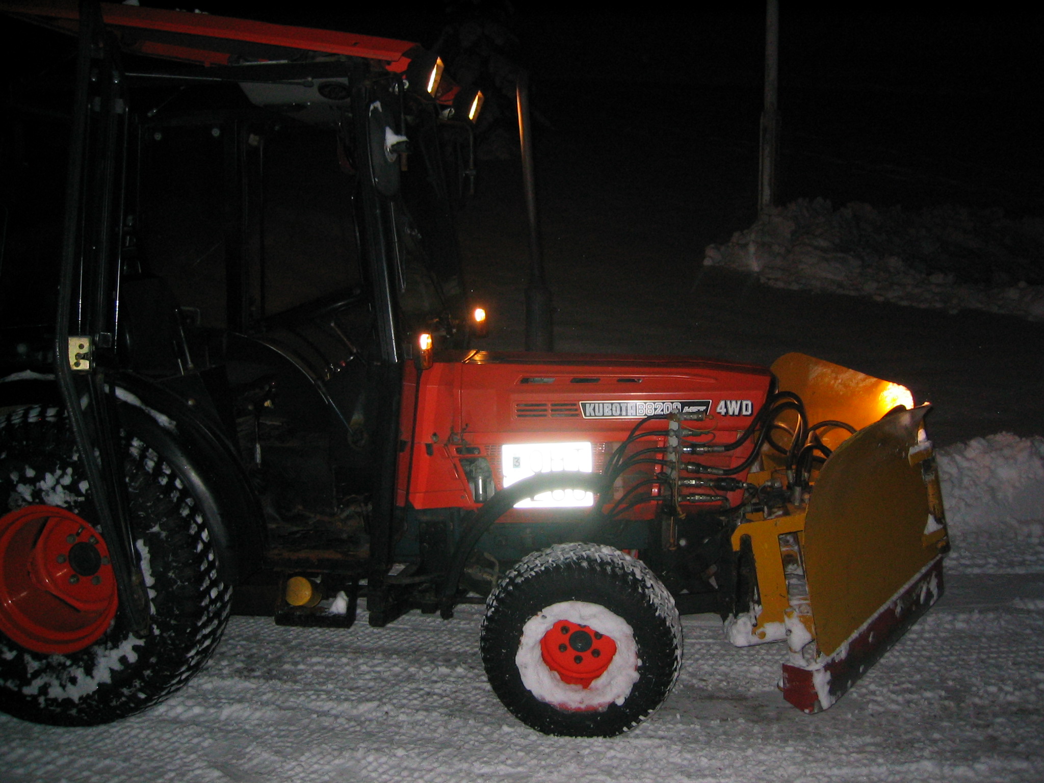

I used to run a P.Olsson plow on a Kubota 8200. See how close to the front of the tractor it fits.

Willie Jones- That's a nice V plow you made, and it looks like it moves some serious snow ! It's about what I envisioned making for my tractor.

............I used to run a P.Olsson plow on a Kubota 8200. See how close to the front of the tractor it fits.
/Marcus
Marcus
I like the looks and the fit of that V plow.
Would like to see some vidio of that plow working some serious snow. But alas, you say you used to run it and apparently don't anymore. :(

Thanks William, I suspect if we get one of the really deep >16" snows that show up here in central Virginia every 10 years or so I may find I have to reduce the width. Would like to see, but most folks around here do not share my enthusiasim for such a snow! Those adjustable V plows do look nice. Willie Jones
