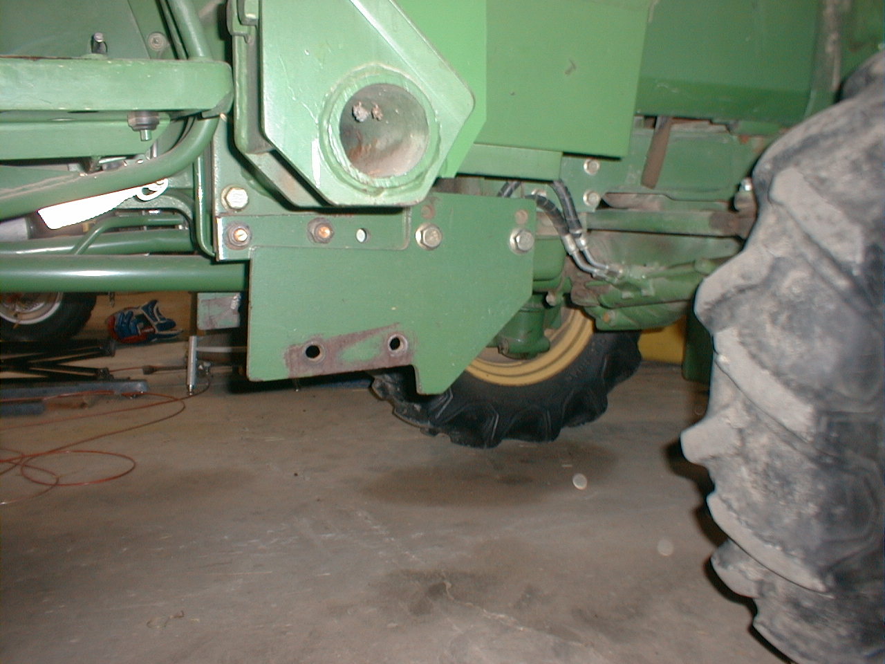

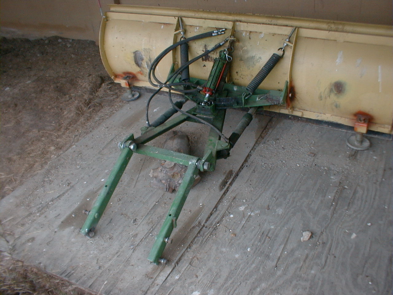

Here ya go. This rig has now been through over 20 Winters unscathed. I even use it to plow the crushed asphalt back into shape in my driveway. In the deepest snow we've ever had (here in Michigan), I can run in high range and third gear maxed out.
I bought the plow at a garage sale for $100 and then fabbed up brackets dropped from the 1/2" steel MMM link points to emmulate a truck plow mount. The height of the two attachment points must match that of a truck's mount for proper plow operation. It easily handles side loads (which I would have figured are the design's weakest feature. I added two extra trip springs because it needed them to satisfy my needs. I use the loader hydraulics for up/down and swing left/right. Extra weights on the tractor and raised the OE weight bar a few inches to eliminate the trip spring interference with it. Only custom work I did was to cut down a cylinder I already had to fit under the weight bar for lift and downforce. Yes I use downforce to break ice and clumps and any other road irregularities. This is necessary at the garage doors where wheel packed ice has formed from the cars running in and out. I like the plow close for steering and maneuvering. I can zero steer in using the separate left/right brake pedals.
I use the mushroom type skids set to raise the plow about 3/4" above the roadway. I use the steel plow scraper blade. I always wait for a little snow and ice to pack down before I attack any major snows because I don't want to rake the stone back onto it in the spring. Heck I even drive through the pastures with this rig to clear a lane for walking and winter golf cart trails. Maybe I'll throw some garage sale paint on it this Fall...
On and off involves 4 nuts and lock washers, two bolts, a pin and the hydraulics. The two drop arms have large rod end swivels on them to help with the hookup. This usually gets done when two people sit together at breakfast or dinner and both say the same thing at the same time: " Guess I'd better put the plow on".

I'm impressed with what you have done with a $100 blade. It's everything a blade should be. Nice job.
