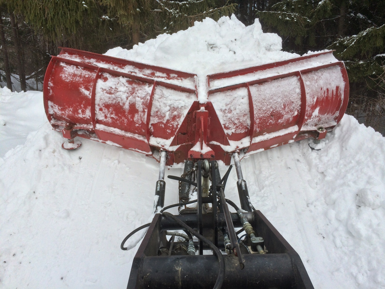

Even with my CUTs, I mounted the plow on the loader arms for that reason, to rapidly pile snow high and to push back piles. The negative was, since I did not have quick attach on the loader, the plow stayed on the loader for 5 months of the year so no bucket for 5 months of the year. With the PT, I take the plow off after each use so that I have more room in the barn.
For those that do not look at the web link, here's another picture (that pile is over 6' high and I am now adding almost 2' to it):
Ken

A fearsome machine. Great build and design, and many thanks for sharing the photos. It looks even better than I imagined.

Do you have any relief valve on the plow cyl in case you hit something?

There are springs on the plow that take a lot of the abuse. I have never seen a plow that flops around like this one. Going down the road, it is bouncing around by about 12". There is no added pressure relief - I have just hooked up to the hydraulic circuits of the PT with all of my plows for the last 6 (?) years without any known issues. I certainly have hit logs that were buried in frozen drifts. FWIIW, I bought a Curtis setup for one of my CUTs and it did not have a pressure relief. But I can imagine there are some interesting pressure spikes when hitting something.
