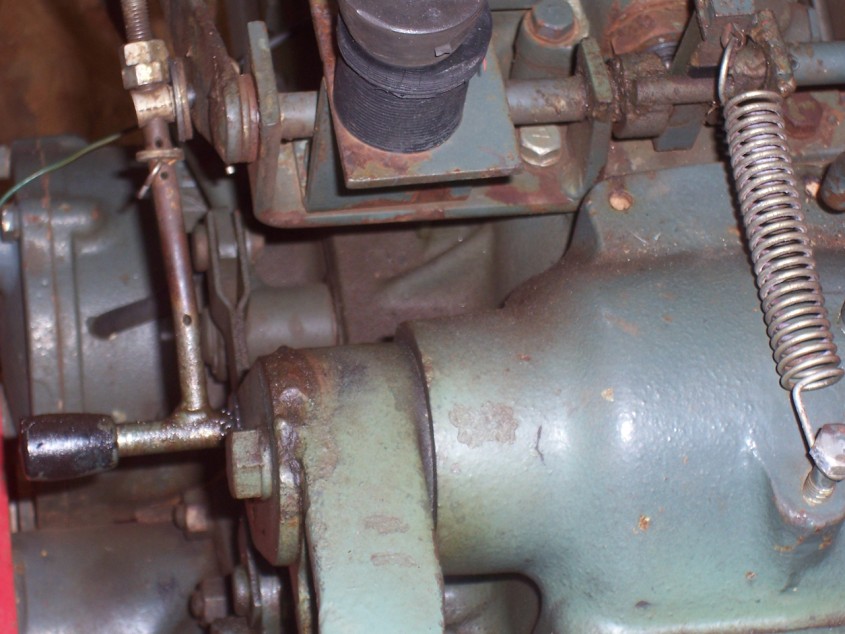

THANKS Winston - I spoke to Hoye the other day and they said that it was more like number 1, but mine sure doesn't act like that and honestly, I like the ability to raise it up in increments so I am glad to hear that its number 2.
Hoye did confirm that when the 3pt hitch is up and wanting to move upwards and cannot (like mine) and the loader bucket is calling for fluid, that it could be dead heading which is not good. So I am going to try to make that adjustment this weekend...Thank you for the photos too!

If I'm understanding this correctlly :ashamed: Easy Fix even for me. When your Arms have "Almost" reached thier highest point that where you set the Adj. nuts on the Cam to your Linkage to pull the plunger away from the Hyd.valve. No mention of this Adj. All you need is a pair of pliers.

He said that when I pull up the 3 pt lever, there will be a point (he said about halfway) where it will raise all the way to the top. He suggested I install a screw or something similiar to stop the lever or adjust the linkage. I intend to adjust the linkage and if that won't work - some sort of stop mechanism is next!!
