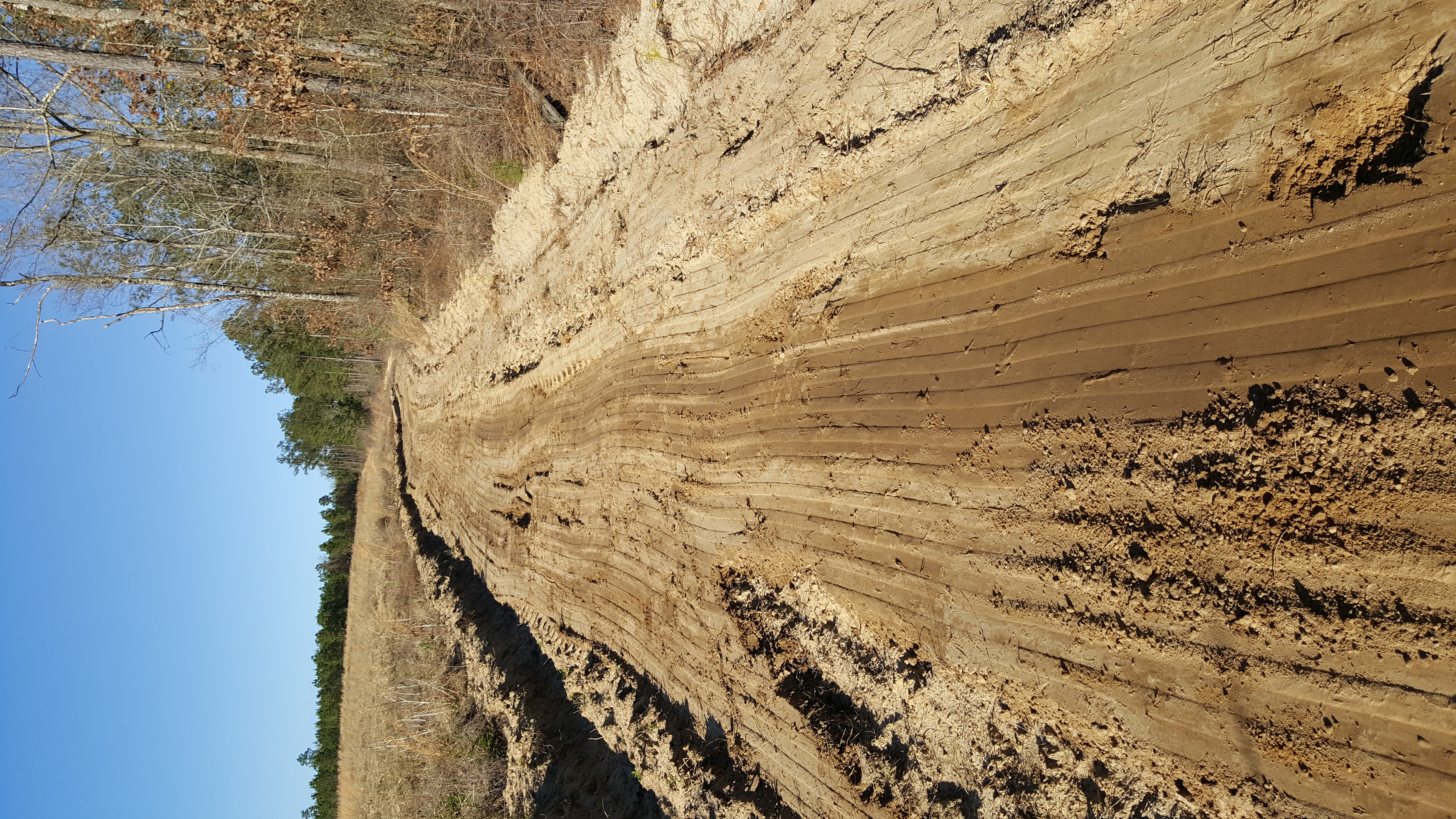

Pushing over 12 inch or bigger oak with danuser intimidator. The v519 is an absolute beast. So strong and solid. Wonderfully capable machine. So much stronger than I thought it would be. Boom is so solid I don’t worry about it. Even turning while pushing 7ft bucket. No problem. I plucked a 10 inch pine stump after rocking it a bit. If there is a job this thing gets her done
