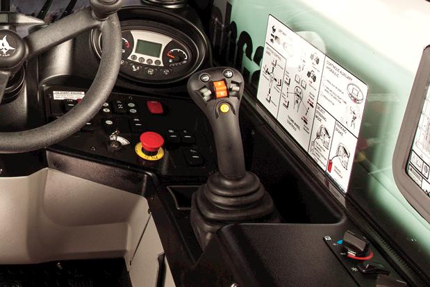

I was clearing with my grapple today. I made a big pile at the top of a steep hill. I pushed the large pile down the hill in 3 different passes. The hill is steep enough that the V519 had to work to reverse back up the hill.
After the 3 passes, I went to grab some more brush. I clamped down the claws and turned around to look behind me as I put it in reverse. I heard/felt the grapple open back up. Thinking that I must of opened it up by some sort of autopilot reflex glitch (had other things on my mind), I clamped it back down again. Sure enough, it automatically opened back up again. I looked at my aux hydraulic button and the 2nd light was on (never seen it on before). I turned the aux off and back on and it worked fine again. Anybody know what that 2nd light is and what sort of gremlins I might be up against here? I plan on calling the dealer tomorrow.

That 2nd light should be explained in the operators manual. It is different than my V417, so my service manual is no help.

On mine, I think if I push the aux hydraulics button once to turn it on, for my bush hog, it only turns in one direction (pulling the aux lever towards me). If I push the button a second time, then it can turn the other way (pushing the lever away from me) I don't remember what happens if you push it a third time, but I think that turns aux hydraulics off again.

Sorry I was gone so long. It was a false alarm. Turned out I accidentally tapped the trigger on the front of the joystick while I was opening the claws, raising the boom, and putting it in reverse at the same time. Tapping the trigger kept the opening action going. Operator error!

The 2nd light must be continuous flow.
