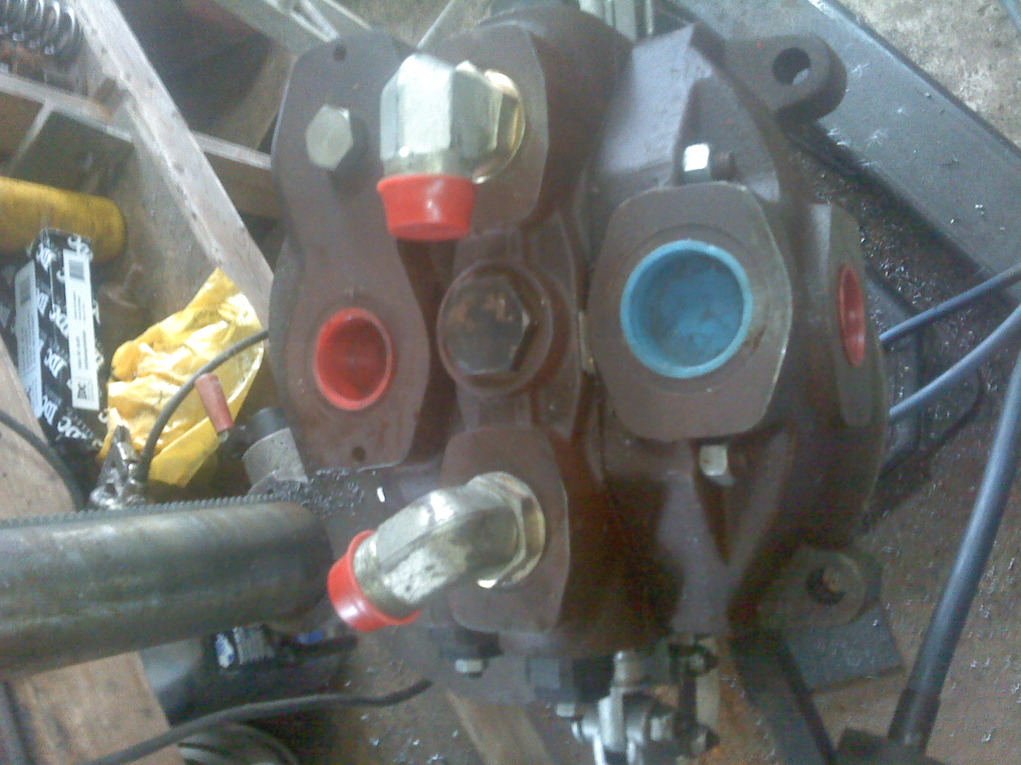

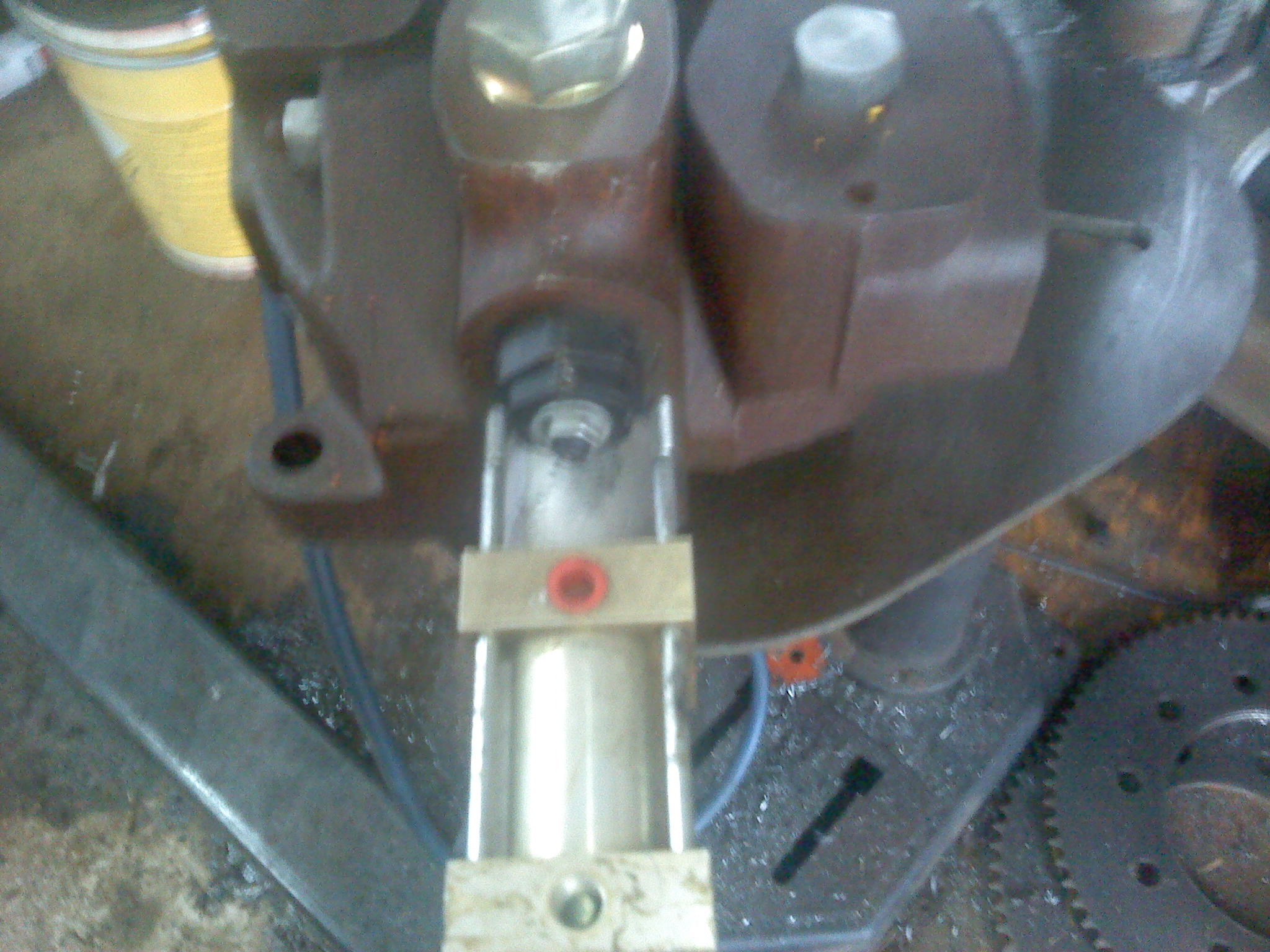

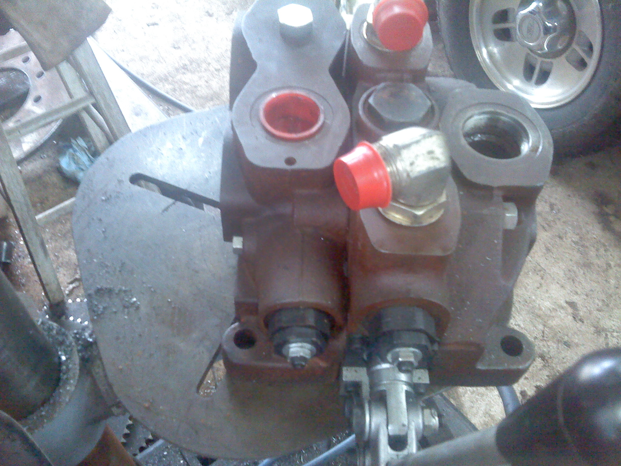

I have a parker v70, model v70-248-G, air shift and lever shift control valve. I got the valve out of a scrap bin but it is a new valve never been mounted on anything. Supposely the valve is open center, but i have been also told it is a closed center. Both fellows telling me this should know, but neither is really sure. 1002151508.jpg The red cap on top of the valve is In, the blue cap is out, the ports with fittings are A and B. There is also another port on the side of valve, with another red cap that is not marked. There are reliefs for IN port as well as both a/b ports 1002151507.jpg 1002151506a.jpg. I can blow air in the IN port, but air doesnot come out the Out port. Ok looks like closed center, but instead of air coming out the OUT port, it comes out the port with red cap on side of valve and below OUT port. there is a plug between the out port and side port that can be removed. Power beyond plug????. If I hand shift valve, air seems to come out the a/b ports, but the in port is so lagre, I cant really tell if anything is coming out of the A/B ports, but I can hear the air change directions inside the valve and only reasonable suggestions is that the air is passing thru the A/B ports. Air is not coming out the side port or the out port when valve is shifted. I dont know what to make of this valve, I am thinking it is indeed a open center valve and the plug between the out port and the side port is for possible power beyond. On the other hand, the relief on the in port could be for pressure sensing and might be set for 650psi for use as a closed center valve. Need a little help with this one. I thought about just finding some fitting and hooking a water hose to the IN port, with such large ports, it hard to get enough air flow thru the valve to really tell whats going on.

I am wanting to use this valve on my firewood processor that I am building. I intend to use the air shift with a foot pedal to operate the twin cylinders of the splitter. Oil from valve will return to tank with no power beyond being needed. If the plug between the out port and the other port is for power beyond, and I am not sure that is its purpose, but if it is, will I be able to just remove the plug, cap the extra port and just plumb the out port to tank? The plug between the out port and the extra side port can be seen by looking into either port. Also, need some clarity as to why there are what looks like adjustable reliefs on the IN port, as well as the a/b ports.

Thank You Stan!!, I have searched the Parker sight until my eyes blurred and never found those two pdf files. Which I just promptly downloaded and saved.
From what I can tell, the valve is easily converted from closed center to open center by simply using the conversion plug that is installed between the out port and the extra side port. For normal open center, you just remove the plug, cap the extra port and plumb the out port to tank. For power beyond, you leave the plug in place and plumb extra port for power beyond and the out port of excess flow to tank. And for closed center, you leave the plug in place and cap the extra port, with out port being used to return to tank. For my use, it looks like I just remove the power beyond plug, cap the extra port and use the out port as return.
I guess that sort of explains why my two knowledgeable folks, that have been telling me the valve is open center and closed center, where both correct, it just depended on how the valve was plumbed and what the application called for.

The options for plumbing were for when the valve was ordered from Parker. The way you have it now (unless it was changed later) would have been the options/configuration chosen when it was ordered. I don't think they were intended as DIY options....there may be more to it than you describe. I would check with Parker to make sure any changes you want to make, will work.
Each option has a code letter or number. If you can find them stamped on the valve, then Parker should be able to tell you exactly how it configured.
