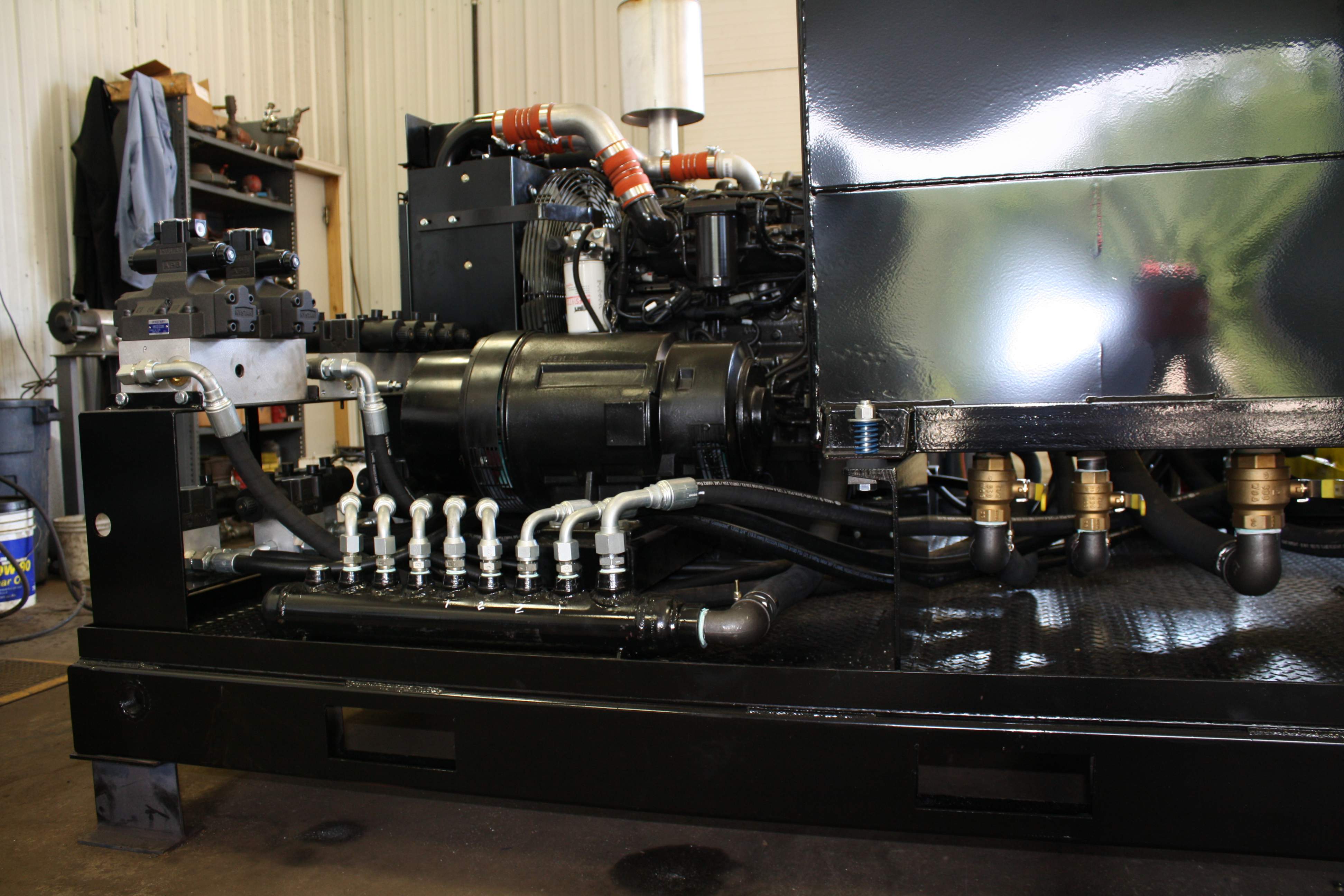

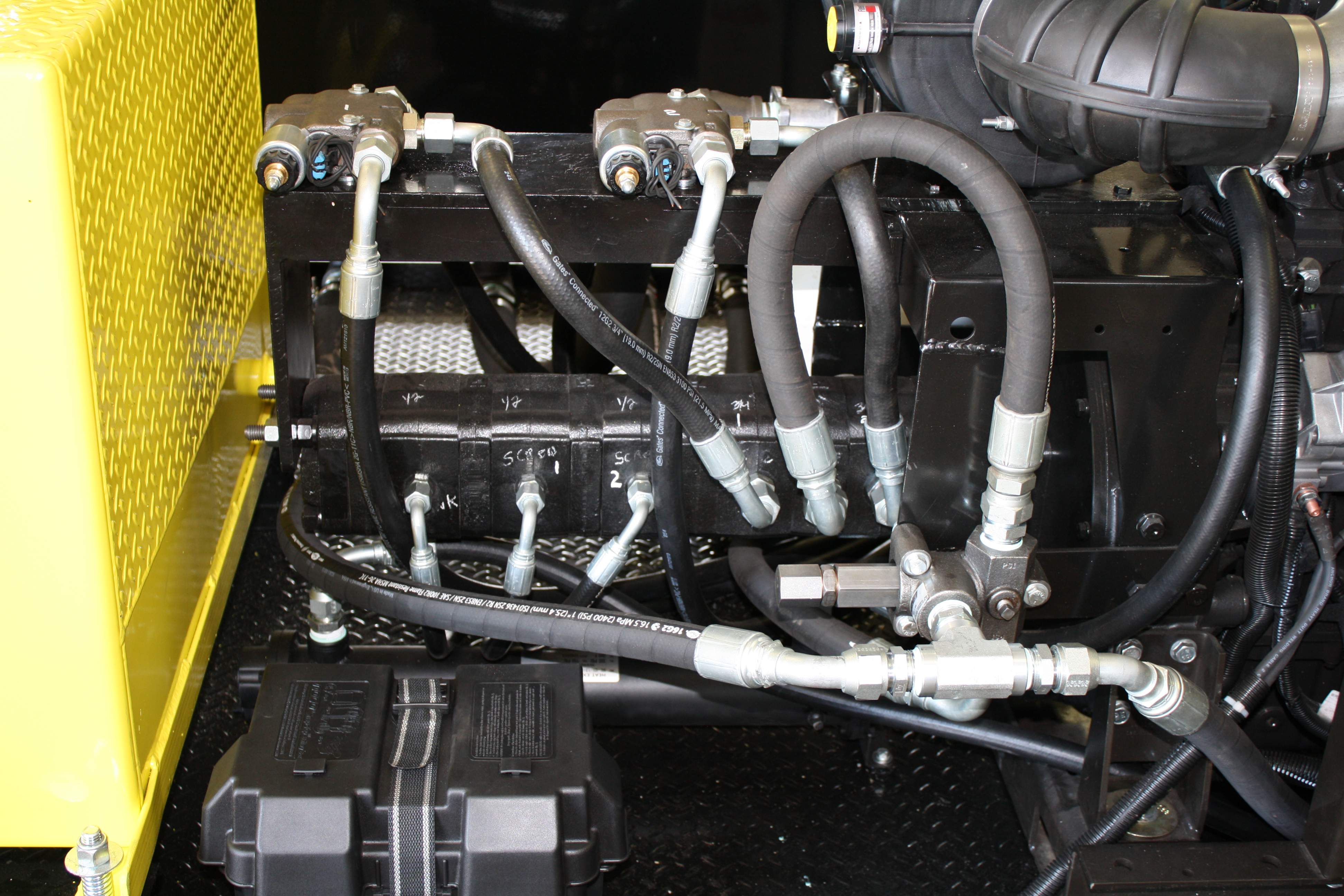

The best way you can do this is by having a dedicated pump circuit for the saw and the splitter. Then you can use another circuit to operate the remaining functions. You may need a 4 or 5 circuit pump. Adding a circuit to a pump is cheaper and more efficient than trying to split hydraulic flow. I do this quite a bit and I will not use flow dividers unless I absolutely have to. IMG_0111.jpgIMG_0115.jpg The power unit pictured has 6 separate sections and can run 10 different functions. 6 at the same time, if I remember right total flow is 120gpm, 175hp power unit with 8k AC power. The total use at one time does not exceed 150hp so this size engine is sufficient. Over the years I have learned to stay away from flow dividers for high flow systems. CJ
