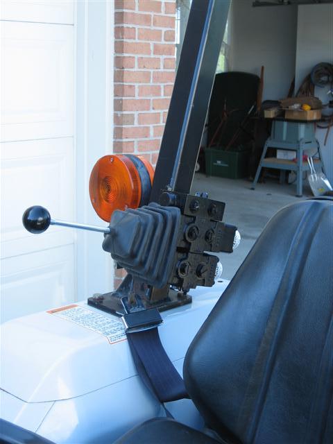

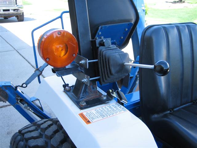

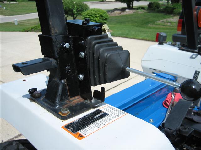

Well, I received the valve but my tractor was still in storage at my sister's farm. Finally brought the tractor back home the other day so I can work on this project. Played around with a few locations for the valve and think I found one that works pretty well. The first two photos show the valve held in position with a couple temporary straps. In the final installation the valve will be level instead of tilted up like the photo. Seems to be a comfortable position when sitting in the seat. Easy reach without being in the way. Now to work on a mounting bracket. Unfortunately my metalworking skills and tools are not on the same level as many of yours, but I know just enough to be dangerous;) Should be fun!

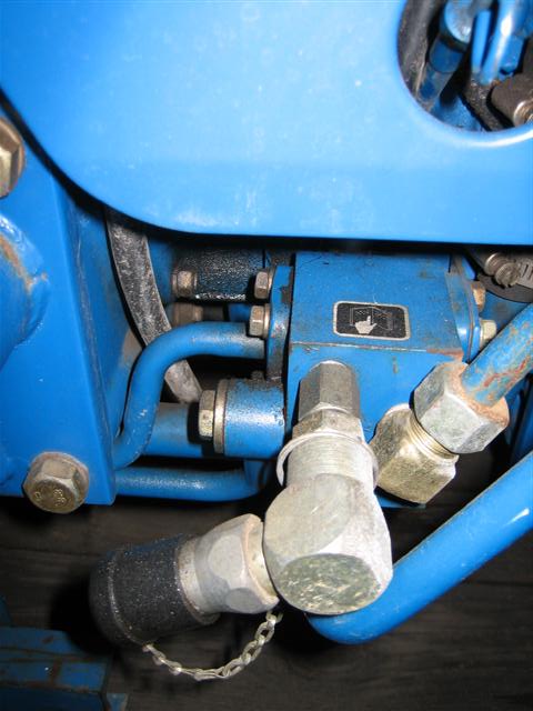

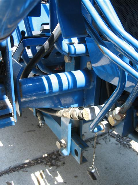

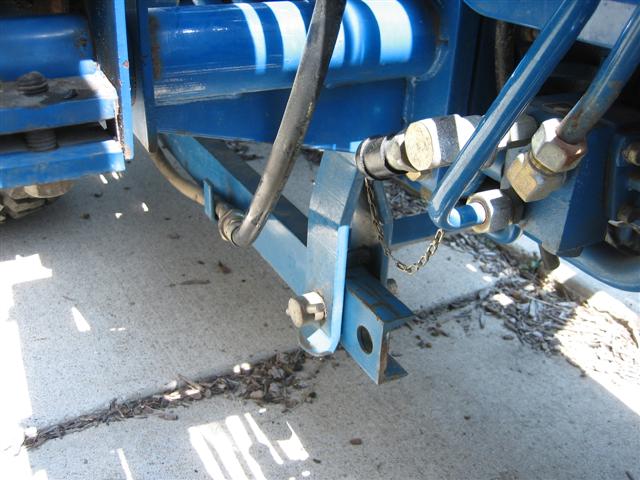

I will also be installing a selector valve on the outbound PB port from the new valve that will direct flow to either the backhoe or the 3pt. This is similar to how the tractor is currently plumbed. There is a hose coming from the FEL PB that either connects to the backhoe or plugs back into the manifold (3rd photo) on the side of the tractor to power the 3pt.
After seeing where everything was going to be mounted I went through and figured out all the connectors, adapters and hoses I would need. I placed an order with Discount Hydraulic on Friday. Because I'm not exactly sure where all the lines are going to be routed I am going to try reusable fittings so that I can make the hoses myself as I see where they will fit.
Have a nice day everyone!
