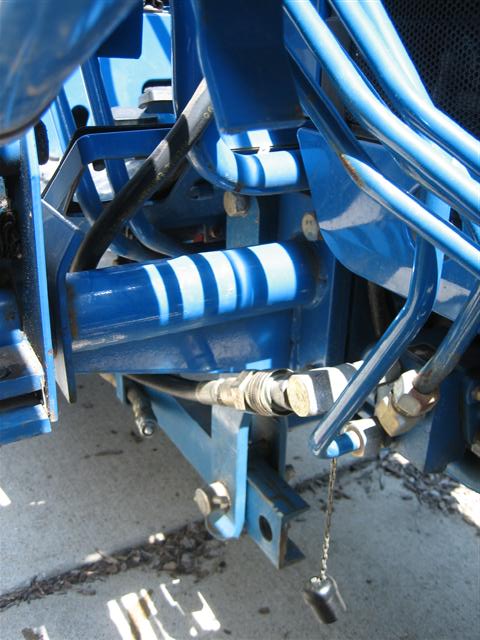

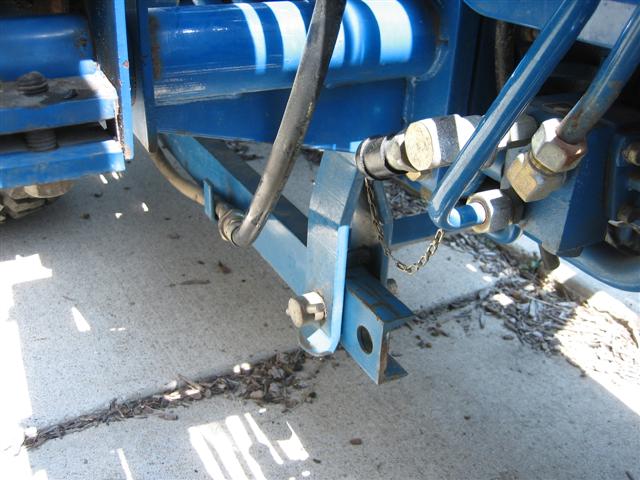

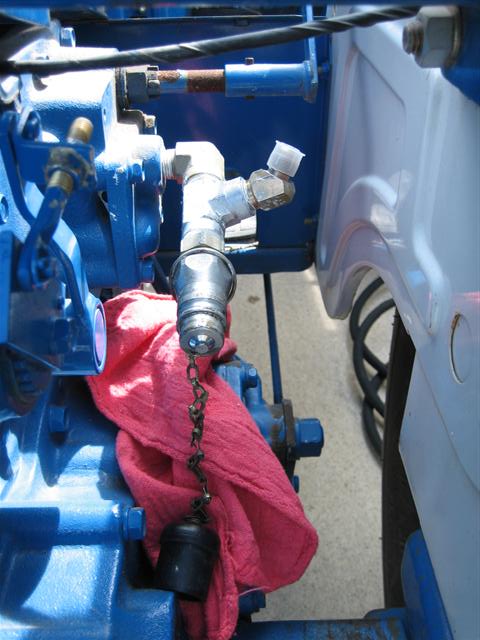

The reason I thought I needed a selector is because currently when I hook up the backhoe (subframe style) I unplug the FEL PB line from the manifold on the side of the tractor that feeds the 3pt system and connect it to the input line coming forward from the backhoe. This disables the 3pt system (which I believe is downstream from the FEL) while the backhoe is attached. When dismounting the backhoe, the PB line is disconnected from the BH input line and reconnected to the manifold, which re-enables the 3pt.
The first photo shows the PB line connected to the BH line and the second photo shows the PB line reconnected to the manifold.
In the new installation I am treating (hopefully correctly) the PB coming from the new valve in a similar fashion but just using a selector instead of disconnecting/reconnecting lines. One output side of the selector would be a QD for the BH to hook to and the other output would be plumbed to the manifold. Position the selector in one position and the backhoe is powered, move it to the other position and the 3pt is powered.

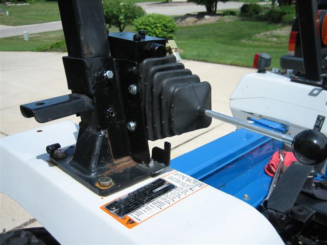

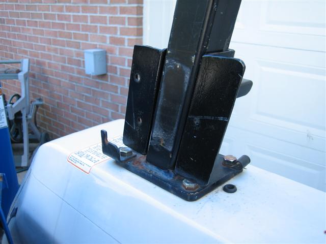

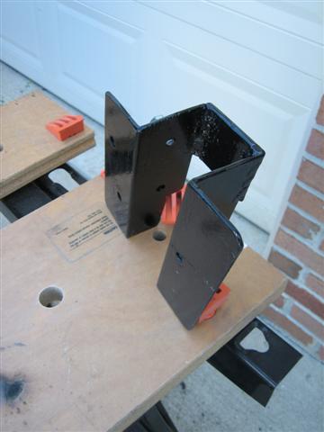

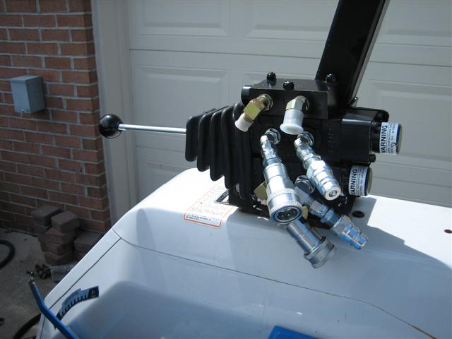

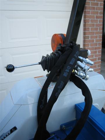

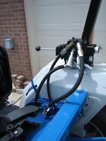

Well, I finally got my valve and rear remotes installed! :D Took a little longer than expected, had to change plans a couple times, you know ... typical project. After I received my valve I decided on a mounting location so that I could then figure out where I was going to run all the hoses.
Pictures 1 and 2: Made a bracket that would wrap around the ROPS so the safety police wouldn't get me for making any modifications.
After deciding on a valve location I ordered all the fittings and hose from DHH. While waiting for the parts to arrive I think my tractor shrunk because after the parts arrived and I started laying everything out like I had planned in my head, there wasn't as much room as I had imagined. I was originally going to run 1/4" hose from the valve to my quick disconnects but found it was easier to just mount the quick disconnects to the valve. They are still close to the back of the tractor and should work okay.
Pictures 3 and 4 show the valve mounted to the ROPS.
To be continued ...
