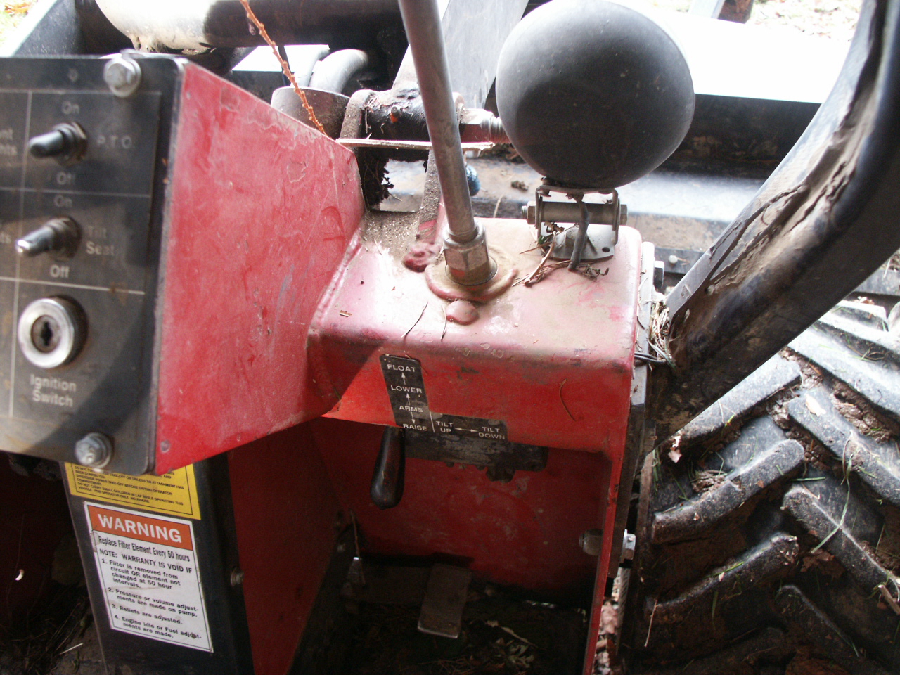

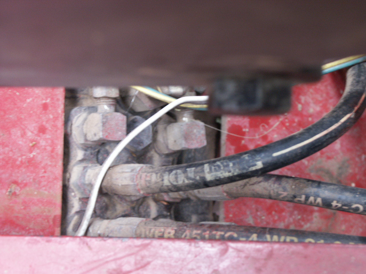

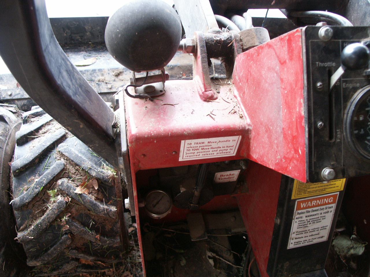

Hey JJ. Well... Help me out here a bit...
What I have on the PT is a valve block that is (I believe) a 3 valve open center. Valve 1 and 2 operate lift tilt and dump and are manipulated by the handle on the left. The 3rd circuit is for the Quick attach lock, that can also be uncoupled to operate various hydraulic implements (for me it is the grapple which I use extensively and the backhoe for the moment).
I do not know who manufactures the valve block. PT is notorious for removing part numbers.
My idea was to tie into this valve block (can I, you scared me with your idea) and run a line to this new control on the left side of the PT and then run the return back to the existing valve block or wherever it dumps to.
I am sure I am making this way to simple and the process is much more complicated than I have imagined. Typical of me.... Oh here are some pix...
The first two are of the valve body, the third is of the control, and the 4th is the general area of the proposed new control... May have to weld a plate on.

Not quite. Actually not at all! OC and CC has to do with the "center" of the valve-where the fluid from the pump flows when the valve is in neutral.
Both OC and CC valves can/will leave the cylinders in postion when the handle is in neutral. The proper valve we usually need for our machine is actually called a "tandem center" valve, but the Surplus Center uses this interchangeably with "Open Center". In most of the industry "Open Center" means the work ports are open to the center like a motor spool valve. In "Tandem Center" valves the work ports are block so the cylinder stays put.

That setup is very similar to mine. It is a manual circuit, and you are probably using it with the grapple. I don't have the manual, or never looked at mine to see if it had PB. If it did, it would be simple to add an electric valve. Seems like I posted awhile back about getting a new joystick with PB, and using the old one on the left side.

Carl, In order to operate the PT and keep the left hand on the steering, and the other hand on the joystick valve, the best way to operate a grapple circuit is with a solenoid valve to swatch circuits between the QA cylinder, and the grapple circuit. To use the grapple as you have it now, you must remove your hand off the joystick and reach under the dash and operate the QA/grapple circuit, or move the QA lever with the left hand. The most convenient way to do what you want to do is to install a new joystick valve with PB, and a solenoid hyd valve to operate the grapple. If you need to feather a valve, and want 12 v activation, then you need a proportional valve, but they ain't cheap.
If I were to upgrade the valves on my PT, I would do as above, and use a joystick valve with PB, and a solenoid valve to operate the grapple, with a needle valve in-line to adj flow..
Keep in mind that the lift, tilt, grapple circuit is downstream of the steering valve, and uses the fluid flow that the steering cyl are not using.
If you were to add a small hyd pump, fan-belt driven, and a small log splitter valve for the grapple circuit, that would give you another independent hyd circuit.
All the hyd on the front of my PT-1445, uses a pump like this mounted like I said, and does a fine job with the hydraulics. The pump only pumps about 3 GPM.
PB, Power Beyond allows you to add valves downstream of the first valve. Which ever valve is activated, the valves downstream will get nothing, or the remainder of the fluid the operating valve is not using. Each valve with PB must return cyl/motor fluid out the tank port.
