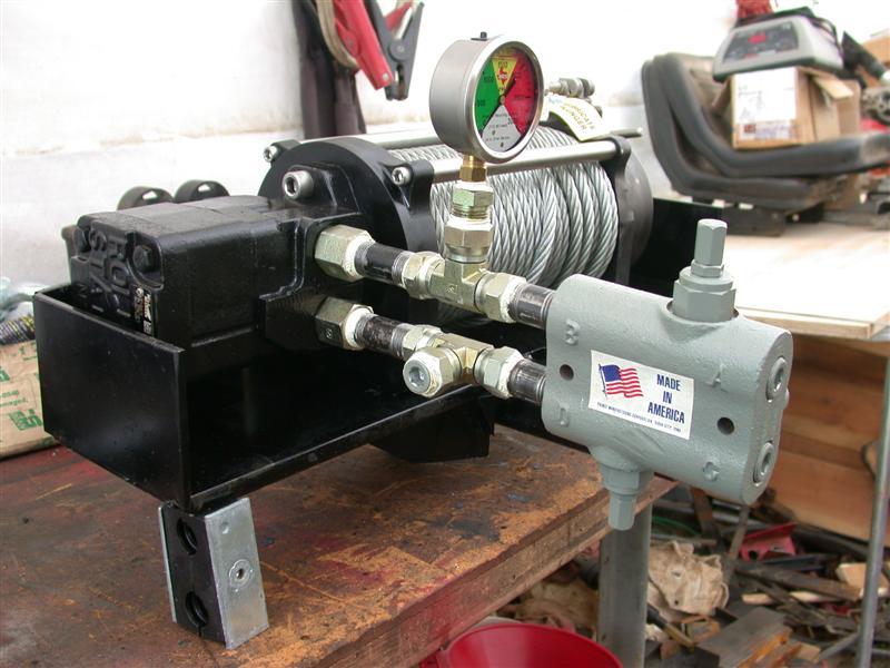

Carl, if you already using the 90 in mower, then the solenoid must be a motor spool valve, but you can always add a valve like the below valve, across the motor, to protect it even more. Any shock, or QD separation, stump, etc, the fluid will bypass to the input of the motor. This is a double cushion/relief valve in case you might want to run the motor in reverse, as in post hole digging. The link is a double valve, and one picture is a single valve, and the other one is a double valve.

A motor spool valve has its special feature in neutral position. If we go back to a regular spool for a double acting actuator (cylinder), that spool keeps both work ports closed in neutral. The actuator can not move when valve is in neutral. Many hydraulic motor applications require the motor to be "unlocked" when control valve is in neutral. A hydraulic wire winch is an example, it will need a spool for bi directional motor control, but with valve in neutral, we might want to be able to pull out the wire by hand, or roll it back on to the drum by hand. Then the motor have to be "unlocked" in neutral. That is made by using a "motor spool" in the valve. With a one directional motor this can be solved with a check valve between the two work ports.
Such check valve is also used to let a motor, with inertia on the shaft, slow down by it self when control valve, suddenly, is in put into neutral. Other wise this rotating inertia will create a "pressure pump" of the motor, and oil wont have any where to go. An example could be a large diameter, heavy mass, circular saw.

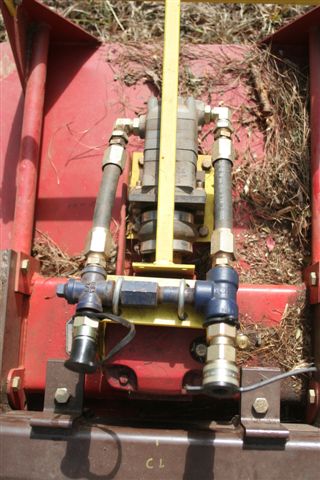

Wow guys, again, eternally grateful for the education..
JJ, look at the photo of the top of my PT where the control arm comes up. The lift arms are welded in the same area, so I am not sure if cutting that area open would be a wise idea. Your thoughts?
Carl,
First, try and determine if your valve has PB. The lift arms on your machine and mine are similar. As far as you have enough space to fit the valve, I would call Baileynet and ask them for dimensions on the valve. That is a six station setup, which should satisfy any future needs.
I have two of these valves that are PB capable, and they are small. might be enough room for both to go in the same spot as the three gang valve, or remove the three section valve, fill in the hole, and bore new holes for the two new valves. Will control four cylinders
