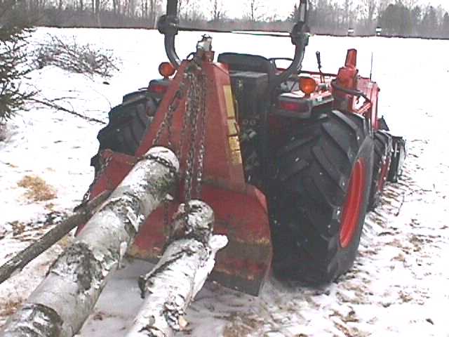

   / Valve stem guards... #25
Thomas, this is what the tractor gets used for most of the time. The winch is my de-fault implment. Stick's are very hard on HST filters!
Rich

   / Valve stem guards... #26
Harv, RE. high speed woble on wheels. Well there was one time I wsa skiding out a load of birds eye maple and they was big log's, must'a ben 5 or 6 stick's about 40" on the but end and the poor old tractor was just a whining when I look back here come's a old sow black bear coming up fast and she was mad, must'a woke her up. Well I drop them log's and threw the HST into high range and took off down the trail like I was on fire, when I felt this woble in the front end. I look at the tac. and had the rpm's up around 7000 and was just about to turn on the propan injection when.....................................
