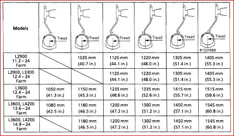

They got to the inside from adjusting the rim to center hub spacing.
Yo keep the spacing that you have now the tires would likely have to be broken down and swapped around on the wheels.
When it came from the factory it was likely set at the narrowest spacing, when the track was widened the wheels got swapped side to side,
To get the spacing I needed for tire chains I ended up swaping the wheels side to side which put the valve stems on the inside.

They likely flipped the tires for a wider stance. On hills prolly good flatish land not needed. I have hills and run a rotary mower but I need a narrow stance for tilling rows for our very large garden. overall rear tire width makes a difference when tilling rows. I prefer a narrow stance to wider.
Same with pushing snow - tractor width needs to be less than the width of the pusher.
Curious how much wider stance you get just by flipping wheels.
   / Valve Stems on my New Tractor #23
It all depends on the make and model of the tractor.

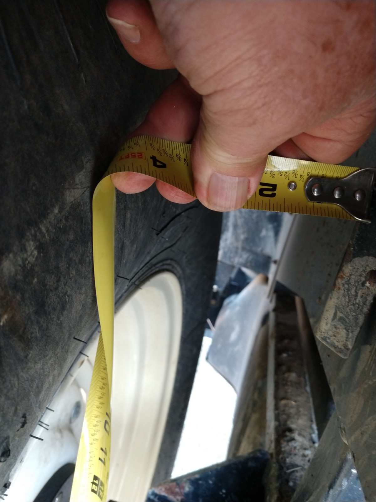

It all depends on your tractor and the type of wheels, one piece or two piece.
On my Branson with the 2 piece wheels the closest position set the tires about a half inch from the inner fenders,
that was with the outer wheel on the inside of the center. Originally the dealer moved them to the outside of the center
which moved them out about 2 inches.
This was just a bit too close when running chains they would tick just a bit.
About 2 1/2" clearance from the sidewall to the inner fender,

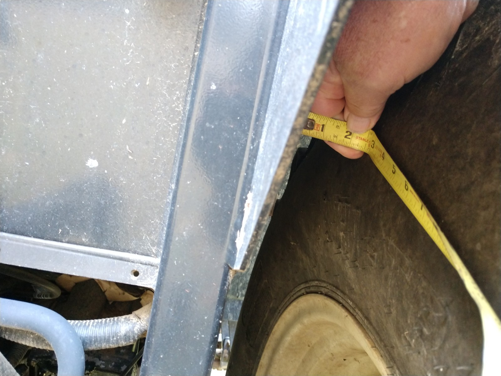

After flipping the rims and remounting them to the inside of the center, about 4 1/2" clearance to the inner fender.
And if I move them to the outer side of the center I would gain another 2 - 2 1/2"
So I moved the track out about 4".
With the 2 piece wheels there are 4 different even spacing available.
I much rather prefer the bar axles over the flange type. The bar type are much more adjustable.
With less work if they have been used and lubricated over the years.

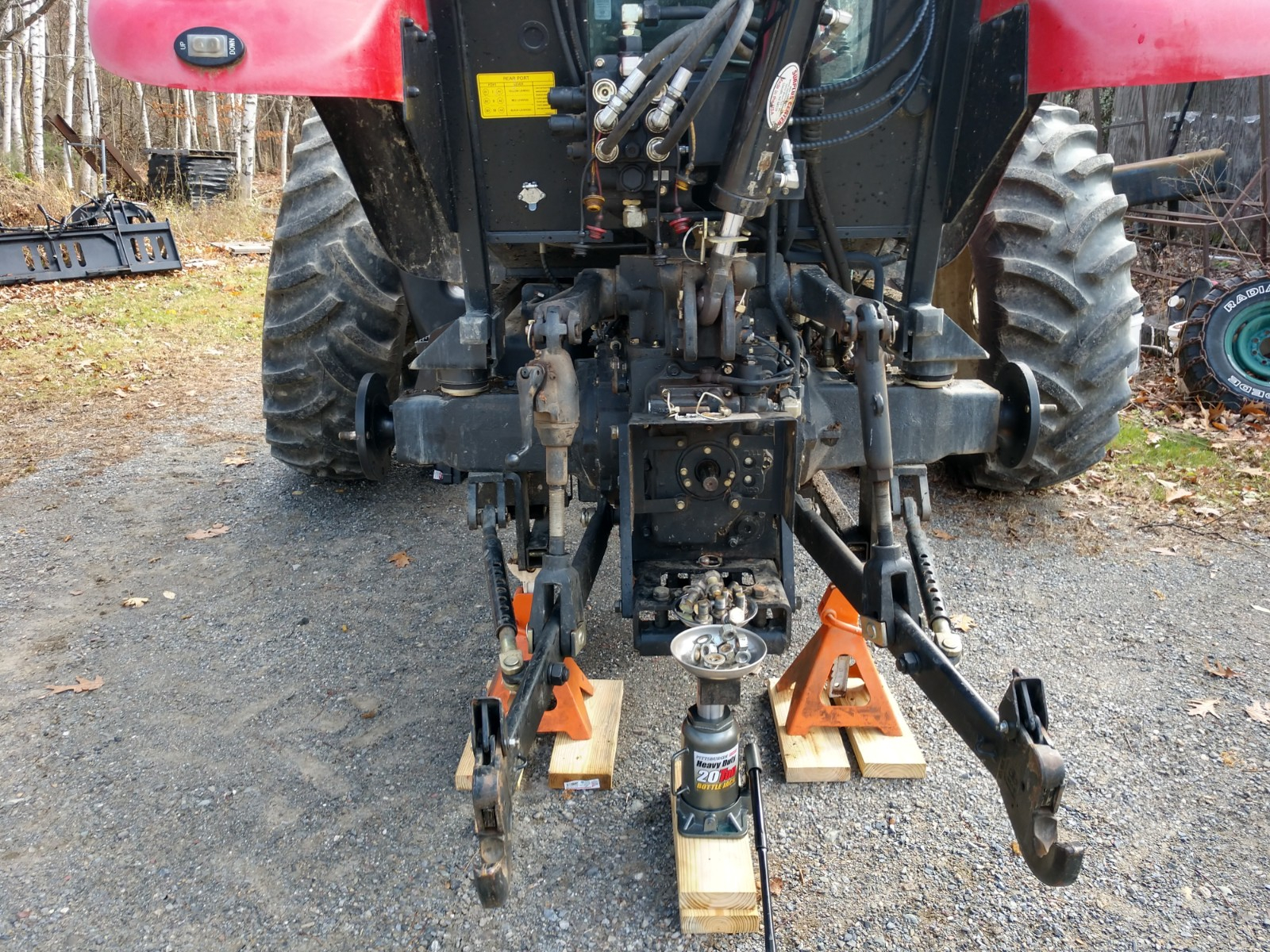

The rear of the tractor sure looks different with both tires off,
before widening
in progress,
I guess I didn't get a rear view when I finished the work. It did take awhile as I had to remove and reinstall the 4, 300 pound wheel weights.
Should be in the book. The OMM of my CUT showed the 4 different tread widths that could be obtained by different wheel orientations. Its wheels had scalloped mountings so a person could support, remove the bolts, rotate the tire 90 degrees to a new position where it changed tread width 4". Swap sides and there were an additional 2 tread widths.
