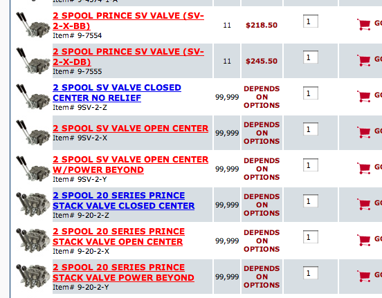

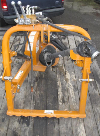

Hi,
I have a Kubota B2920 TLB I want to run a 3pt stump grinder like this picture I found. Since I have a factory backhoe (Kubota BH65) I thought I could use the hydraulic supply lines that feed it into a proper valve as shown in photo. The dealer said I need to install kit with ports and valves mounted on to tractor, awkwardly IMO, when I put backhoe back on. The amount of quantity of items they listed, I felt, was just too much. I said why can't you mount controls on the attachment...was told they have to do it by the book anything else and I'm on my own.
Anyway, I think this idea should work. With using the hydraulic lines that feed the BH when I remove it why couldn't I use that flow source? If that possible?
I'm not sure about type of valve (dual double action) on this set-up open center, open center with power beyond and PRV (which is my guess?) or closed center.
Any info/feedback appreciated

Yes, you can certainly add a valve to the grinder and use the PB (power beyond) lines to feed it just like your backhoe does.
You will need a OC (open center) valve, two spools for DA cylinders. You can use the stack valve like you pictured or one like the 9-7862 which is cheaper.

Yes, the line that feed the hoe are PB lines-you have to couple them together when you remove the hoe correct? They have the full flow of the pump in them whenever the tractor is running. When you hook it up this way-it becomes the last valve in the series so it (the new valve) does not need to have a PB port on it-just like your hoe valve does not have one.
You want a valve that is rated for equal or greater GPM capacity of your system-NEVER smaller.

Yes-correct. Most valves have PRV's (pressure relief valves) in them, the one I linked is adjustable from 2000 to 3500 PSI.
