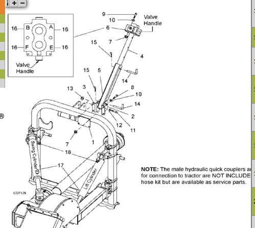

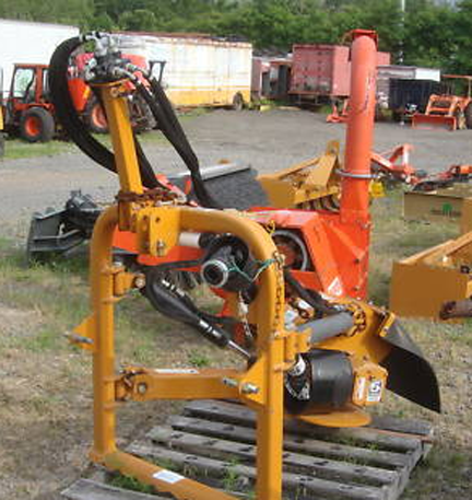

Kennyd,
I appreciate you suggesting more efficient/economical way to go. I found a schematic and a couple of photos of a unit with factory hoses...the 9/16" listed earlier in this thread definitely look like overkill (as well as valve body) and I did not know if the cylinder size came into play, but if each hose (schematic showed) has a restrictor that does seem to suggest hoses, as you said, did not have to be that large?
From the schematic and photo it looks like the factory valve is a joystick. So with the valve you suggested from surplus supply I would add a needle valve to each hose feeding each cylinder?
I'm just concerned that Wood's may have done something proprietary on set-up...but I'm feeling pretty confident from all of your info. From schematics/photo anything look out of ordinary to you?
I also found at Messick's parts I can order the factory arm and attachment plate as shown in the photo for valve body etc. without all the other components.

/ valve type question #16
I can assure you there is nothing propietary about the hydraulics on that machine. Just a valve, hoses and cylinders.
You only need a restrictor on one side of the cylinder, not both because either way the fluid is forced through the small opening in it causing it to move slower.
If you want to use a joystick valve, then the 9-7401 is a good choice, but more money. I guess it will come down to how much you are going to use this thing if it's worth the convienience of the joystick vs. two levers.

Kennyd,
Info all noted.
No, I don't need a joystick valve on this.
When I looked at schematic again I realized that each of two cylinders had a restricted hose fitting which led to my question about the needle valve(s). What I meant was not a restrictor on both sides of a cylinder but rather a restrictor to each of two cylinders as follows:
to restrict the flow to each working cylinder with a two lever valve do I need a needle valve on line to each cylinder or does the "open center" of two lever valve mean you only need one? Likewise if using a joystick valve with open center would there be any difference of needle valve set-up?

Alright...You are sure getting your money's worth outa me:laughing:
You would need one restrictor/needle valve per cylinder ( or "circuit"), doesn't matter if the valve is lever operated or joystick operated
Being Open Center has no bearing on this, that only has to do with the IN and OUT ports and the type of pump you have-you NEED Open Center BTW.
