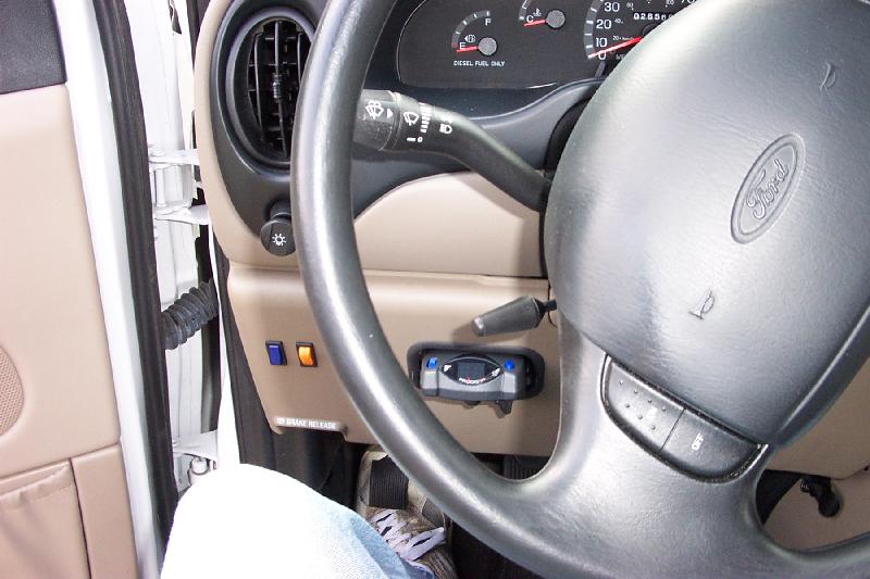

The E350 makes a great tow vehicle. The only real problem is finding a place to mount that brake controller. I finally decided there was no easy place to mount it and hacked it into the lower dash panel (see attachment).
I’ve heard lots of good stuff about the BrakeSmart but it came out after I already installed a Prodigy. After a couple years using the Prodigy I find it gets the job done.
One thing to consider about a 7K/10K trailer is its weight. The heavier trailer reduces your actual carrying capacity. This could be significant if you’re limited to 7K and play it strictly by the book.
With my van I installed a transmission temperature gauge. I’ve found it not necessary to install any extra transmission cooling. However, one must be careful backing a heavy trailer up an incline. They can overheat quickly under the right conditions.
For my tractor I bought a 7K flatbed trailer. I’m now wishing I would have bought a 12K dump/equipment trailer instead.

<font class="small">Code:</font><hr /><pre> hacked it into the lower dash panel </pre><hr />
Nice HACK JOB.
