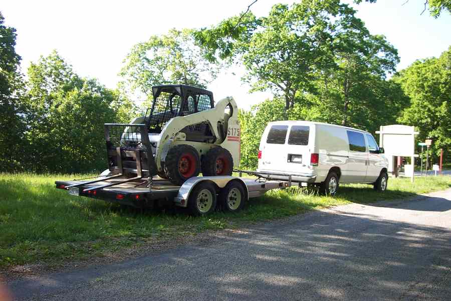

Just had to add a picture to this thread…
A neighbor needed to unload some equipment off a truck so I offered to fetch this from the rental yard for him.
Nice unit – I really liked the sound of that 46HP Kubota engine /forums/images/graemlins/grin.gif
